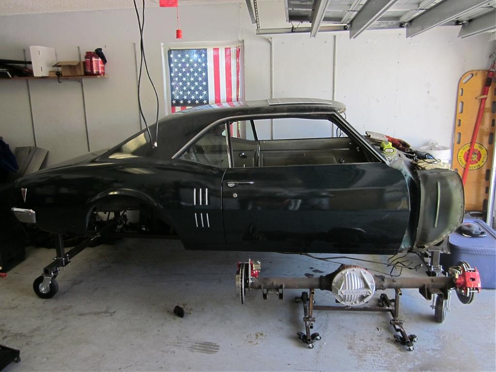

Looks great, Bob! can you do me a huge favor and post a side profile picture? i'd liked to see ride height and tire clearance. thanks!

Great looking Trans Am. The trans am flares look to be seamless. Is that just the pictures or did you have them molded in? I would appreciate it if you could show how you mounted the front splitter. I have planned on adding one to my TA after seeing it added to Alberts old car.
I agree, I would like to see more pictures and I would like to know the tire/wheel specs

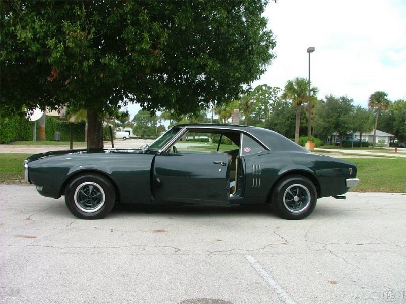

Ok attached is a side view.. rear fenders are
slightly flaired and a little lower, fronts I just
cut the lip and pulled them
Tires are 275s in the front on Simmons Racing wheels-17's
I have a set of Simmons for the rear but had the minilites
made with less offset to pull the tire in.. both are 17" with
315's... I think I could get 335s out back.. I have
Kumo V-710s and a set of Nittos for the 200 events
Headers- 3 1/2" collectors with 3" exhaust along with
the bellhousing are the low points.. I did raise the car
and now have about 2 1/2" clearance at the low points
Color was originally going to be black and at the last
minute I changed it.. was suppose to be Honda civic
color way back but he tweaked it slightly so don't really know
Cannot find my extra paint
Painter did mold both front and rear flairs and we put
rock protector on the rears but that did not last long
I put some pieces of carbon fiber on them..
