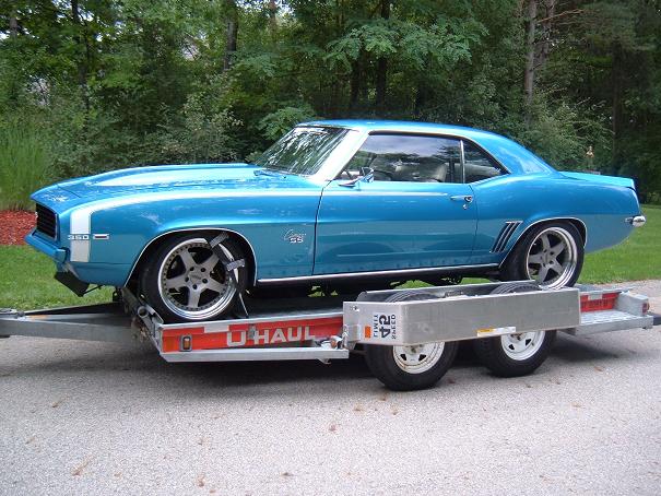

Yep, that's what my new car has. Purchased Tom Izzo's car a couple of weeks ago and it has 295/35/18's. There is no rubbing whatsover and the lowered stance looks great to me. Of course, it has nice pricey wheels with custom backspacing that nailed the positioning...that's one of the keys, IMO.
Here are a couple of pics so you can see the way the tire/wheel size would look.

4MMM - Nice looking car. Any chance you know the backspacing and width of your rear wheels? Thanks. -eric

No problem Eric, I just won't get to the car until the weekend after this one since my job has me tied down for a while. I will definitely keep you posted.
