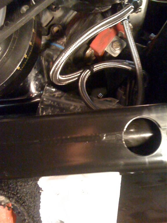

I had the same problem with DSE hoses -purchased Feb 2012. got a RMA/RGA# (return merch #) and exchanged it with without a hassle, the 2nd set has held up so far.
The leak started below the fitting and dripped onto the sub (left side on the pic) - had the plastic bag in place to try to zero in on location. Sorry for the poor cell pic.
