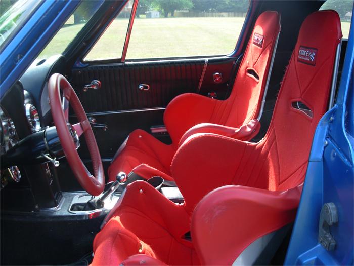

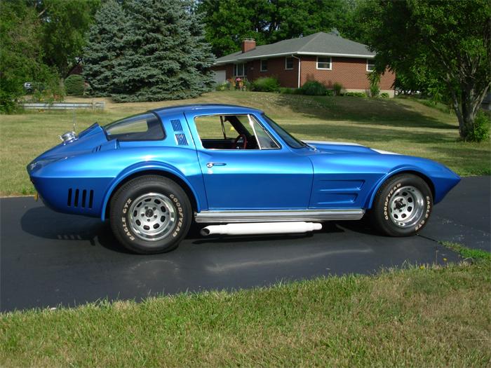

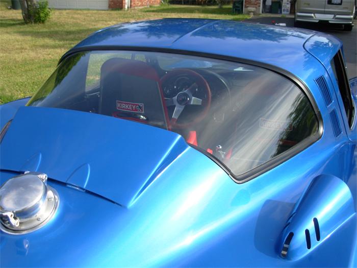

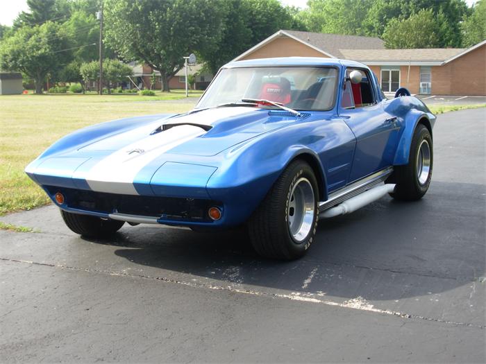

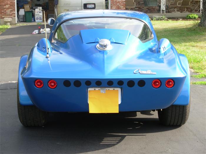

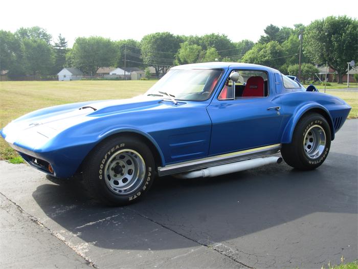

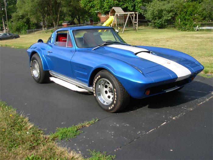

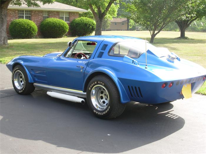

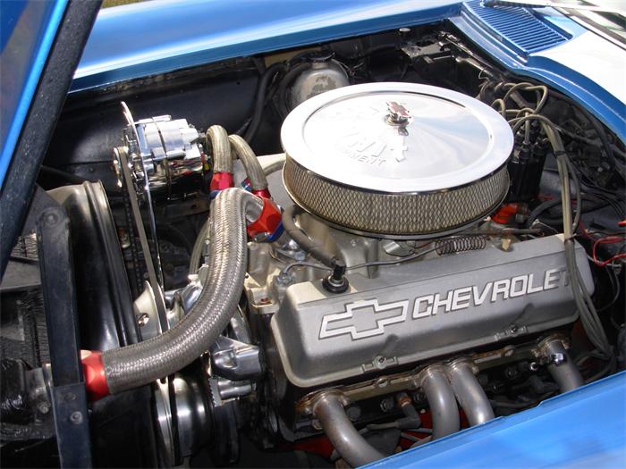

I was able to pick up a 64 Coupe that had been partially completed. The fella was needing some cash and he was located in a very small town in Ohio. I spoke with him on the phone, and had someone go out and look at it. He set a price to hard for me to pass up.
I saw my first one in 1979 and it was love at first sight. Ever since then it had been on my list of things to do before I kick the bucket.
Since he had used Mid-America Industries, Inc. to do the first part of the transformation, I figured it would be a decent idea to stay with the same vender.
He had done some of the cosmetic changes to it, but the headlight changes, hood, suspension, correct wheels, dash and differential cooling scoop etc. (was very early and/or not correct) I think this played a part in him not getting a good price for it.
It does have a nice 400 hp SBC 350 in it, Muncie 4 speed, and a 12 bolt GM Differential with 4.10:1 Ratio gearing and a posi-traction Carrier.
Here are a couple of pictures of the car when I got it.

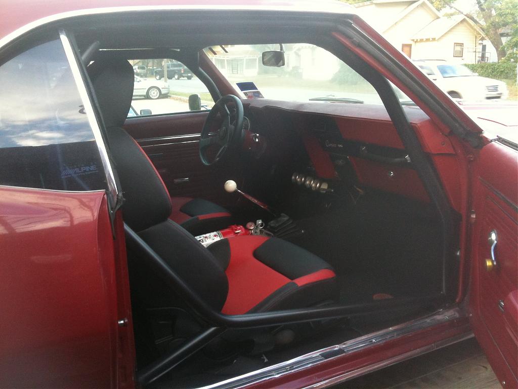

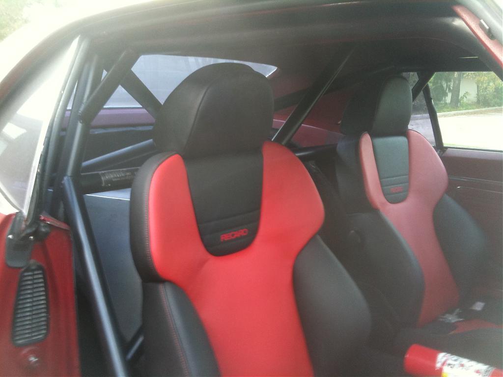

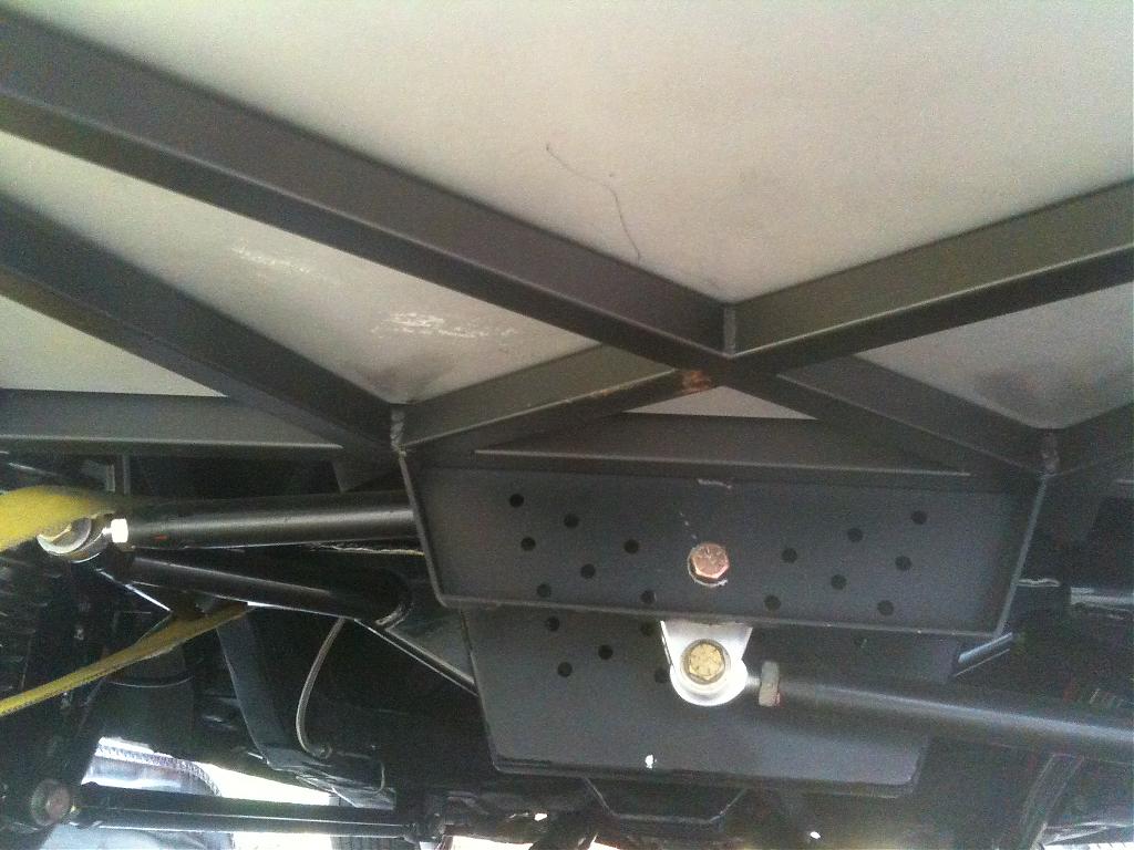

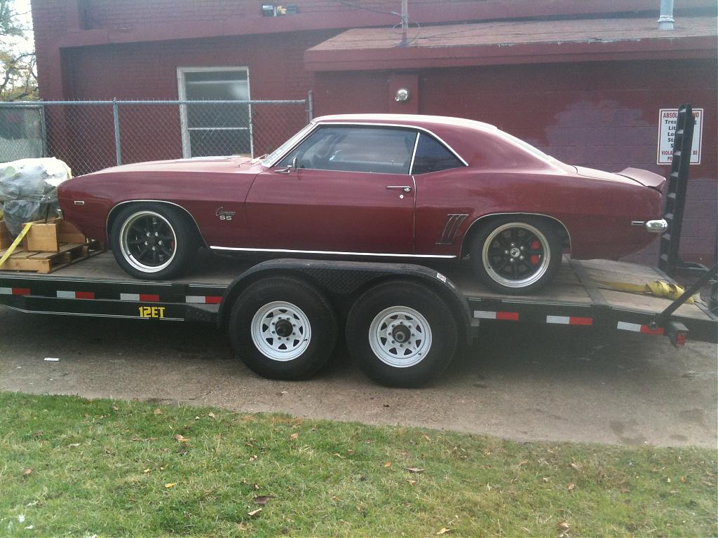

"She Devil" is awaiting some very crucial parts, however I have got the Cage in the car now and have had the three link modified for better performance. (Instead of saving the back seat as originally designed, I had the bar lengthened for better geometry as well as some adjustment changes.) With a good cage in it and some cross bracing, your back seat is effectively rendered useless. I think it has what it needs now. (Enough rear room for a couple suitcases, and a "Cool Suit" ice box. I found one on ebay for a decent price.
A shop that makes some very expensive race cars was used to do the rear suspension modification work. Since I was having rear weights jacks put in the car, I needed to step it up a notch from the average builder. I like how it is now as you can adjust how the rear sits, and adjust the weight balance very easy and quickly.
The cage that was installed is not only for safety it is also extremely rigid now. There is a lot of cross bracing designed into it on several different planes. Sound confusing? I'll try and get some pictures to help explain what was done. (My description might be in error so some pictures will help)

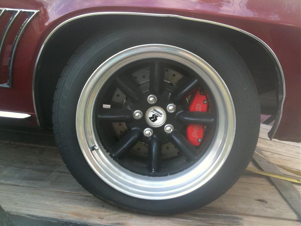

Until then here are a couple more pictures I have of the car with the PS Engineering wheels on it, and it shows a bit of the cage.
Enjoy.
