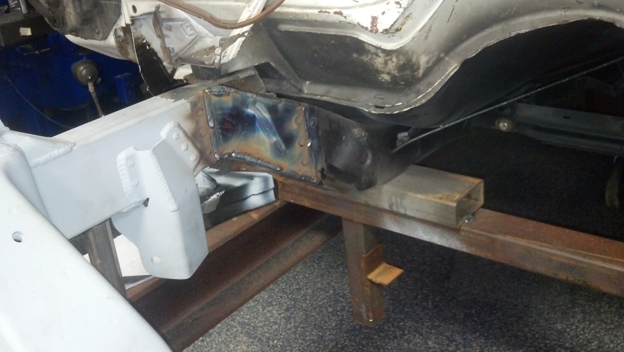

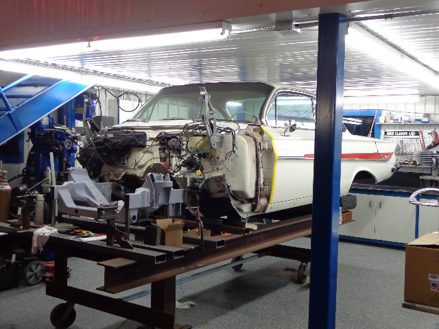

This is a 61 impala that is getting a Detroit Speed X-Gen 595 front clip. For the rear it is getting a 9 inch and sticking with the stock style 3 link rear suspension. The lower links will be getting custom built with an adjustable upper link. The brakes will be from Kore 3. The 348 tri power and 4 speed will be going back in the the car. Wheels on the car will be Grip Equipped Rodsters. There will be more pictures at the beginning of the week.

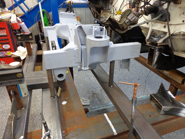

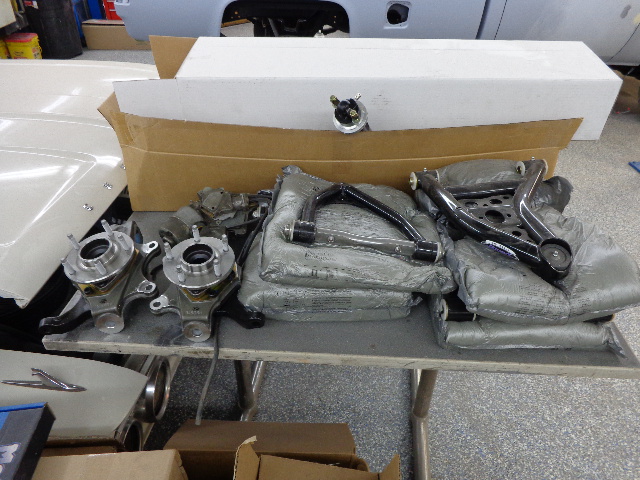

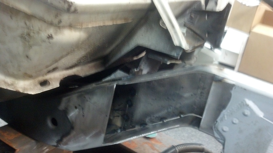

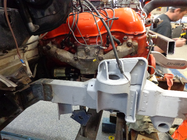

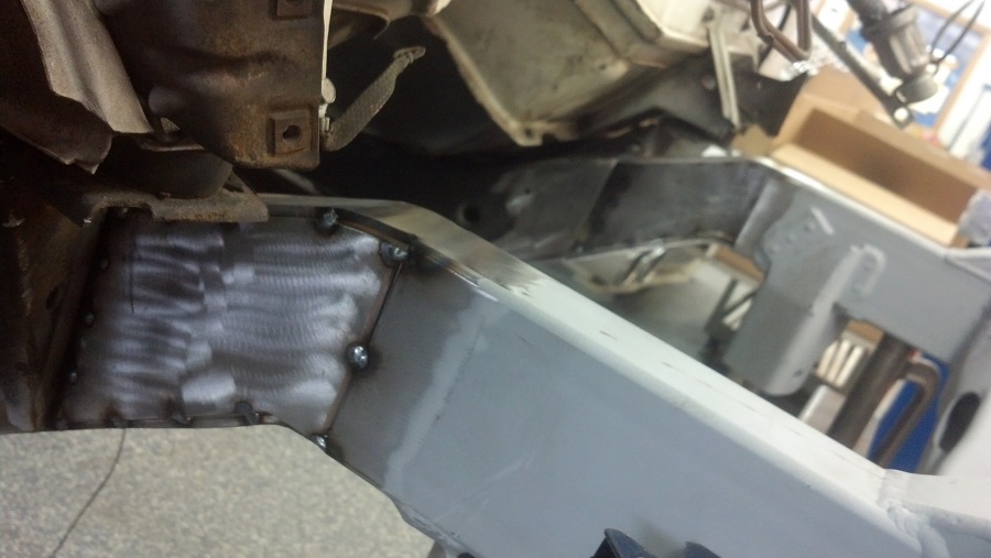

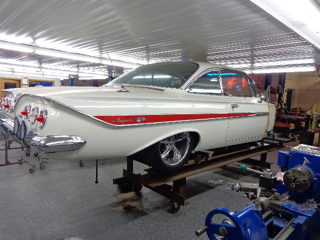

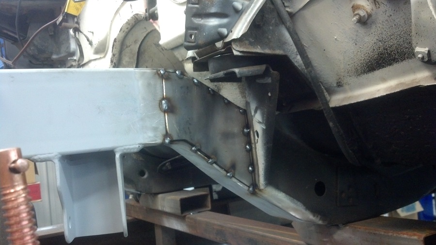

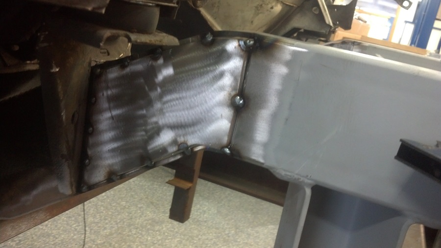

Here are some more pictures of the whole car and what we have done so far. The outside of the car will be untouched.

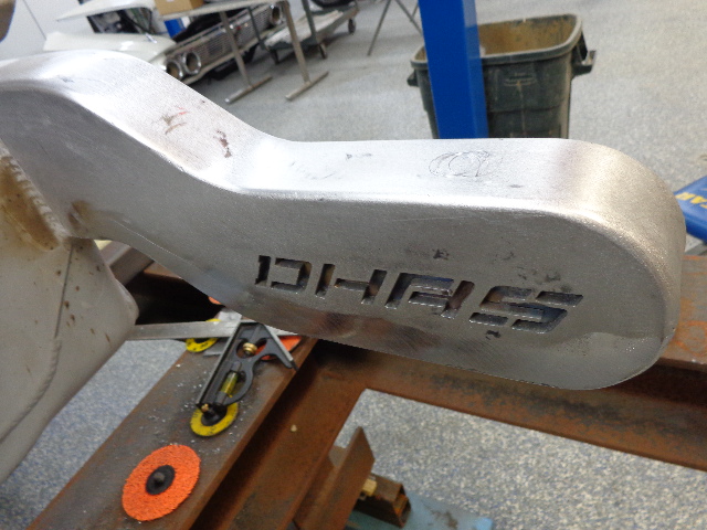

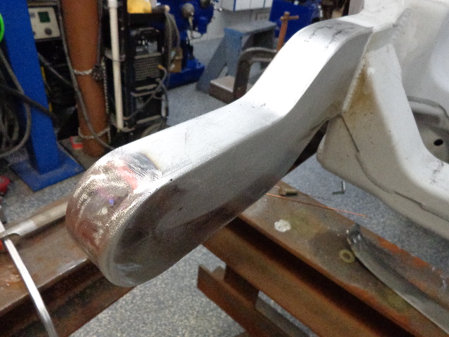

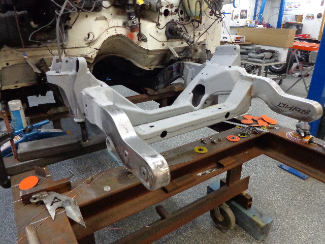

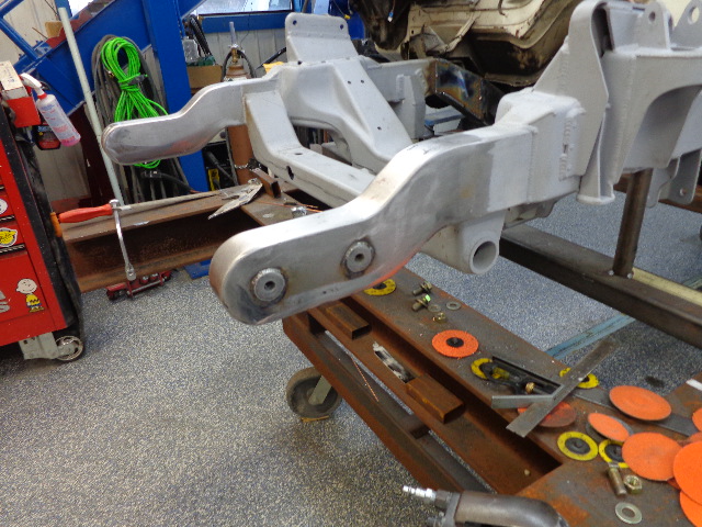

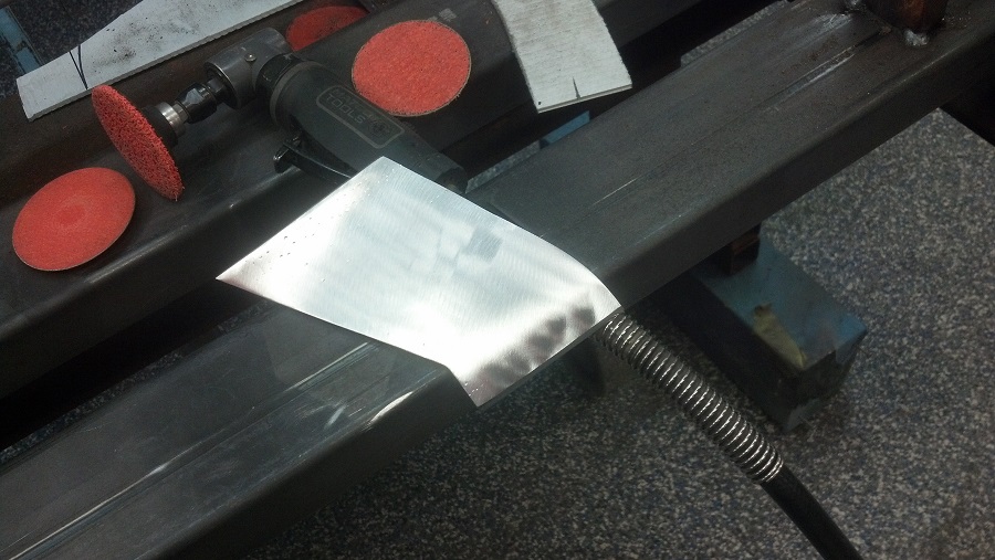

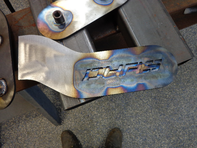

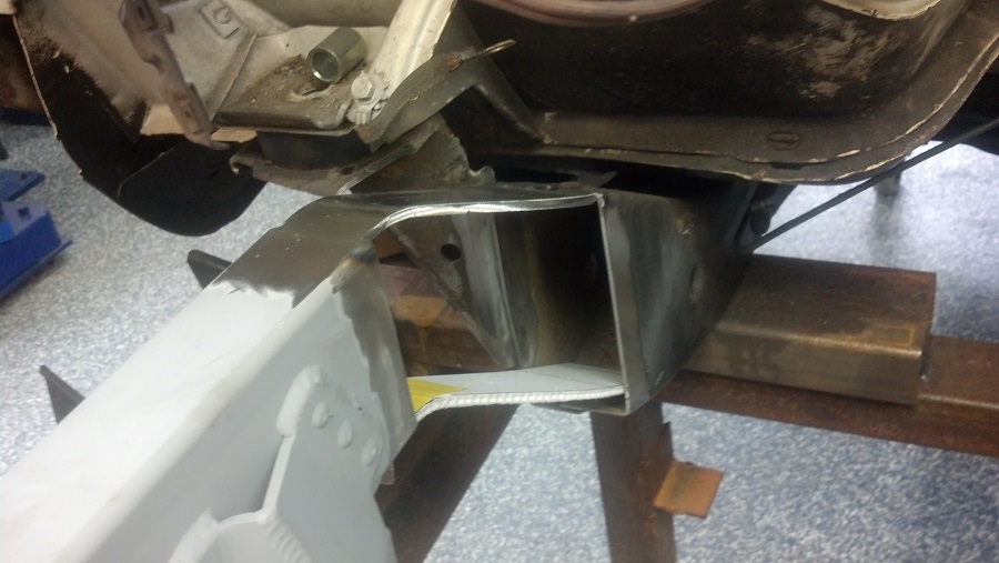

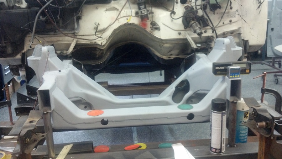

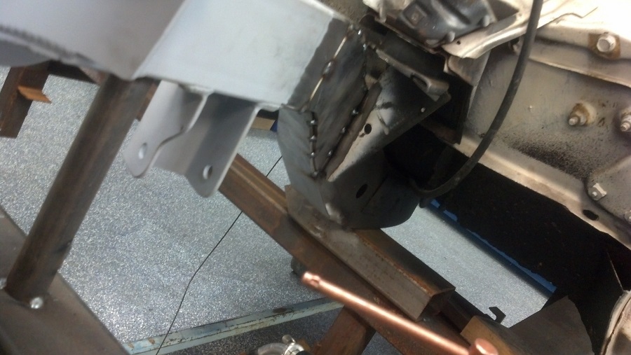

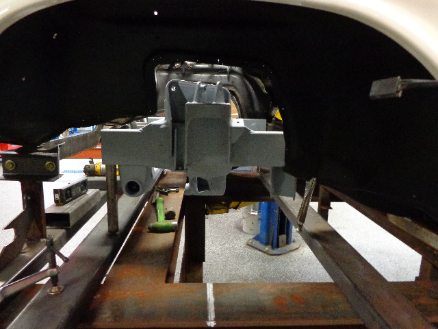

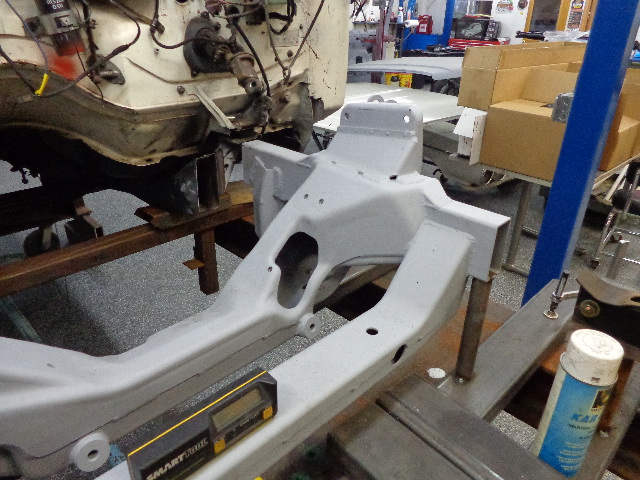

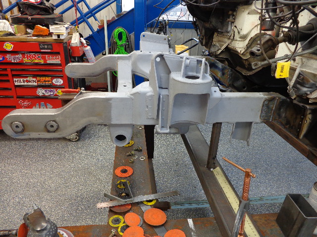

some updates
