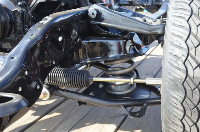

In December 2012, we had the frame completed with the major changes and took it to a local car show and got a bunch of good feedback. Here are some shots from the show of the front suspension:
