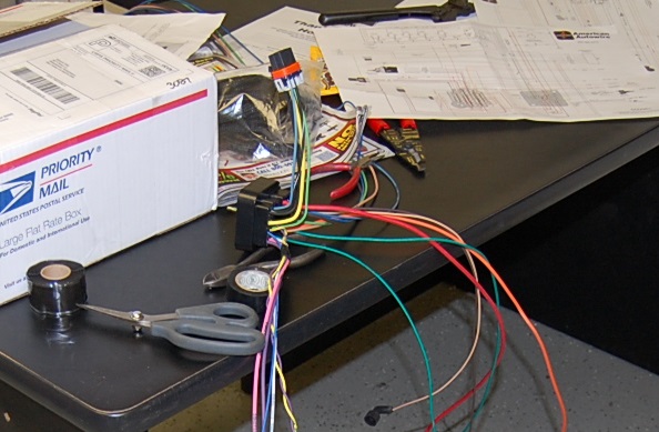

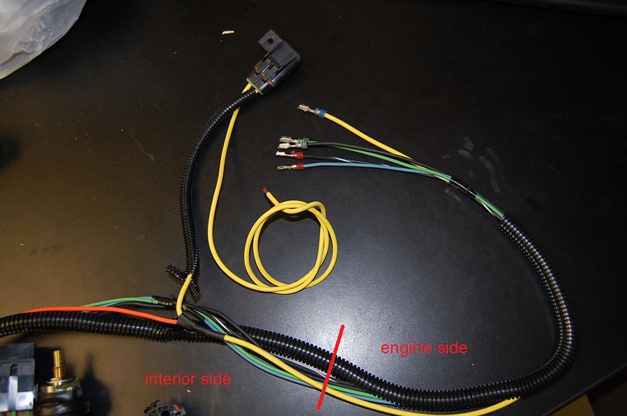

The first step would be to find out how much length you need to reach the wiper connector.
Cut the DSE harness to the appropriate length.
One side will be on the engine side of the bulk head the other will be on the interior side. Using the extra blade and slot connectors supplied in the AAW kit they plug right in..

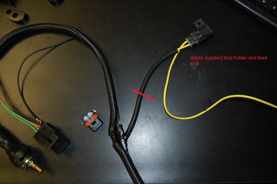

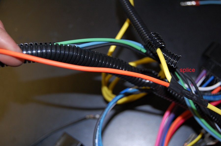

Next is to remove the DSE suppled fuse holder and wire. I cut it a few inches from the splice. yellow to the motor, yellow to the power feed and orange to the relay.
The section that remains from the yellow DSE harness will splice into the fused AAW wiper circuit.
Trace the fuse, flipped over, one side of the fuse circuit will be a 10 gauge pink ignition feed and the other will be the wiper supply. Splice or hook up to the wiper supply pin.

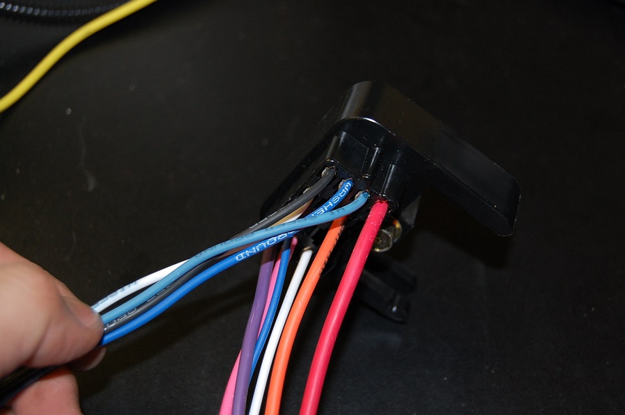

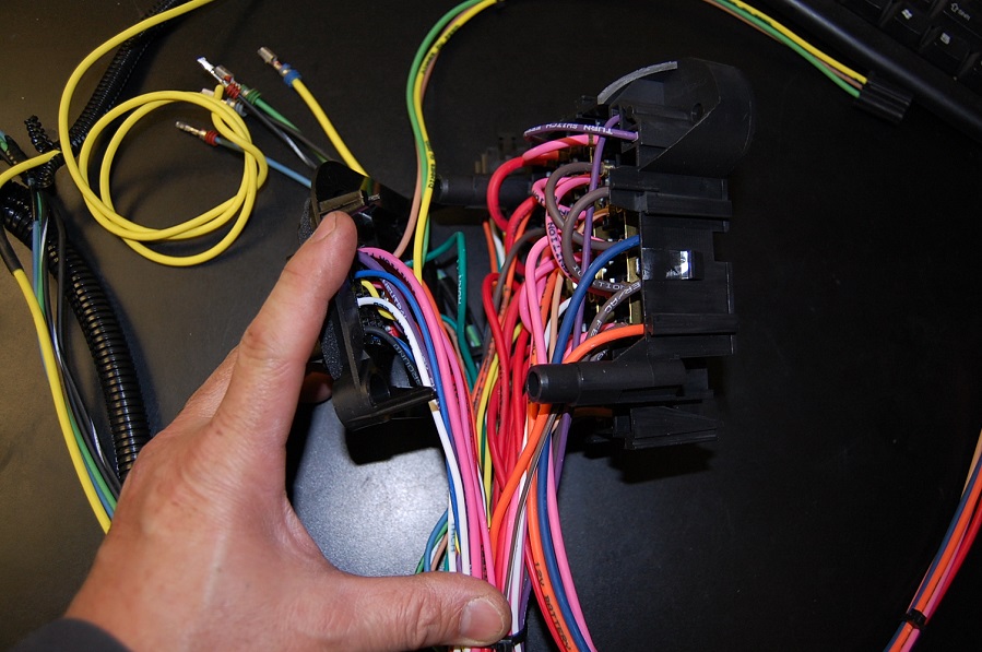

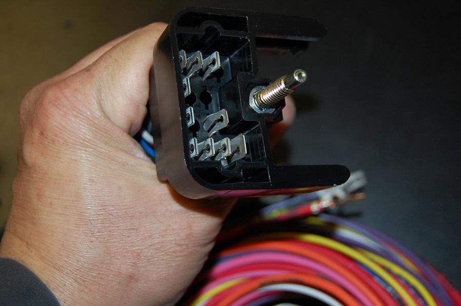

Next locate the AAW wire feeds to the factory wiper motor body side and engine side. Remove all pins by squeezing the gap tang on the blade connector (engine side) and inserting a scrib or appropriate pin removal too for the male end (body side).
You do not have to keep track of these wire because when you install the DSE harness you determine placement. Do one color at a time so you don't mix them up.
