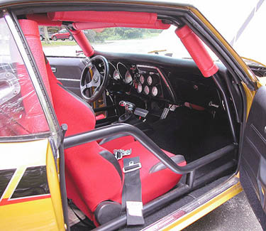

I just droped my nova off at a fab shop in Orange CA to get a roll cage installed. I could not decide on what I should do for the bars on the side of the doors. I brought it in to get a 6 point but changed it to a 4 point because I could not decide what I wanted. What are you guys running for door bars? The fabricator said that he dosent like pin in bars because if they fail durring an acident they would swing around and do alot of damage to you. He wants to put in the normal cross bar that is popular with drag racing. Is their a style that is better for a road corse type car? Maybe like a low bar tyed to the floor or something. If I figure out what I want by WED I can have it added in this sesion. I don't want it to be to hard to enter and exit the car because I plan on driving it alot. Any sugestions or pictures woud help out alot. Thanks.

I like the one Steve Chryssos has:

Thats funny. I was just looking at pictures of his cage about 5 seconds before I saw your reply. I like his cage alot. The only thing is I am not running the halo bar and the front down bars. I don't know if it would work without them. I am a little scared of having bars that close to my head in a colision. If it was a track car only where I would always have a helmet I would defenetly do it similar to his. Tom your car is turning out great. I love the color with the racing stripes. Looks like you had a really good painter.

It's not that hard to get used to getting into a car with door bars. A side impact can kill you so I would go back to a 6 pt. I have the basic side bar from the main hoop to the floor at the front of the door.

plus a 6-point adds a TON of chassis stifness..
I don't mind climbing over my door bars.. but they do make working on the interior a bit more of a pain.

I don't personally own a car that has a cage, but have ridden in several that do. They aren't too bad. You get used to getting in and out and learn a way that makes it much less of a hassle. Is there a way to bend the bar? To not have it go straight from the main hoop to the floor. possibly follow the seatback a little toward the floor and then bring it to the floor? Not sure if that would work withouth the halo. Also, like Steve said, if you plan on seeing some corner carving track time, it would help to stiffen things up
