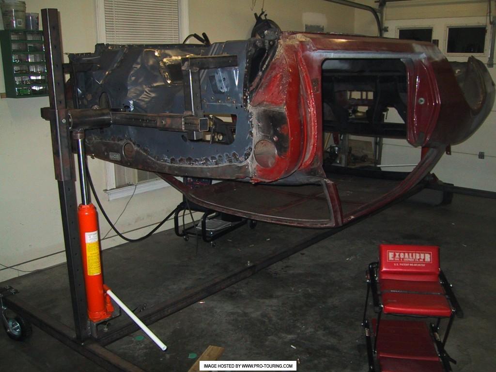

I built a rotisserie and finished all the welds and sandblasted the majority of the car. I then finished the bottom all the way up to high build primer.
It took me several years working on the car every now and then to get all the above done. I then got burned out on the car and it sat for a few years with very little progress made.

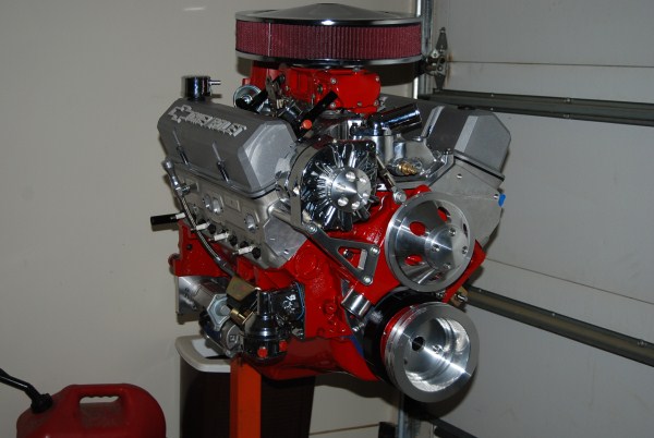

I had so many new SBC parts laying around that I scraped my LS1 build and put together a 450 horse SBC 350.

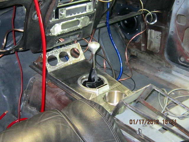

Custom center console modeled after the 67 original gauge console, but with an arm rest and cup holder

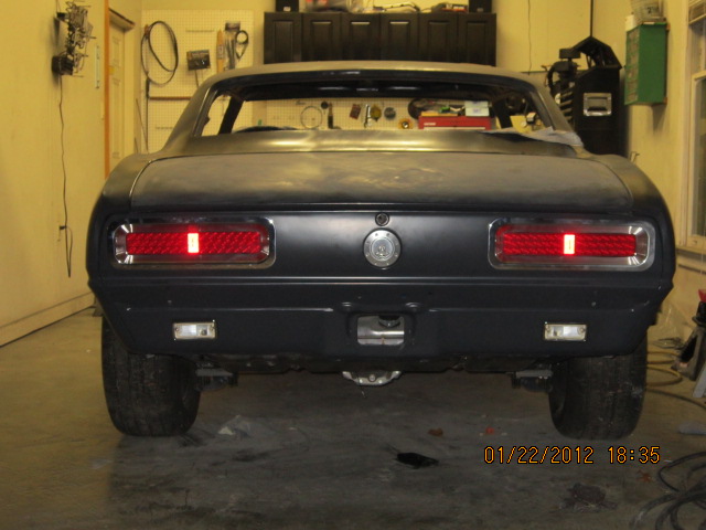

LED tail lights and 05 Grand Am LED center brake light. Will be inserted in rear spoiler

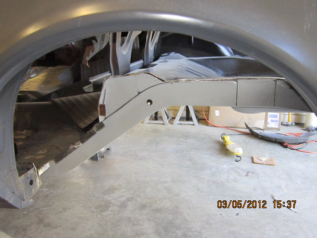

That is where the car is at the moment. I am, now, in the process of mini tubbing the car. To save a little coin, I'm going to just split the factory inner tubs and add metal to them.

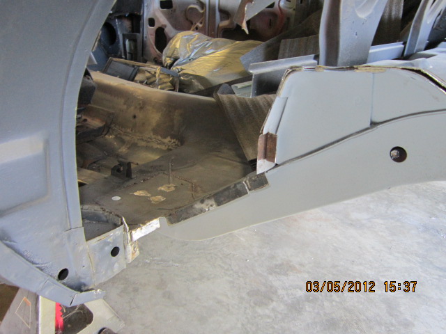

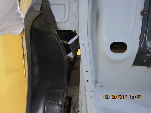

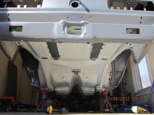

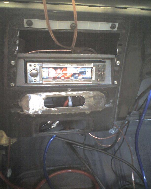

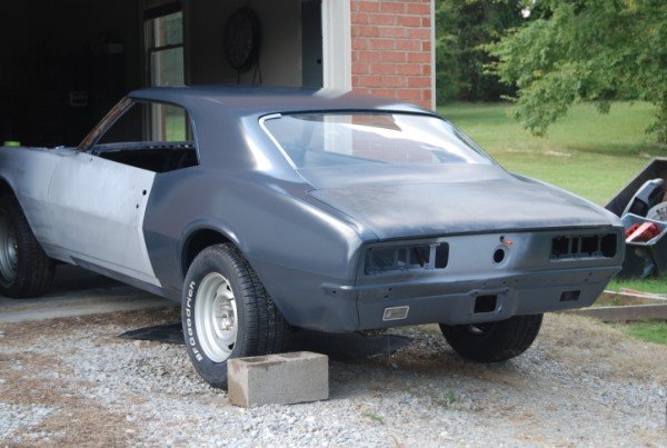

Few more photos of the car and where it is at the moment

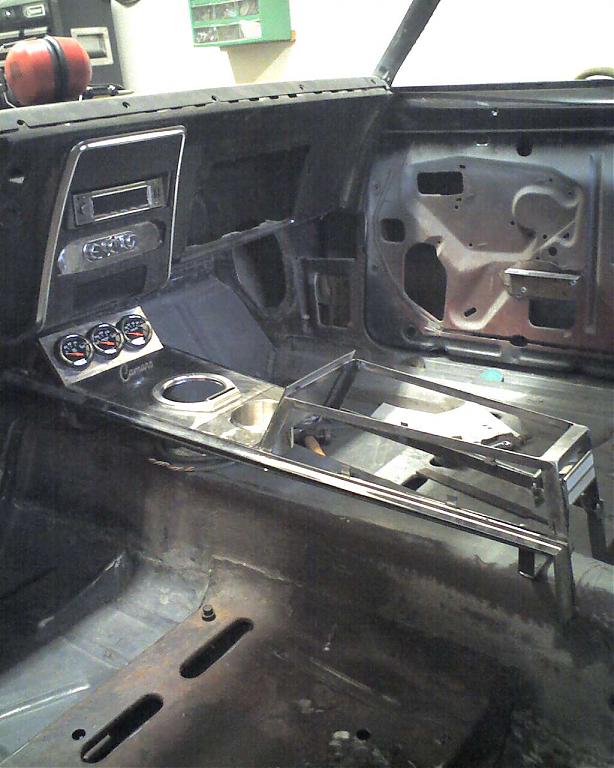

Looks good so far. I like that you have utilized the 67 console trim in your custom console. It's sad that most people, other than those on this forum, will never appreciate the amount of work that goes into the under-side of these cars. Keep up the great work.

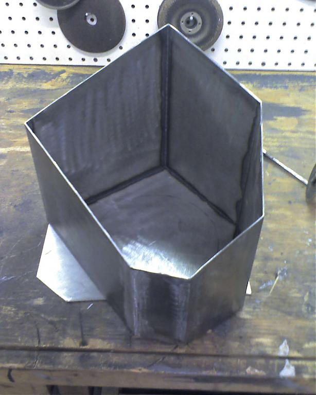

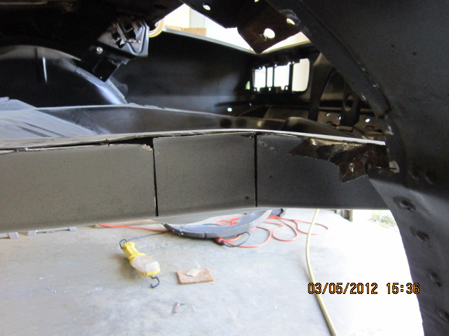

Am I doing this right?
Minitub...

job well done so far,motor looks great

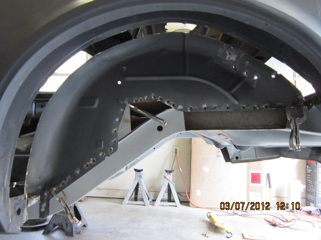

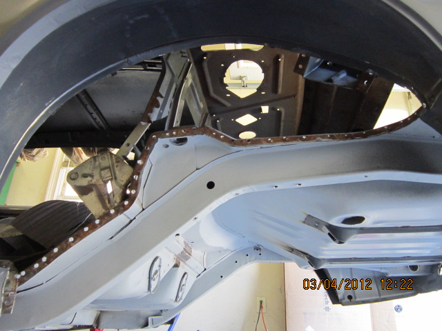

Small update...Progress is progress though
I also decided not to reuse my original inner tubs and modify them. I just bit the bullet and ordered a new set of DSE inner deep tubs. Less work involved
