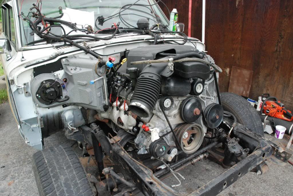

We have progress!!
The engine arrives!
Out with the old... (oh, it's for sale too!)
Air Conditioning mock up...
Behind the dash...
In with the new...
Clears the firewall nicely!
Notes: The JeepinPete (from the Full Size Jeep Forum) mounts were PERFECT! I mounted the engine 1" forward of the original forward holes. By doing this, the transfer case is within an inch of its original mounting, and thus the linkage fits with no issues. Also, no driveshaft work is needed! The Turbo 400 shifter linkage was spot on.

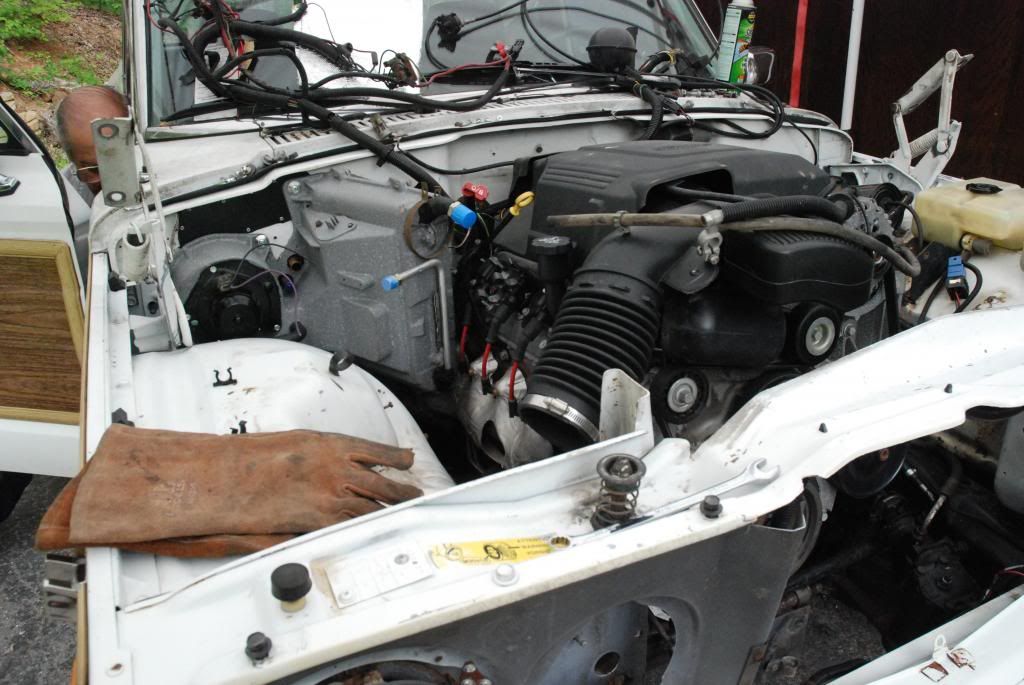

Of course, you guys understand that this isn't a "real" Pro-Touring vehicle. It will, however, be my daily driver, and as such, will be used for real "touring!'

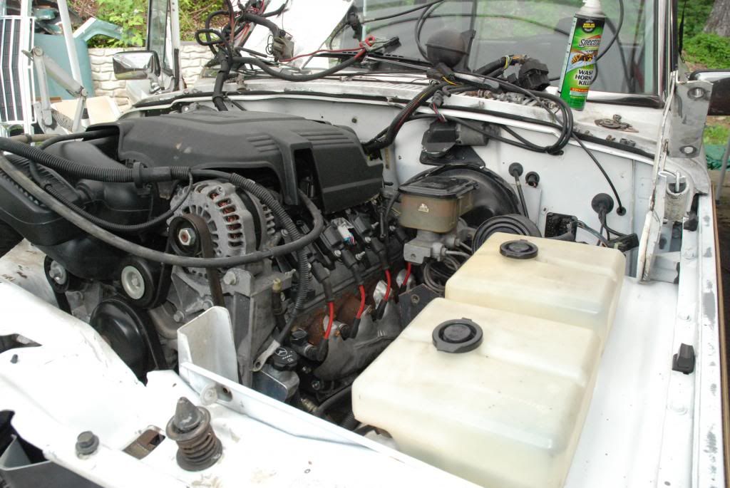

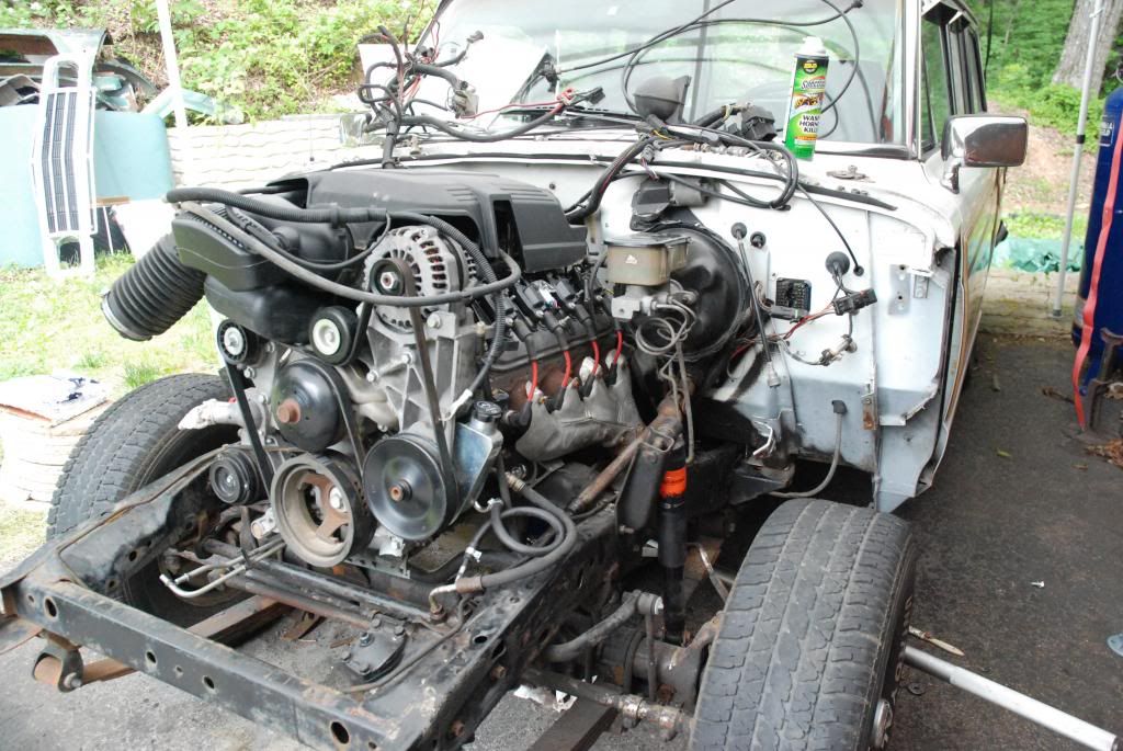

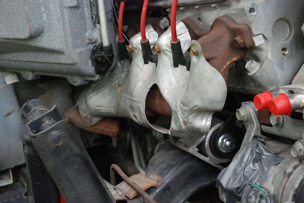

Anyway, it seems we have more progress!

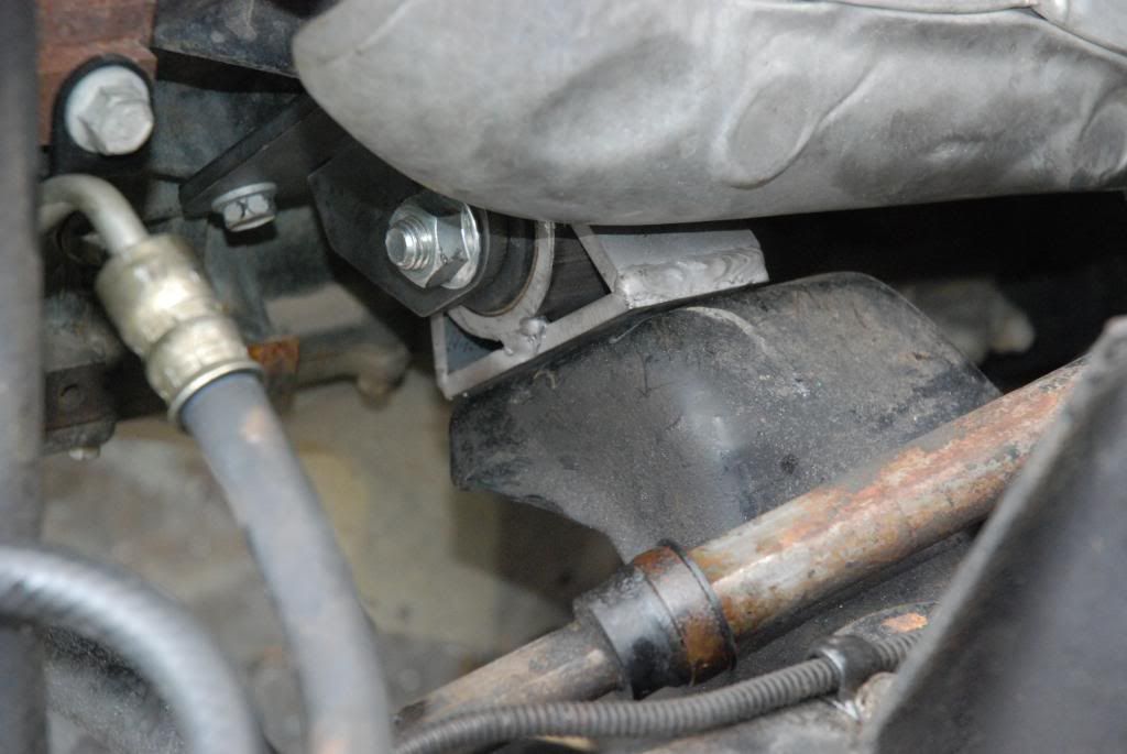

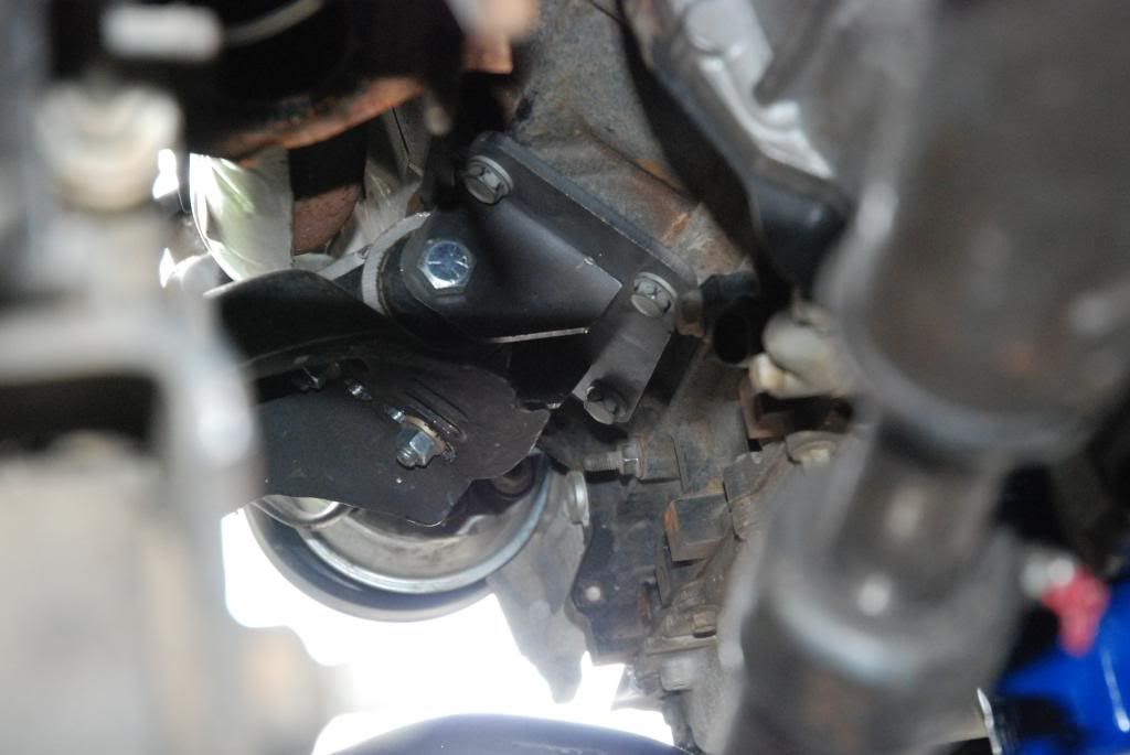

If you look carefully, you can see how I moved the engine forward by drilling new holes in the frame mounts.
And from the top...
Lot's of clearance underneath. The transfer case sits almost exactly where it did originally, though the rear crossmember is now in the rear mounting holes.

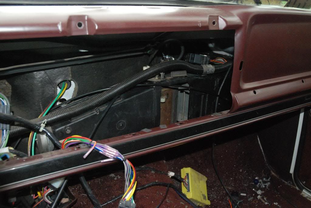

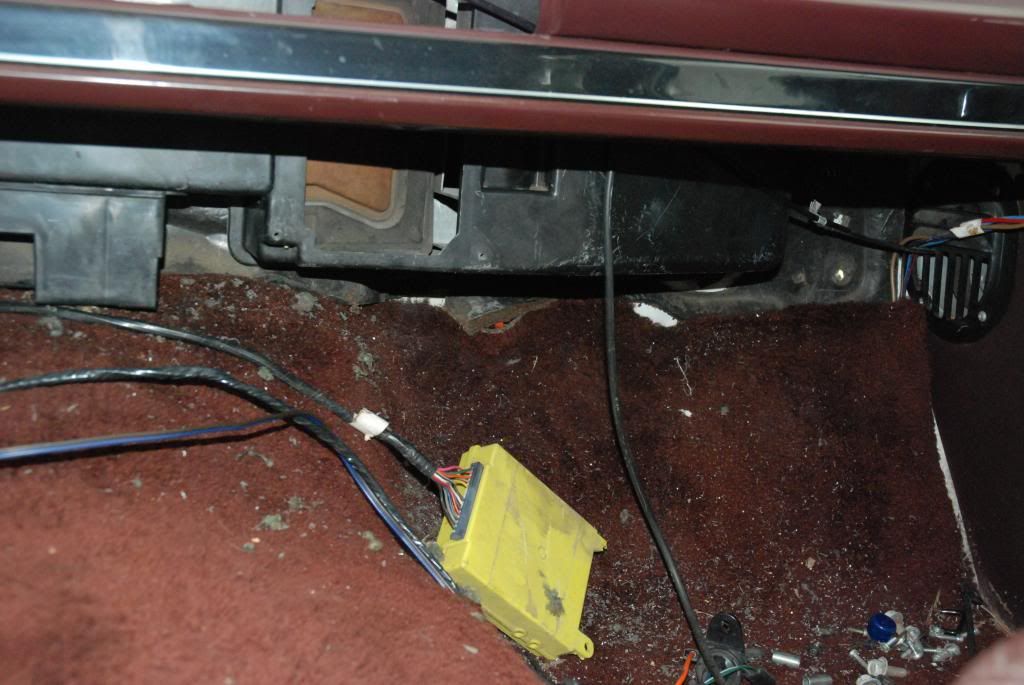

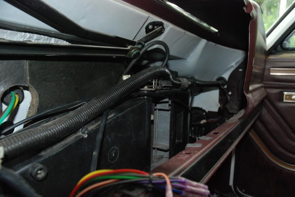

The evaporator case is built, a new evaporator has been installed, and it is all bolted on. It's a tight fit, but we have a good 3/4" clearance in the tightest places.

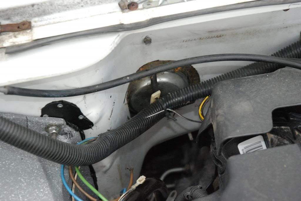

The defrost diaphragm didn't clear the engine inset, so...
I'll make a cover for it of course.
Clears the booster with no problems.
I love how much room is actually behind the dash! Lots of room for ducting, etc.
The heat outlet sits in the right spot too. (I think I need new carpet)

Looks like hood clearance will be close. Does it close? Nice rig BTW.
Thanks Dad!!
Old 05-18-2013, 10:06 AM
ProTouring442's Avatar
ProTouring442 ProTouring442 is offline
Location: Harriman, TN
Posts: 1,331
Thanks: 19
Thanked 37 Times in 17 Posts
Thanks! I originally bought it as a utility vehicle/"Go Vehicle" (like a "Go Bag: or "Bug Out Bag"), but it's really grown on me... except for its lack of mileage (13mpg highway) and lack of overdrive. The engine swap and other things will make it a great everyday driver, plus I can get rid of one car, and thus all the car's maintenance, insurance, etc.
Without the cover and the fancy ducting (to quiet intake noise) it misses by a good inch. I am hoping to modify the cover to sit lower (no fancy ducting to clear), but if not, I'll run it sans cover. Won't be a pretty, but pretty isn't my main goal here.
