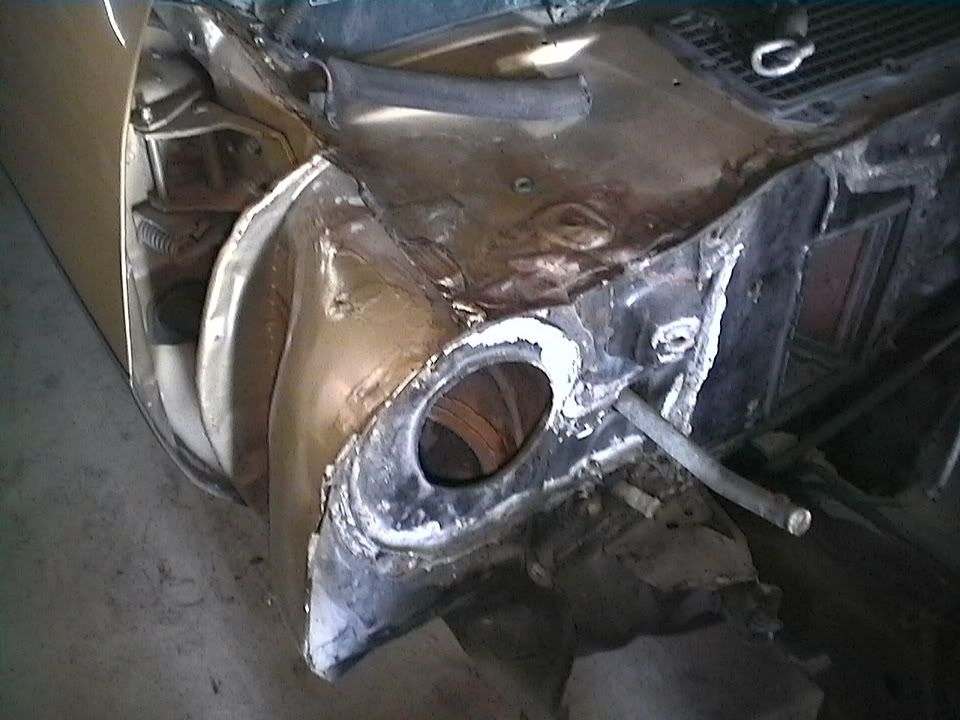

Some damage
Pulling the body straight

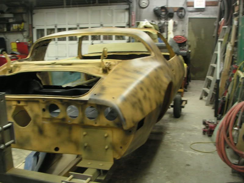

At paint shop (10/06) for body work and primer, they will also do the final wet sanding on the high build sealer (HOK) and paint after I dry sand the initial high build primer(Claussen Z-chrome).
Few months later 12/06 its back. Looks like a leopard

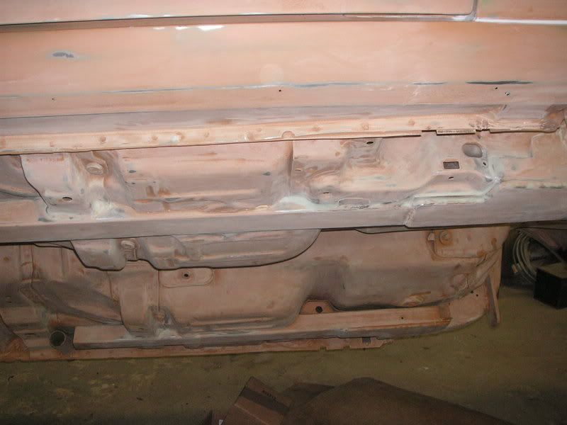

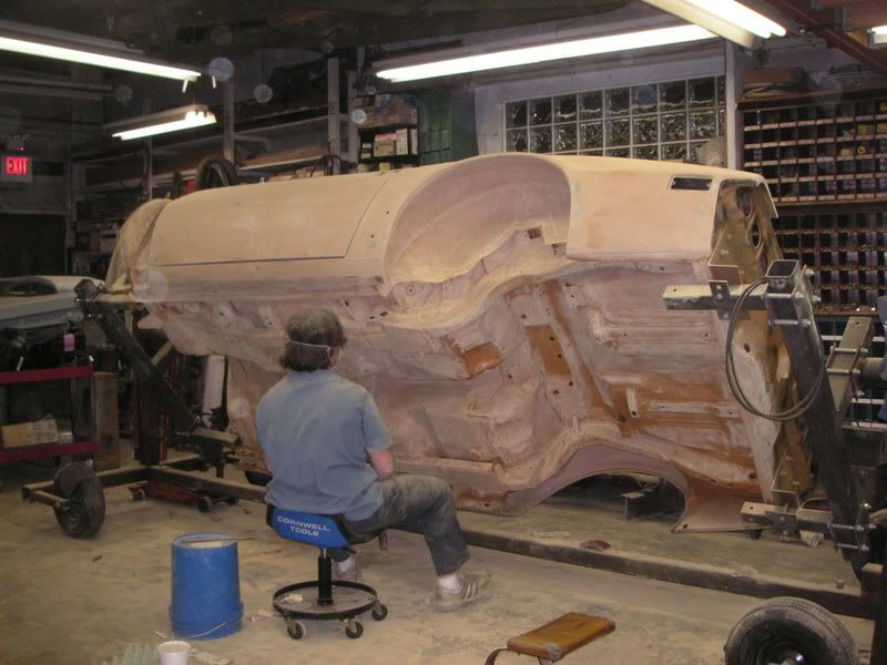

Had to take the hood, trunk lid, and fenders down again because the original body guy I had lined up did something wrong and they were rusting under the freshly applied primer. Better to find out now than later.
Sanding the primer and under side. That hippie needs a hair cut. (1/06)
Looks like a car for the first time since 1993 (2/06)

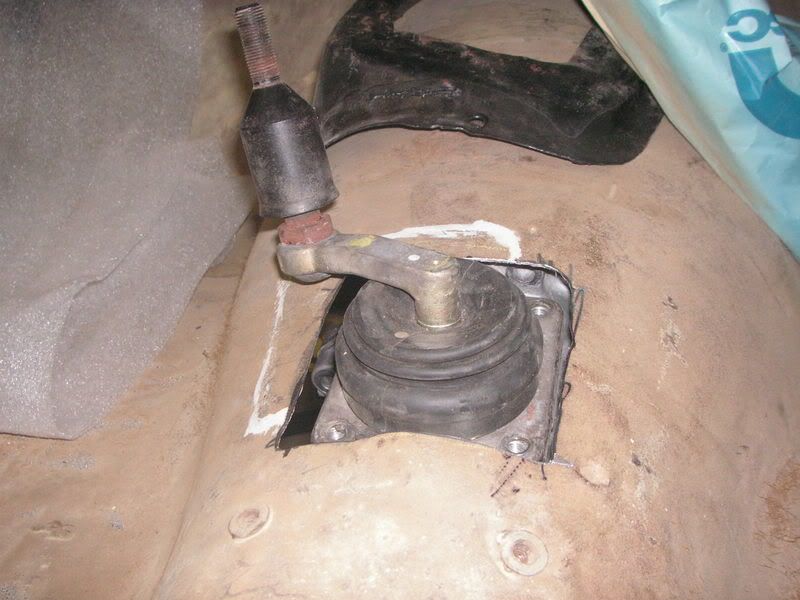

So I moved on to the shifter using a stock viper unit. Sawzall and a carbide cutter made a nice opening in the tunnel. I have to move the shifter shaft in about 1” so it doesn’t hit the console. I will be installing a short throw, which will be normal throw with the add height/ length of the shifter. Mcleod makes a nice short throw that can be tailored to your specs.

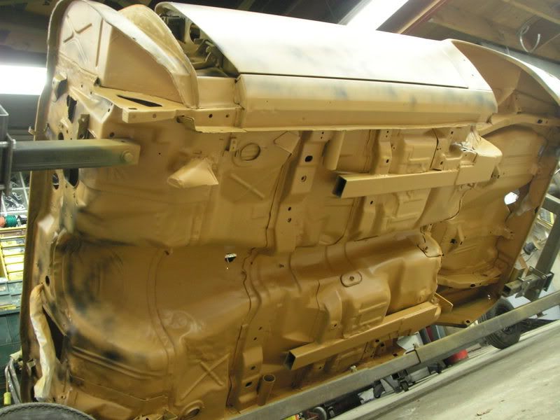

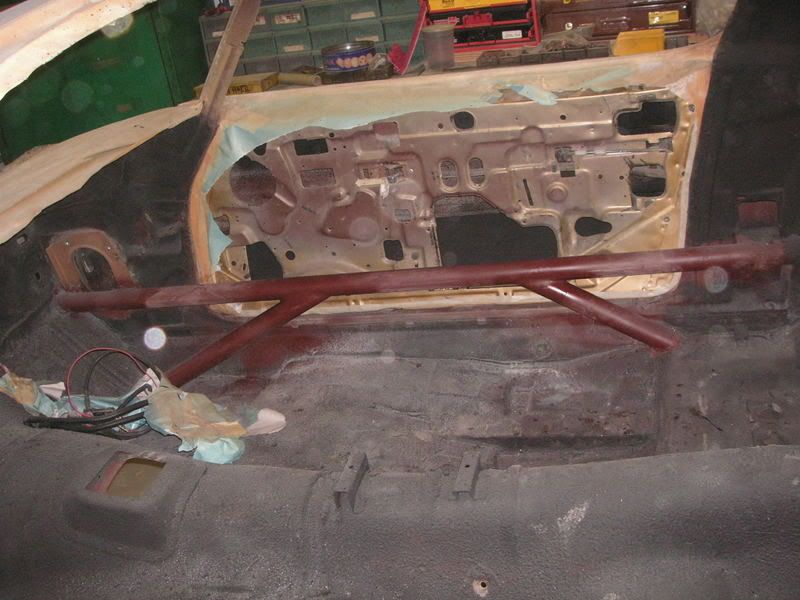

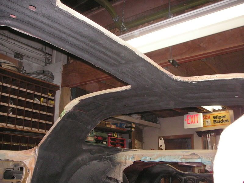

Since the last update lost of little items have been attended. Trans tunnel/console mount is attached to car, provisions for hydraulic master clutch cylinder has been made, weld on interior ‘H-beams’ and sub frame connectors have been smoothed and filled. Lizard skin coating has been applied to the interior of the car instead of dynamat. We’ll see out this stuff works out in the future. I held off on applying the sound control as my other t/a’s don’t sound all too load on the inside. Much loader when standing outside of the car. I assume this is due to the location of the tail pipe being a long distance relatively to the driver. I can always apply this with a brush later if the sound is deemed too load. But as the old saying goes, if its too load, your too old. Seam sealer has been applied to all seams and undercoating to the lower inner ¼’s as 1) they love rust and I am trying to break that bond and 2) rubber is easily removed from undercoating. All items that bolt on to the car have been sanded and initial bodywork done (spoilers, bumper covers, ect.) A new fender was add to the car as the original pass side fender that I had intended to use did not want to cooperate and would take more time trying to make it work than just starting over. I have also made provision for the battery cable to run through the frame into the truck where the battery will be located. Car as of today has left to the body shop for final sealing, fixing things that they missed the first time (not a big deal since were are still w/in the original contract as far as agreement, work to be done and money is concerned), wet sanding, subframe installation and paint. So the next time the car comes home, it will look all pretty. YIPEEEE. Gosh I hate bodywork. OK, so here are some pics:

No rusting here
No more messy welds by previous owner and Lizard Skin

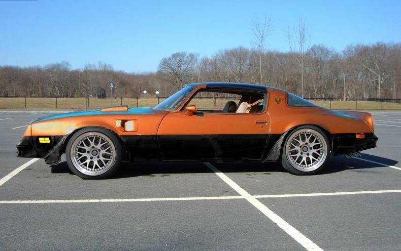

Playing with color scheme ideas. after several test panels, I decided to do fender (junk one I had laying around) to get a better idea. here is where we are at the moment. also, the T56 is done and looks great. both the powder coater and trans builder are goingt to use it on their websites.
due to lack of sun and camera, teh color is off slightly. this seems to be a problem with golds and pearls.
the area around the extractor better represents the actual gold color
close up of scheme.
image courtesy of fellow board member
paint colors are HOK goldmine pearl, candy apple over soar gold followed by mercedes/ european black. the front and rear will tapper down a little. this is just for an idea to see how it would look around the body line.
