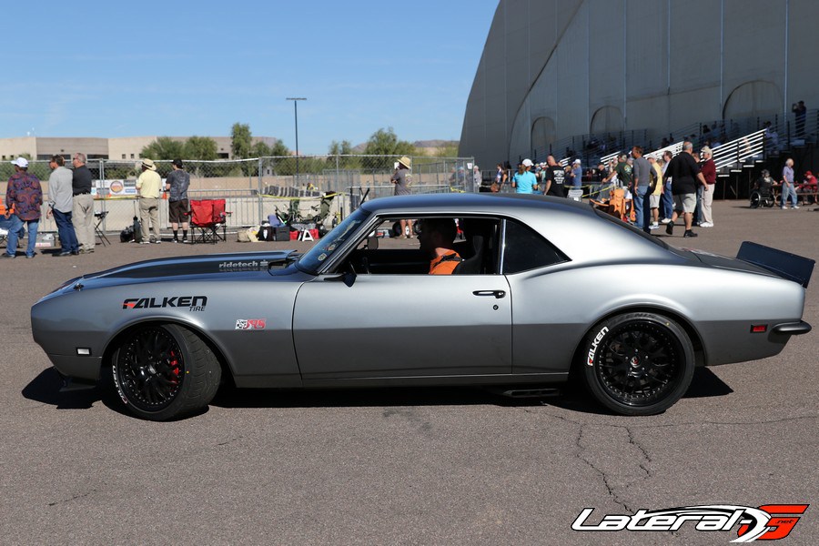

Does anyone know anything about this '68? Normally i keep track of most of the 1st gen builds on the forums, but i don't recall seeing this one before. I really like how it's done.

Aarik Gault from Indiana. He proposed to his girlfriend at the autocross there on Friday!
They were also a Muscle Machine of the Year contender

Any more details on his build? Found a video stating he's using ridetech HQs. Full level 2 with a stock sub? Wheels/Tires?

Jakes Rod Shop sub frame and torque arm suspension. 275/315 combo. Running the RideTech TQ coilovers.

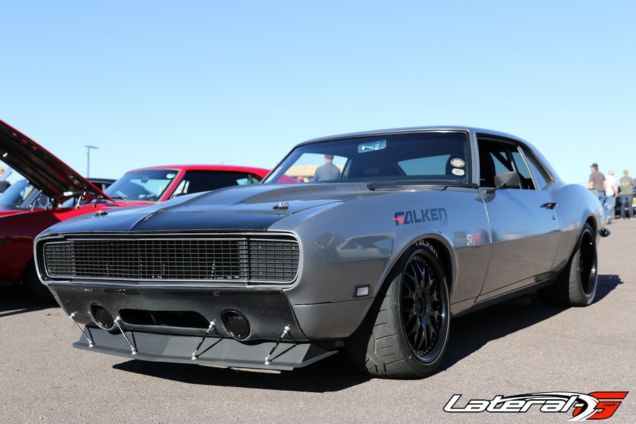

I would like to find out the paint color. I really like the looks of this car. Nice job.

Thanks Bret and Dan for filling them in, got a text from another member saying this thread was here. Not on here a ton but appreciate the compliments. I will try and look for the paint code tonight, I am going to make some changes this winter and will have to re-paint the car. I bought the car as a stock painted roller and added all the suspension and other parts. Feel free to ask any questions.

And i'm also interested in the paint code. The color combo looks great.

The paint code is a Honda color, still need to get the code. I'll post it once I get it. Wheels are KWC forged 3 piece in 18x10 and 18x11.5. The wheel company was recently bought out and will be changing their lineup in 2016. 275/315 Falken tires. Changing wheels this winter and going 315 front and rear.

Great!!! Thank you for looking up the paint code. By the way do you have any high resolution pics of your car that you could post. This is one of the best 68's I've seen.
