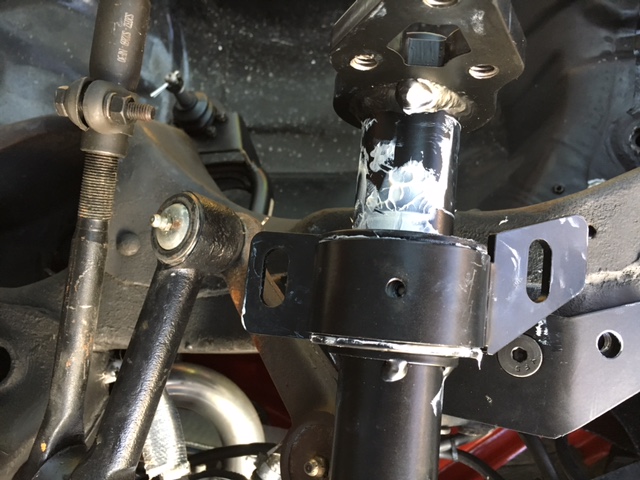

My muscle bar seems to be too long
I took some measurements and I need to compare
Factory Front Frame Rail Width is 41 3/8"
Mine measure 41.5" (even better for this situation)
The bar has welded bushing retainers in each end about 4.5" from the ends
The Inside Welded Washer to Washer Width = 29" is this right???
The sway bar seems to be either welded wrong or the bar is the wrong length. Please help.

is it possible that you have the bushings and such on the wrong side of the welded washers....?
I asked RideTech and he said they are to be on the outside. I can understand why as it keeps the bar from walking

Get some better pics and send them to ride tech or post them on here

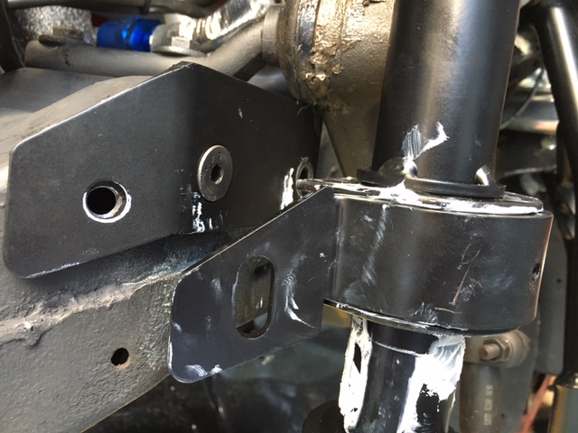

Here's another

The instructions state the bar is 38.75 Total Length. I confirmed this length.
I don't understand my frame measures factory spec, it doesn't fit. This is a nightmare. What sway bar will the strong arms work with?

Is the other side bolted up in those pics? I don't have a 70 Chevelle, so measuring mine won't help. It's either something simple or they sent you the wrong center piece. See if it'll line up with the bushings on the outside of the alignment rings?
