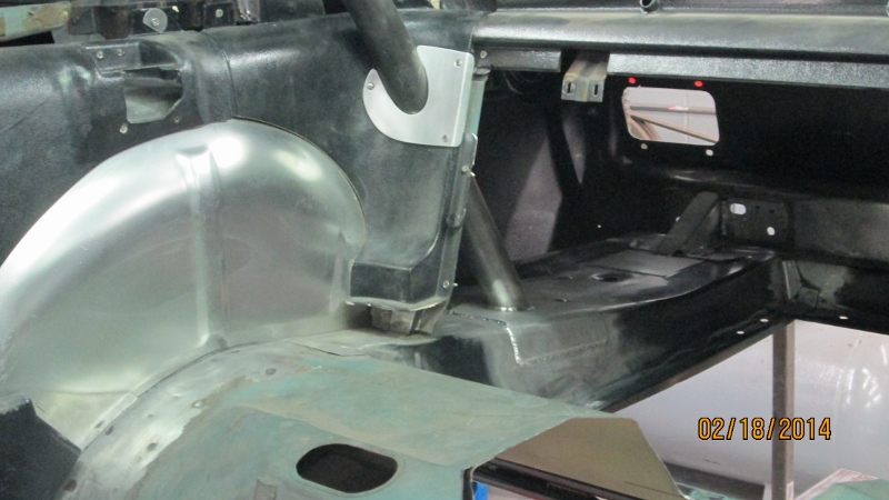

You could try mounting the leafs inside the frame rails, to get that extra space, though the front inner corner of the wheel well can get in the way of anything larger than a 275.
My suggestion is tub it. DSE mini tubs worked great and give it a factory look.
