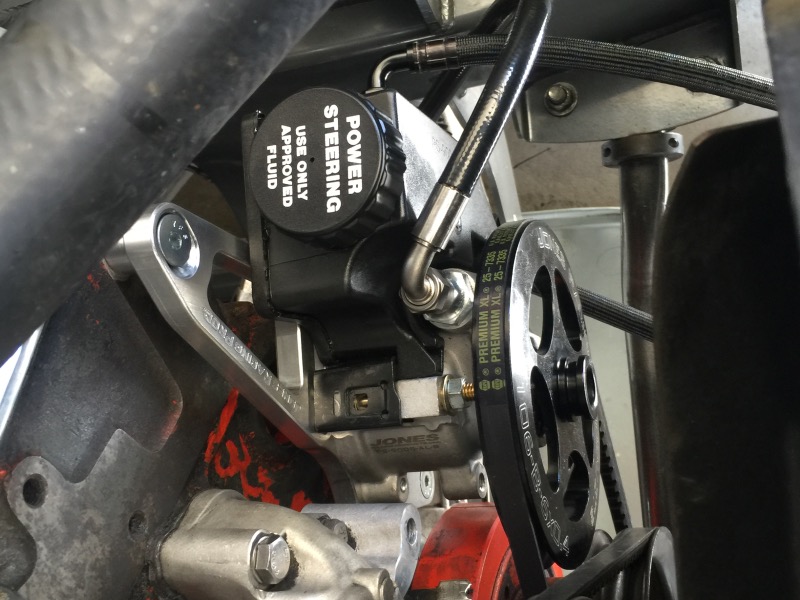

Here's a pic of the pump installed. The supplied bracket kind of necessitates running the hose in front of the Rez. Not winning any awards for my hose routing. After the fact I realized a custom hardline could have got me around the back and thru the hole. Kind of like the DSE banjo. Jones should make one of these.
The jones pump has made the steering slightly heavier which is welcomed and it is smoother over all. Like turning the wheel thru thicker oil maybe? Hard to describe. Definitely smoother tho. I don't think it increased feedback at all. Only have around 30 miles on it so far. Most importantly it doesn't leak it doesn't squeal and it won't kill my rack with excessive pressure..
