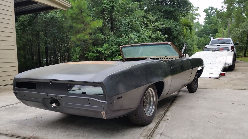

I'll skip the tear down process, and skip straight to the restoration and body/paint steps that have been completed. This series of pics happened between 2013-2015. There was a year in there that I got burned out on the project, and it sat for a while.
I put the body on a rotisserie, and sent the car to get media blasted. At the time, I was hoping the car was indeed rust-free, and didn't have any horror stories. I had my fingers crossed for a simple repaint. You all know how this story goes...

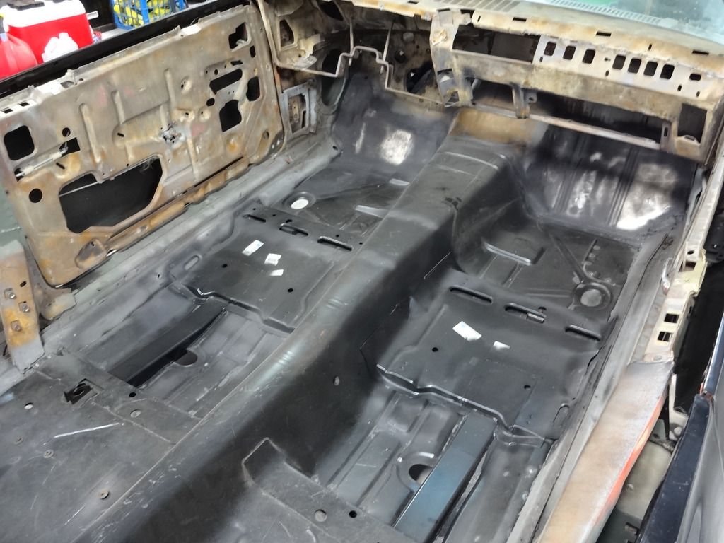

Here is what we found under the paint. I wasn't too pleased about it. Just a lot of crappy sheetmetal repairs, swiss-cheese trunk and floor pans, and questionable bondo artistry. This made me regret even tearing into the car, thinking I should have just sold it as it was. This just became a full restoration, because I'm a picky SOB and want things done right.
Trunk floor = daylight holes.

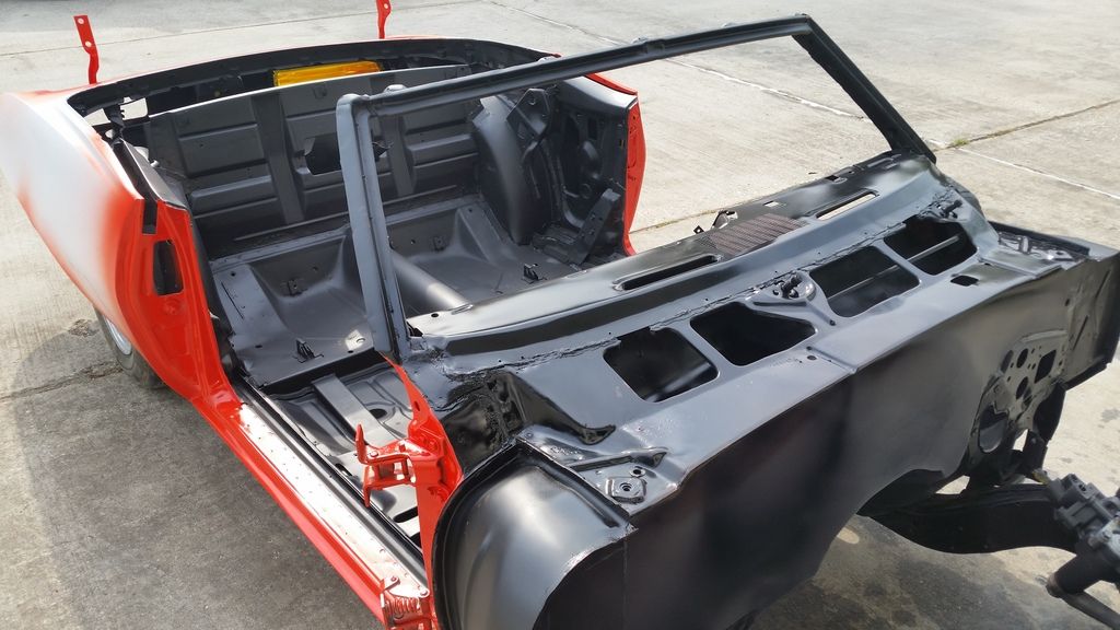

Got the car back from Gap Racing, with all the new sheetmetal installed. Project stalled out for a few months, while I worked on other projects.
Back from GAP Racing, all sheetmetal and suspension installed.

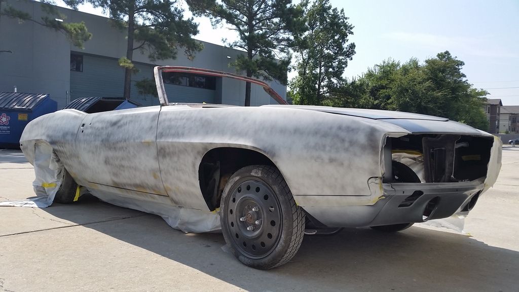

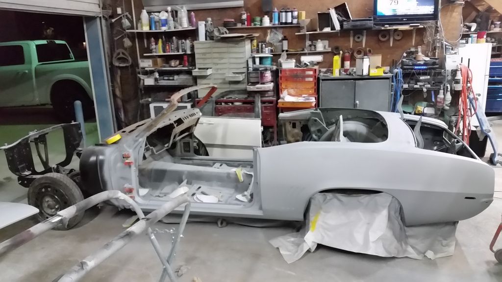

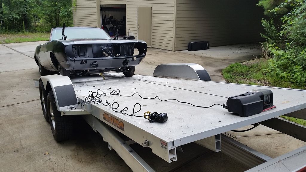

This past June, I loaded up the Camaro and took it to the paint shop, RF Customs (Spring, TX). I met with the owner, Ray Reitz, and looked at a few of their other projects going on in the shop. They had nice attention to detail, and seemed to only work on classic cars. I didn't want a paint shop that focused on mostly collision/repair work, as those places often back-burner our classic car jobs.
RF Customs would do the final trunk and door gap work, panel alignment, firewall smoothing completion, block/sand and paint the entire car and engine bay.

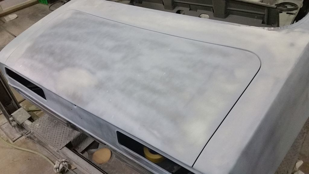

Working on trunk gaps:

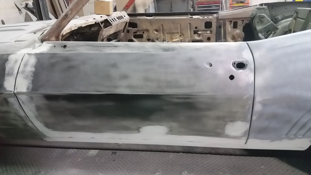

The repro quarter panels needed a lot of work, door gaps weren't even close to matching the doors.
Ray spent a lot of time getting the door gaps perfect, as well as the trunk gaps. I should have the car back by October, which was a month ahead of our agreed date. No paint shop prison, amazing.

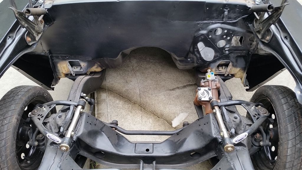

Welded up all the misc holes on the inner fenders, and filled in all the little dimples. I see a lot of high-end builds skip this step, when they shouldn't. Looks much better smooth!

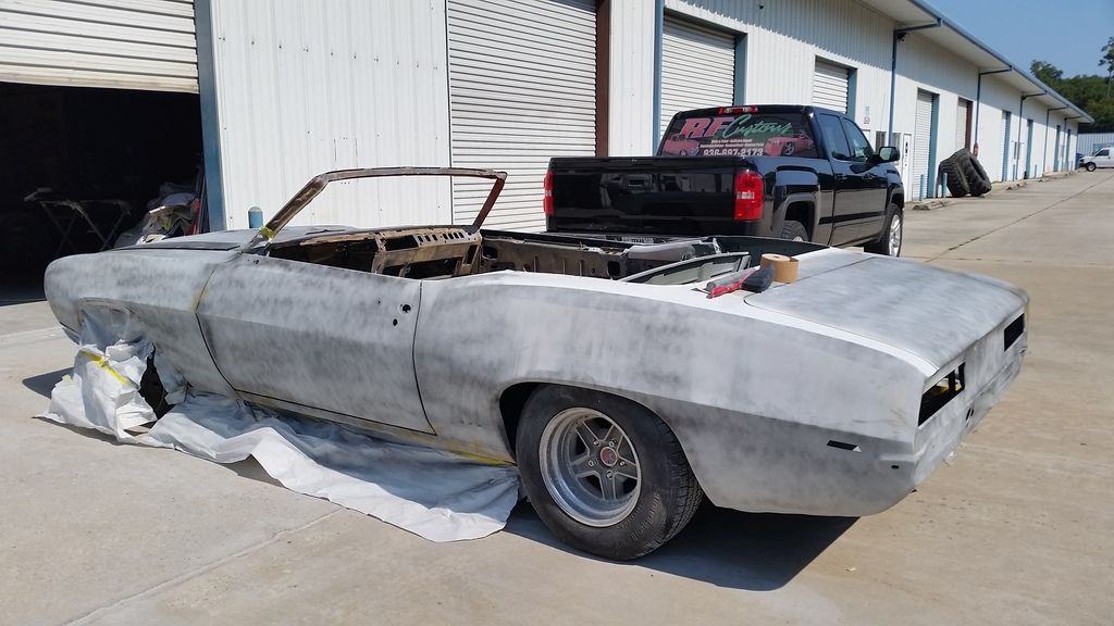

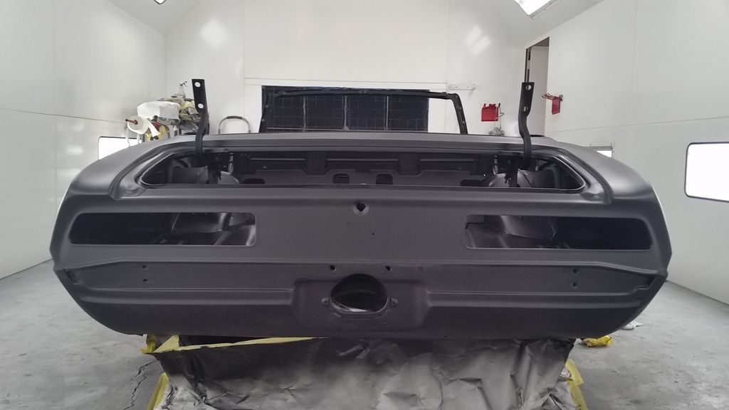

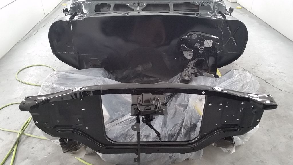

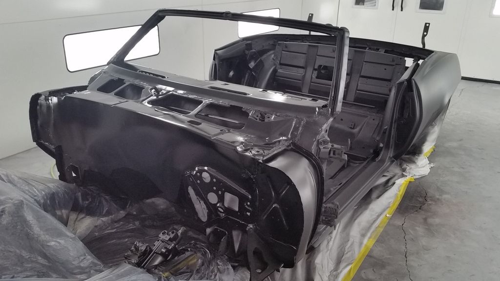

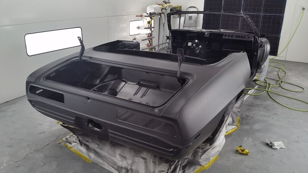

In the paint booth! Laying down epoxy primer on every surface. I have to admit, the car looked killer wearing satin black. At this point, the car has come a very long way!
Smoothed the body seam surrounding the tail light panel, as I plan on painting the rear orange. Subtle, but looks cleaner like this.
Firewall has been completely smoothed, painted in semi-gloss black. Entire engine bay will be this color.

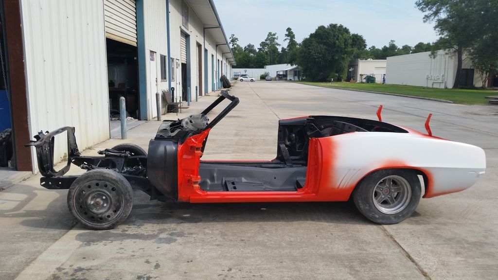

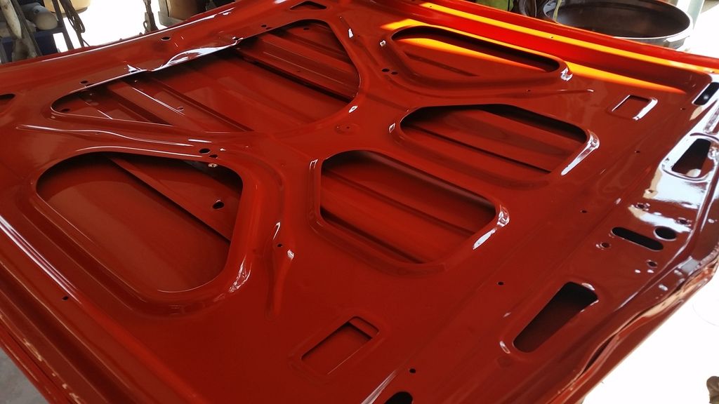

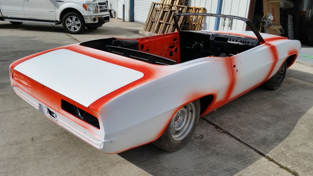

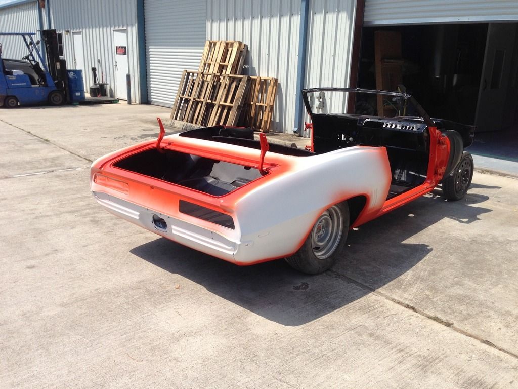

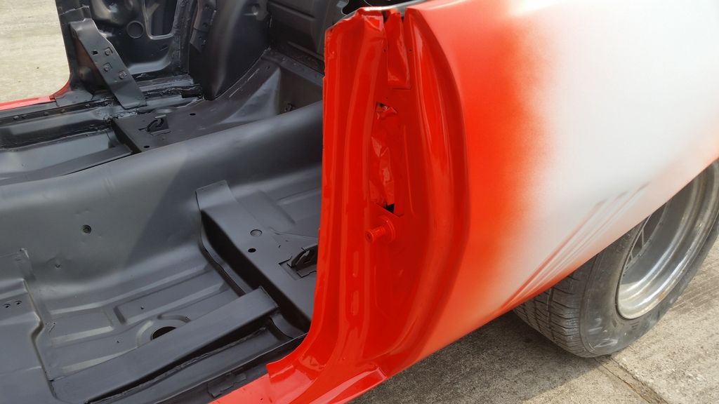

We have Orange! Laid down a base coat of white to make the Hugger Orange pop more. Car was disassembled to do body work and paint the jambs. Door jambs and trunk jambs are now completed.

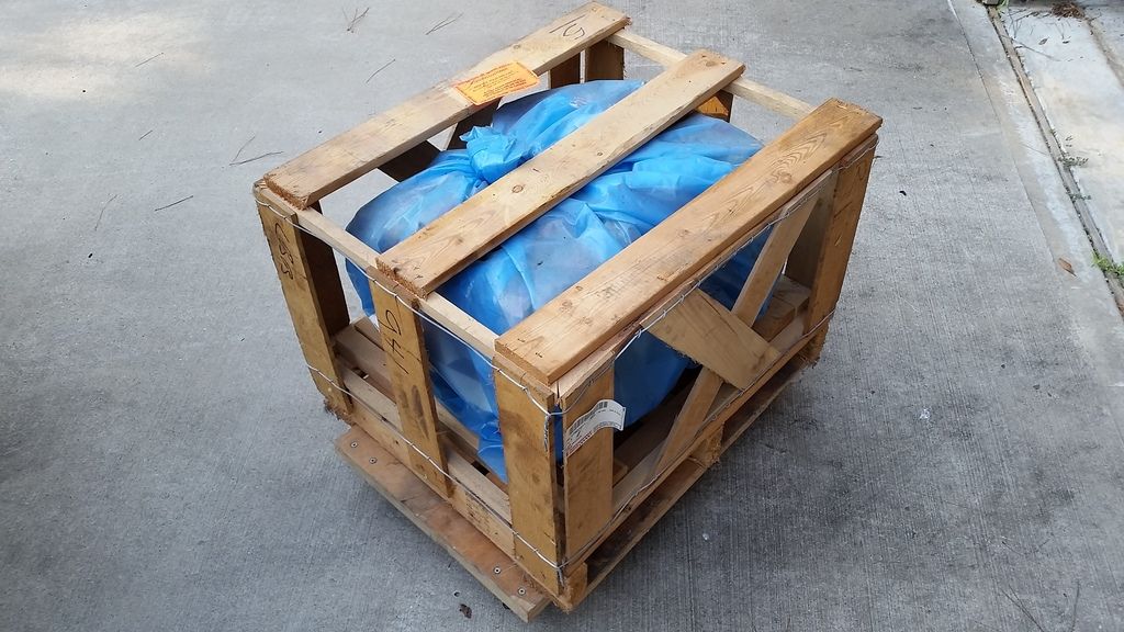

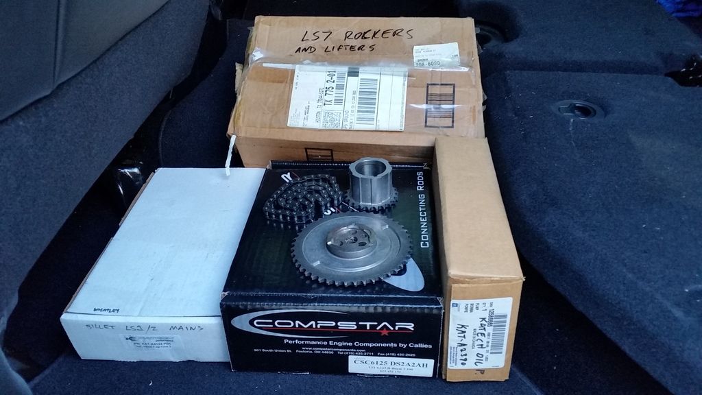

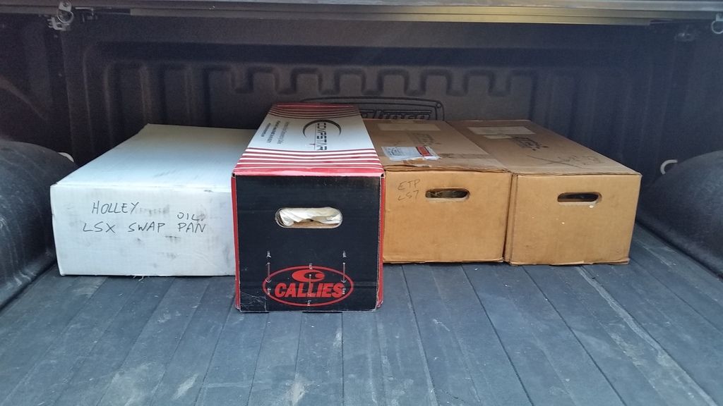

Texas Speed & Performance did the machining and assembly on my engine. It is a 427ci LS7 that was built from all brand new parts, including the block. I went with a relatively mild cam, as this car is a cruiser and I want to maintain street manners. Target is to make 525-550 rwhp.
GM LS7 block
11.1:1 CR
ETP/Mast CNC ported LS7 heads 64cc
TSP custom cam - 233/239 0.595/0.603 113 LSA
Callies Compstar crankshaft and rods 4.0" stroke
Wiseco pistons - part K445X7 -15cc 4.127"
Katech ported oil pump
All ARP hardware
Clevite bearings
Cometic head gaskets
LS7 rocker arms with Comp Cams trunion upgrade kit
New LS7 block:
Bunch of parts:
Arrived at my shop:

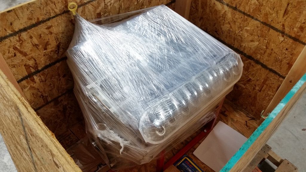

Installed a billet valley cover that I had left over from a previous MagnaCharger kit install.
Intake port:
Exhaust port:
I had the sheetmetal intake built by my late friend John Beck, who passed in 2013. It was always intended to be the centerpiece of this engine bay. I challenged him to create some CNC billet runners, forming a cross-ram of sorts. The intake is a work of art, and he will be missed.
