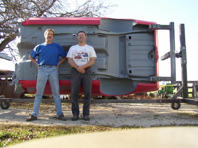

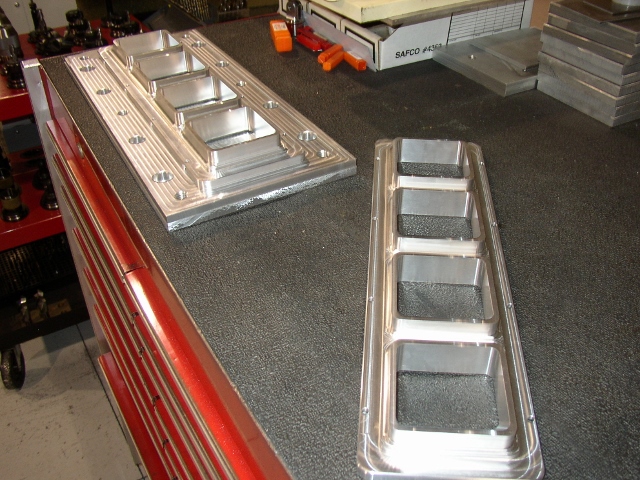

Thanks again for the kind feedback. Drove the car yesterday 21 miles and did EFI datalogging to fine tune the XFI. Car is FINALLY running well. Took me three years to figure out the fuel injection software. Whew!
Anyway, here's a couple of my favorite pics.
The first is Charlotte GoodGuys.
The second is rotisserie with Tony Goodrich from Tony's Rod and Custom, the guy who helped me tirelessly and made this project possible. He's on the right.

And finally a pic of the hood grilles in CNC form. We made the hood grilles two piece so the chrome platers (Sherm's) could get in the corners.
