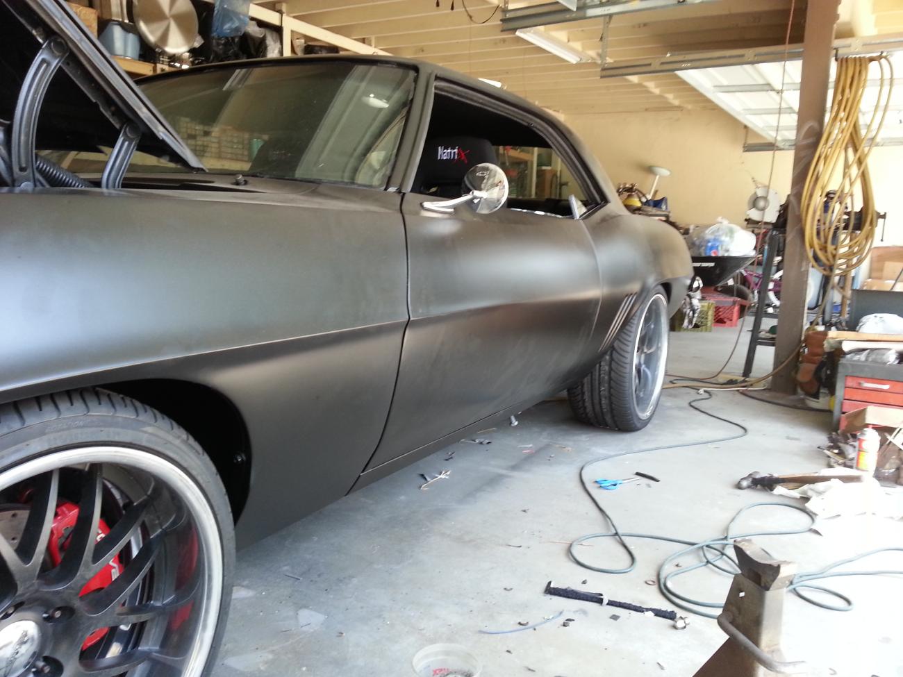

Hello Everyone,
So i recently picked up an L99 mated with a 6l80 with approx 66k for what i feel is a real good deal($3600) I know there is alot of information out there on the swaps but i am gonna be honest it is too much information to sort through and some of it is very confusing not to mention the majority is on 6sp manual transmissions. So what i wanna do is create a check list on what i need to do to make this swap happen on a friendly budget.
This is what i got a 1969 Camaro with a 383 sbc/350 trans,10 bolt eaton posi 3.73 gears with moser axles, i got caltracs split leaf and traction bars in the rear,rebuilt original front suspension with energy bushings along with qa1 adjustable coil over shocks, brakes i went with c6 corvette brakes all around. Car still has the original Subframe with aluminum mounting bushings.

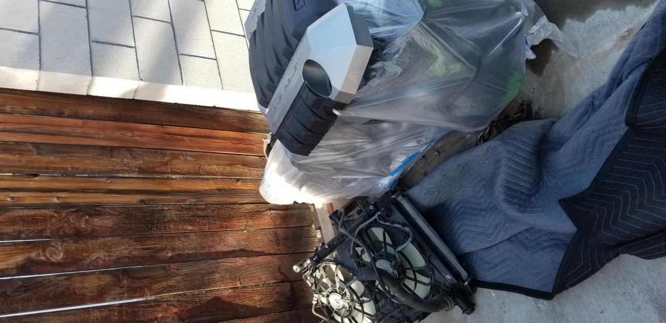

This is what i have on the engine....... i just picked up the engine cover today and radiator which the guy tossed in on the deal. He is asking if i want the center console not sure if the new stand alone harness can be wired to work with the original gauges on the console.
