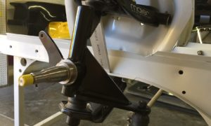

Mustang drop spindles
Luckily this happened on the first run of an Auto-x and not out on public roads.

Great example of why you should be buying quality suspension parts from a suspension company and not a fiberglass/composites company.

Yeah that's not right! I hate brake fluid on the inside of my wheels!

What brand was it ?

What brand was it ?
I think it was MAIER RACING --
not to be confused with MIKE MAIERS
https://mikemaierinc.com/
which is a separate company....
The failed spindle shown in the OP photo appears to be from MAIER RACING
(NOT MIKE MAIERS!)
as it looks exactly like the one shown here::
http://<b>https://www.maierracing.co...-mustangs/</b>
https://lateral-g.net/forums/atta...1&d=1503581416

That's correct, Maier Racing.....without Mike.
