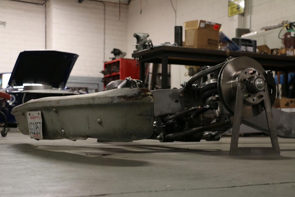

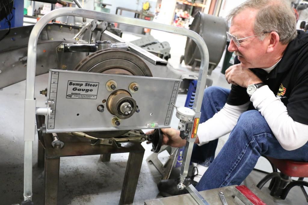

The first articles have had a few revisions through development but we're getting close.
Here, Ed is changing the anti-dive angle to 7.5.

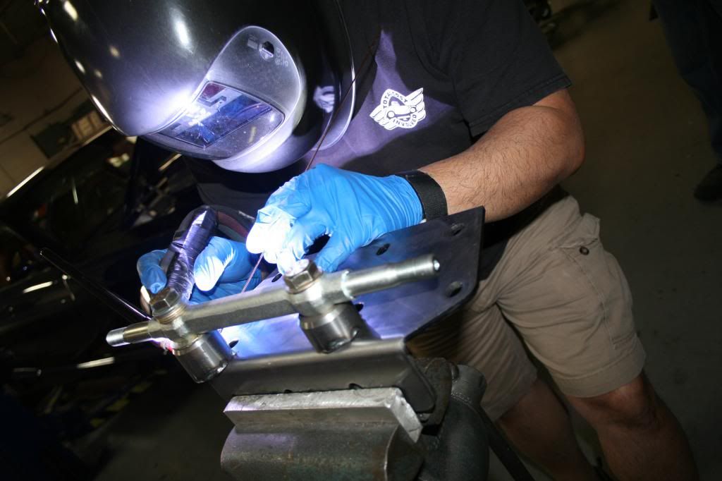

A quick tack weld

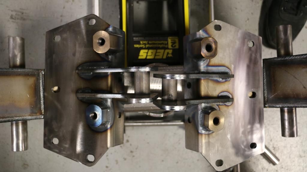

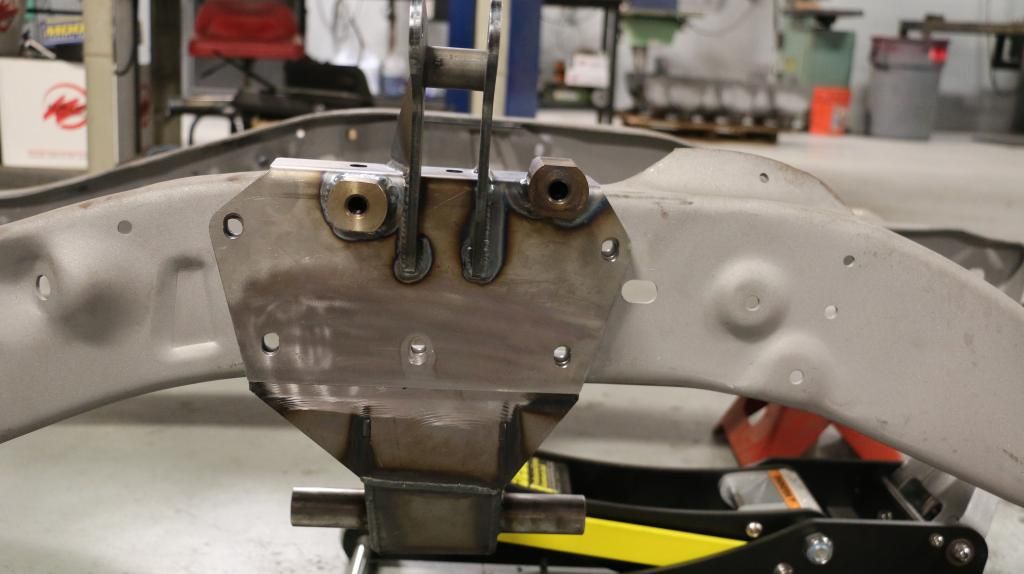

We also revised the crossmember. We raised it up to frame another inch and put a degree tilted back.
Ed installing the upper plate onto the frame to confirm some simulations.

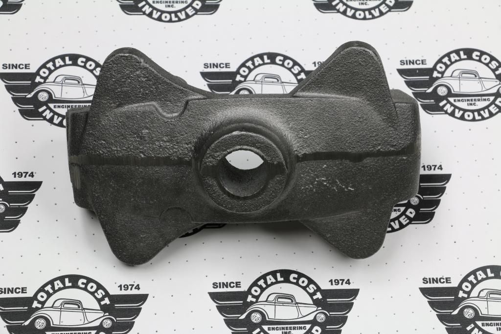

The crossmember is now in its 3rd iteration of the original idea.

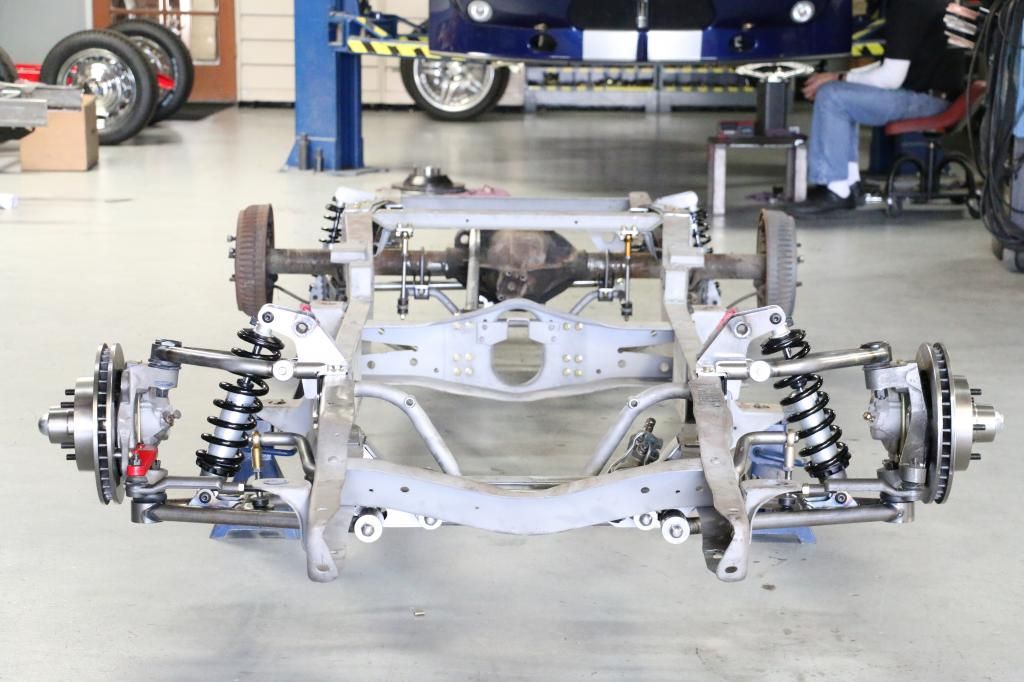

We've made a few more revisions but the project is coming along quickly.

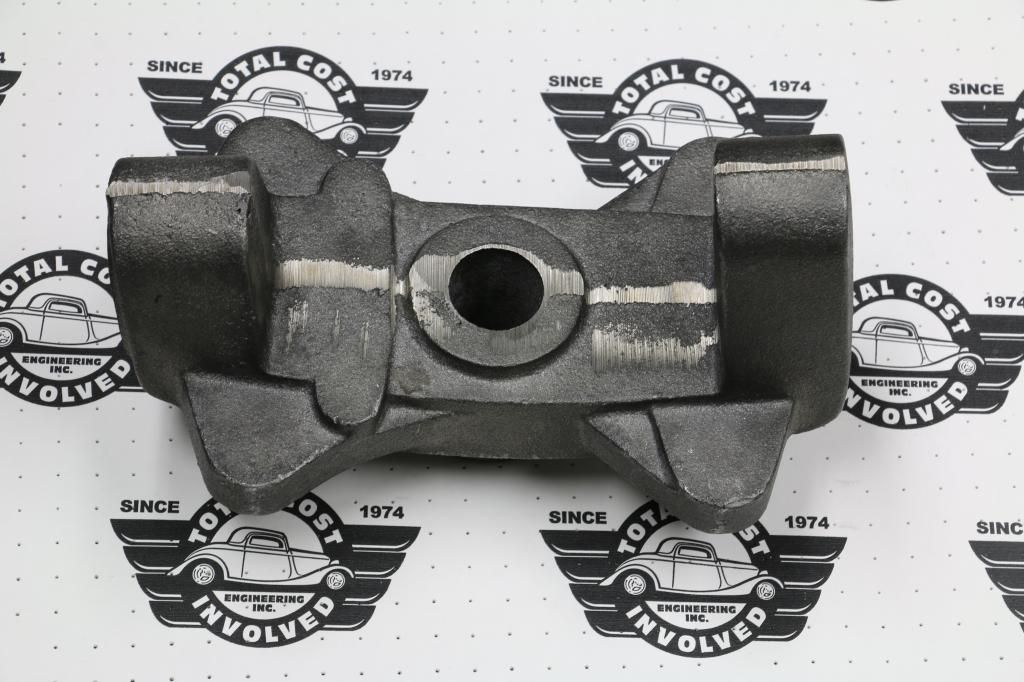

There was some discussion about which c-notch design we were going to use. The round style won out almost unanimously.
Mocking up the anti-sway bar and a few other items. This crossmember is going to be one beefy dewd once it is all boxed in and fully welded.

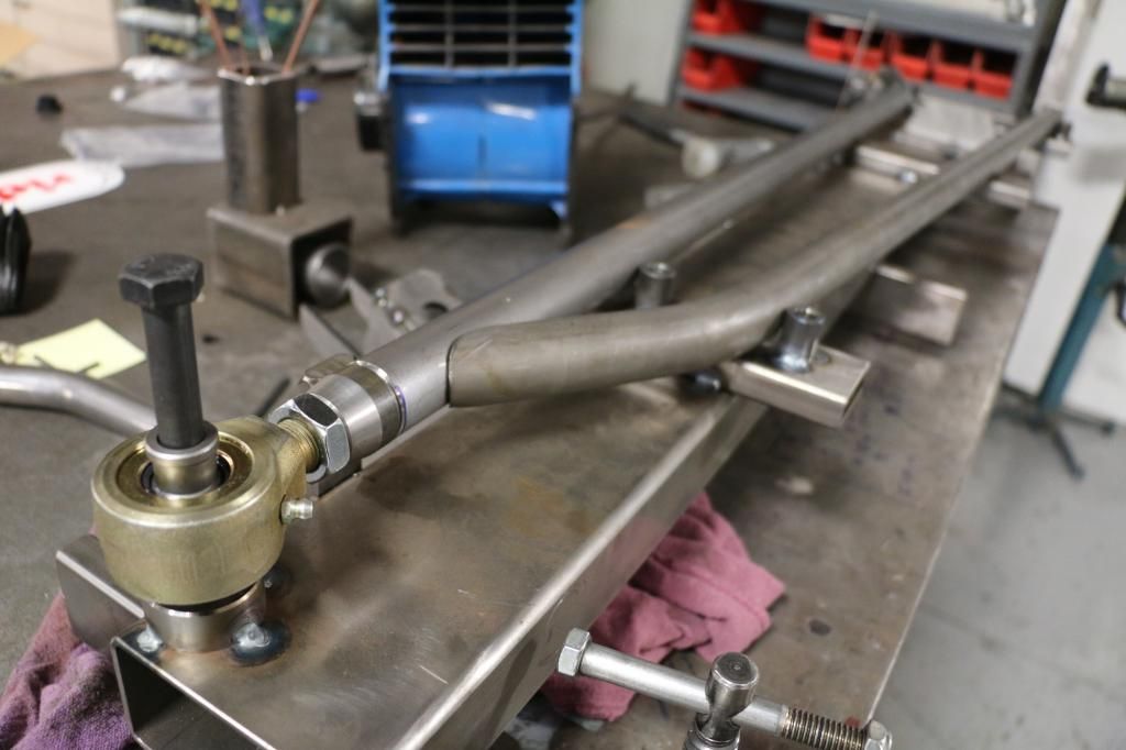

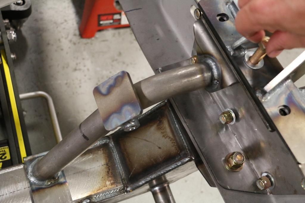

Torque Arm mount, I believe this is revision #2

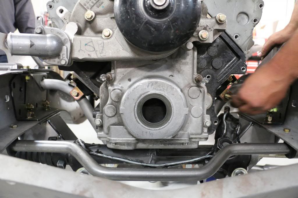

Holley oil pan definitely isn't going to clear.

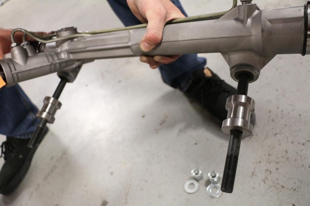

F-Body pan clears the rack but interferes with two bolts on the back of the crossmember. Engine needs to go back.

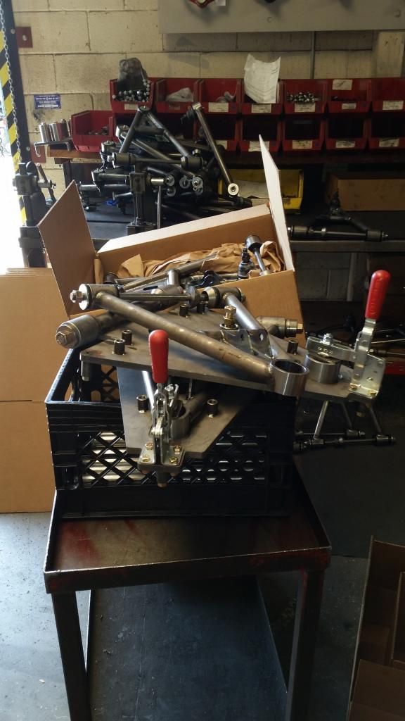

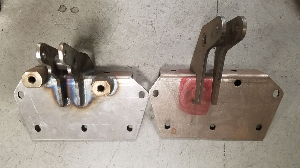

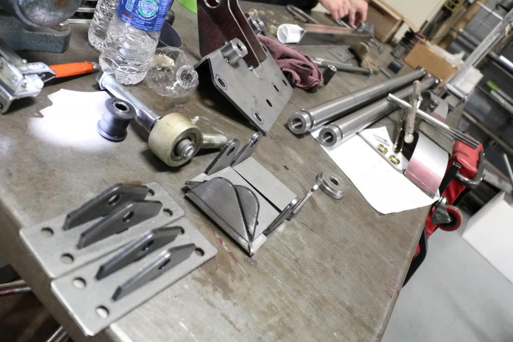

Here are the plates that will be used to make the upper control arm fixtures.
Rear shock mount fixtures

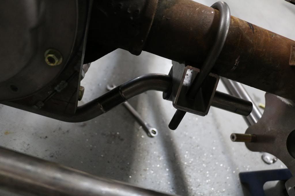

Panhard bar installed

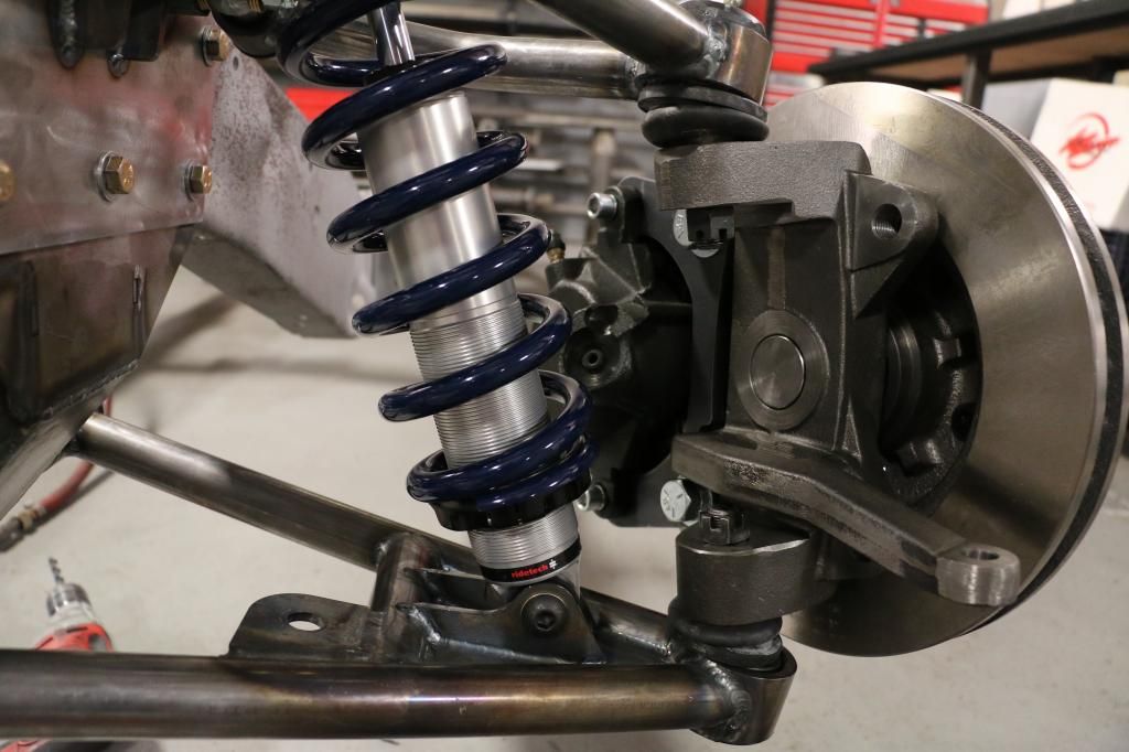

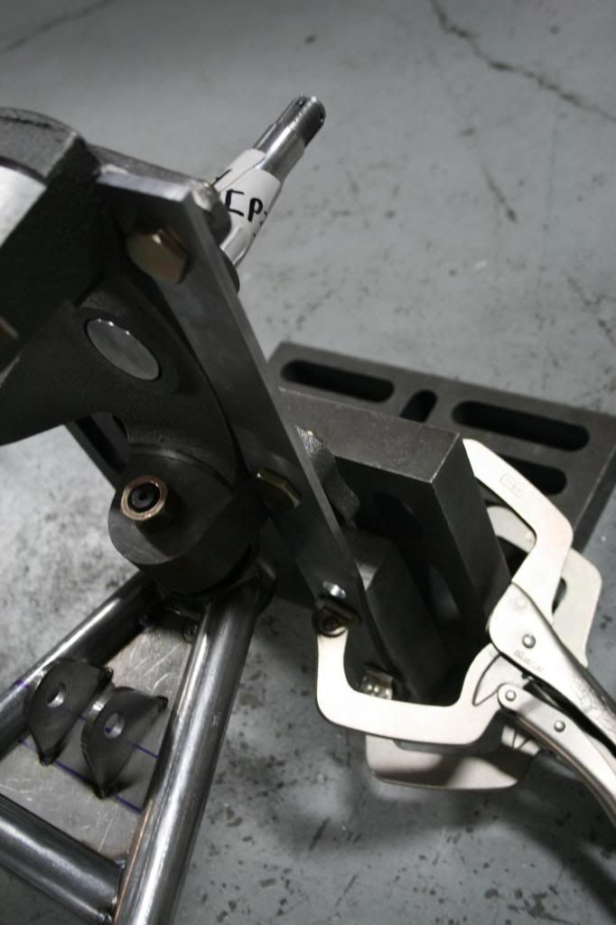

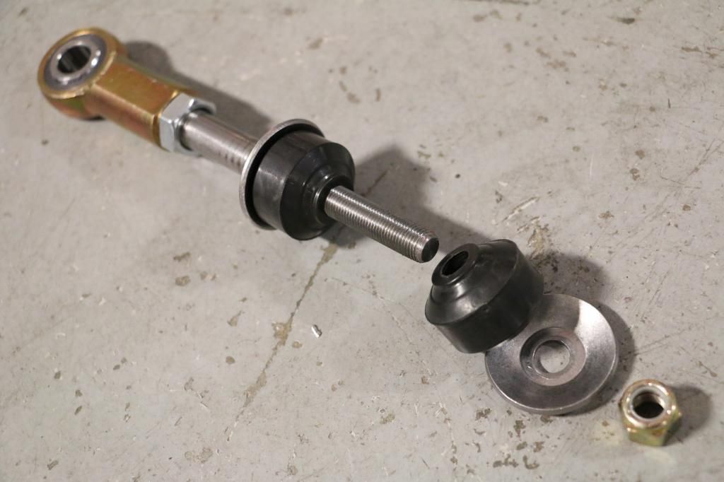

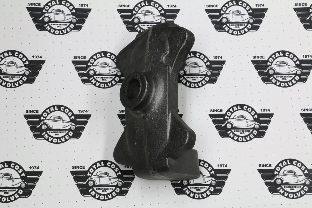

Things to note: Driver side spindle is different than Passenger. The passenger side design is our new custom set-up. It is based on a C10 pin and uses the factory lower ball joint with a heavy duty Moog upper. The steering arm is removable and helped us attain the geometry and turning radius we desired.

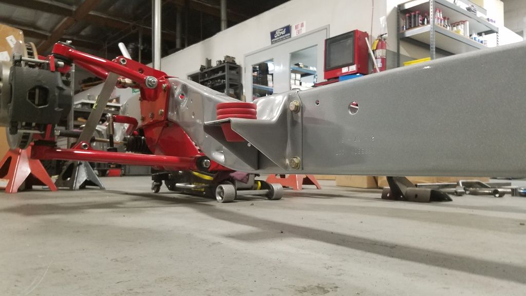

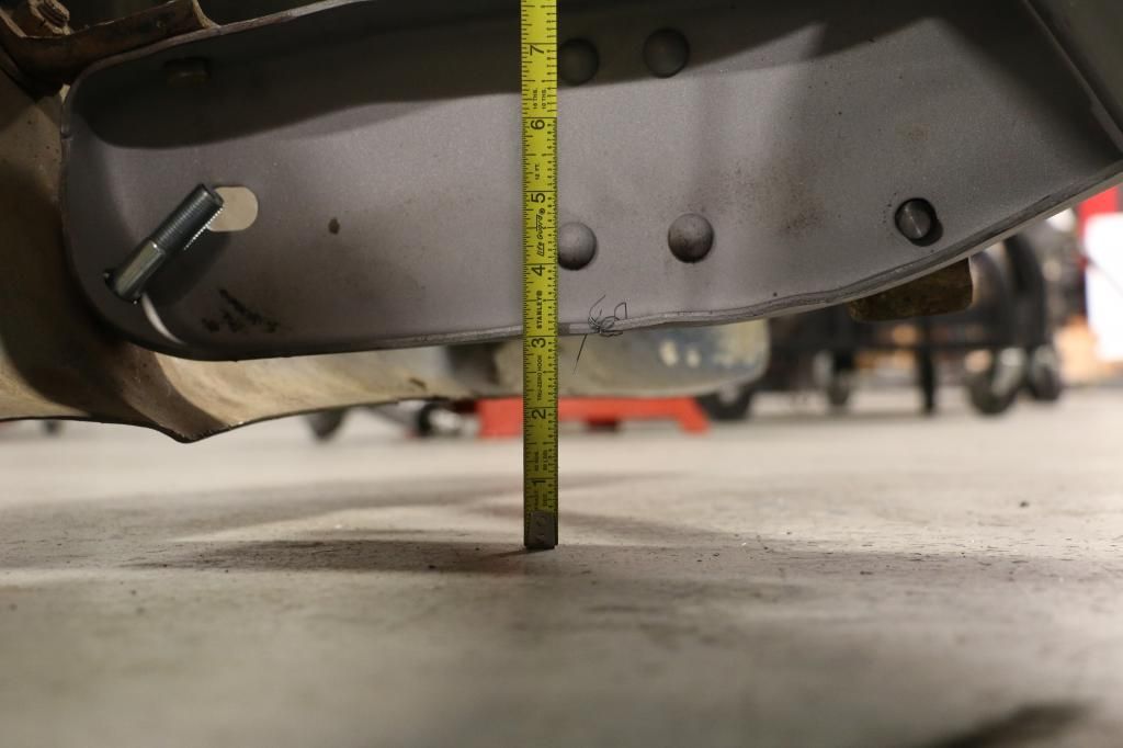

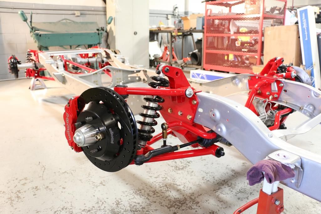

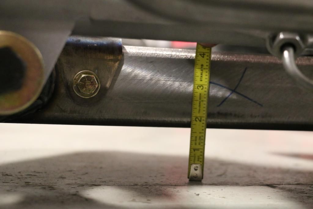

How's this for ground clearance? We tried and accomplished keeping all suspension parts on the same plane as the bottom of the frame.

We finished up some first articles this week. The long tedious process of confirming fixtures and parts begins now.

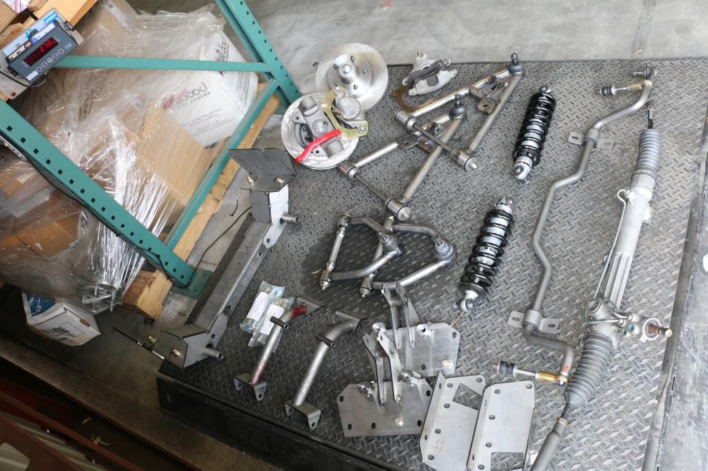

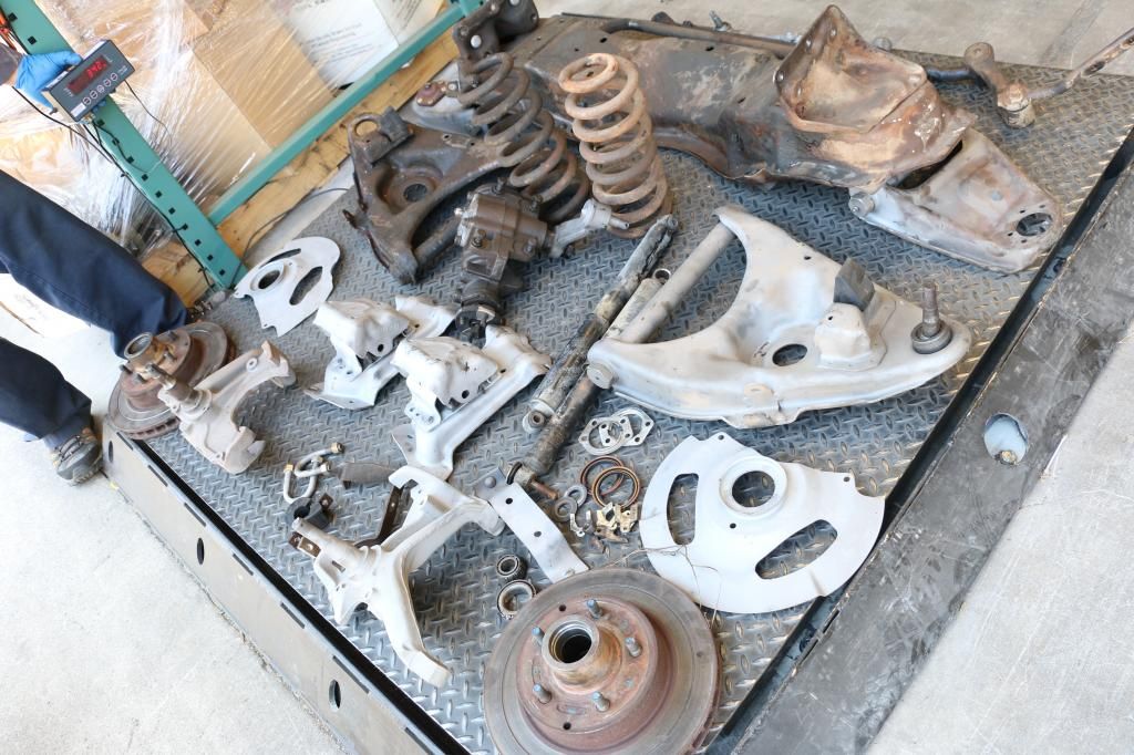

Stock parts = #342 lbs
TCI parts = 270 lbs (Total weight savings of 72 lbs)

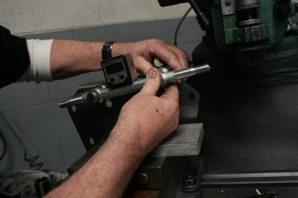

We just received our first article spindles yesterday. This was one of the most important pieces to the puzzle. We still have a lot of time studies to accomplish but we're moving very quickly, so quickly that many of the R&D projects are finished and have moved into the production department.

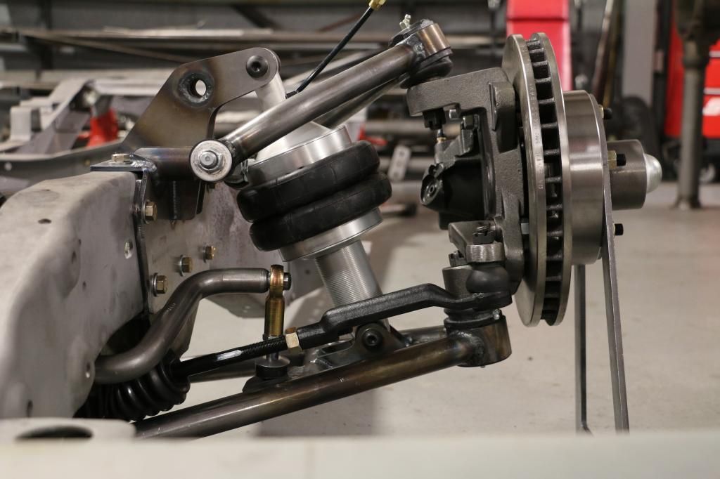

Here are some of the pics from the Shockwave mock up yesterday (based on a 26" tall tire). This is with the 2" Ridetech shock extension, I am hopeful the 1" top will clear the control arm cross shaft. This will give another 1.125"-1.25" of compressed travel but will keep the suspension below its designed operating range. I will mock these up today sometime just to know.

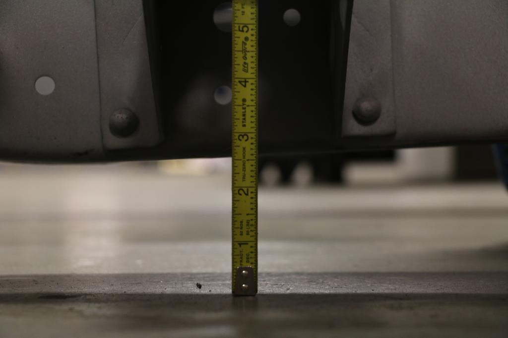

Looking underneath the bumper at the crossmember.
This picture is a little deceiving because I couldn't get the camera low enough to get the true height. The crossmember is closer to 1.75".

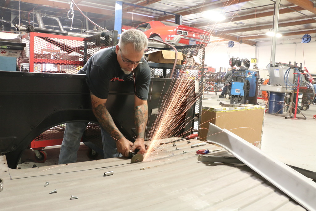

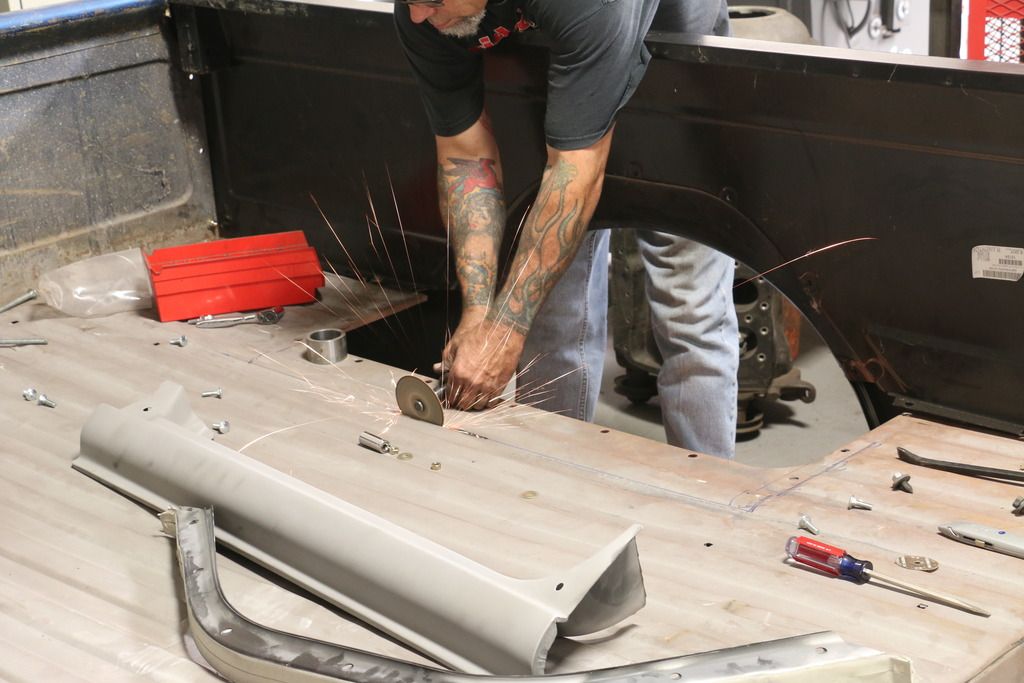

We're back on our project C10. The new bed sides are on and we've began cutting/modifying to fit some massive rubber out back.

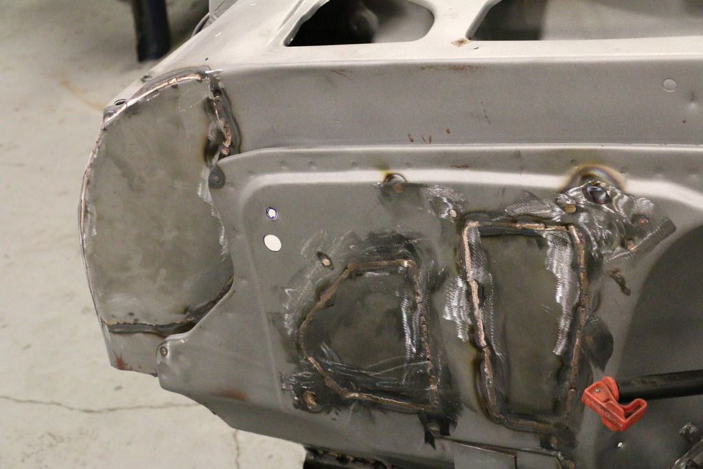

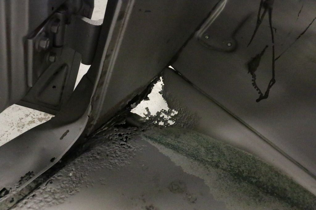

Slowly making progress on fixing all the rust issues and filling holes.

So anyways, with some freedom to proceed how I choose I began to mock up some things. First and foremost I put some shock simulators in place to mimick full compression of the 5.2" travel ridetech coilovers. Then I placed some wheel simulators in place mimicking 26" tall tires. I know this is probably less than what some may run but I plan to run 18x12 wheels all the way around with a 315/30/18 Falken tire which is 25.5".
Here is a pic with the frame at full compression.
The frame under the front cab mount is 5" off the ground.
Something that has been lingering in the back of my head is the original upper shock mounts we made for the front end. The engineers ditched this design early on because the truck sat too low. Basically the inner fender had to be raised with them so they felt our kit wouldn't go this route. Anyways, we still have a couple of the original design mounts sitting in a box. There is roughly 2.5" difference in height between these.

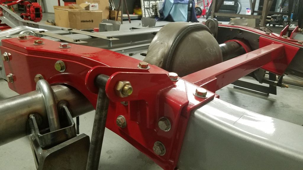

With the power this thing is going to make, we're going to need a strong foundation. I'll work on the back half next week.
July 2017

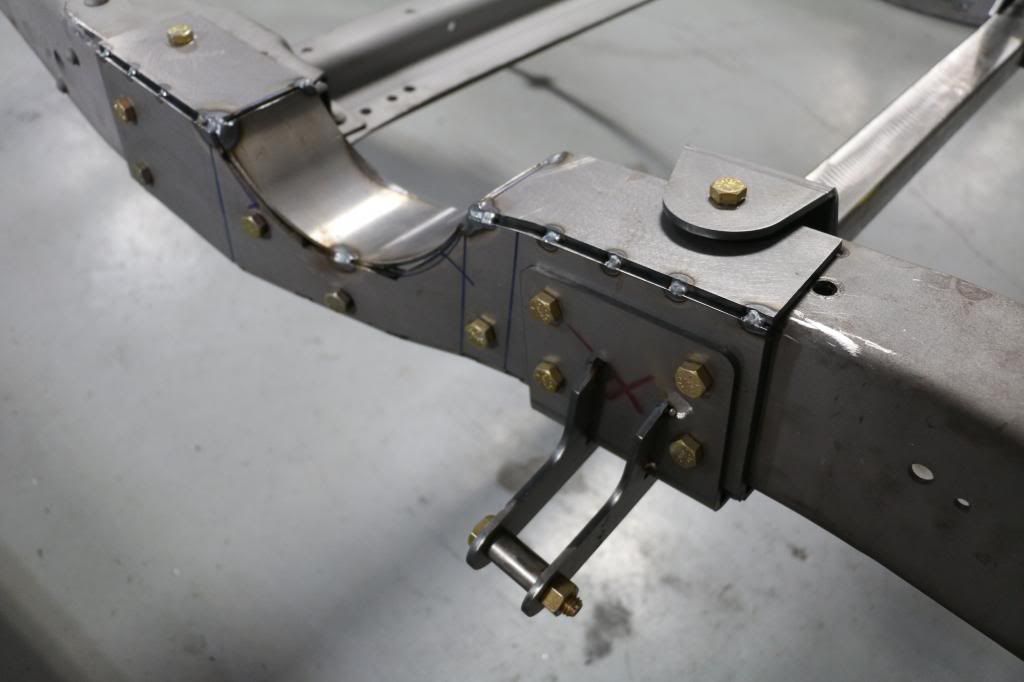

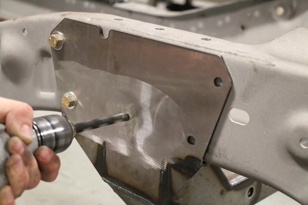

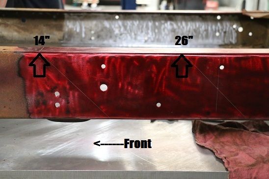

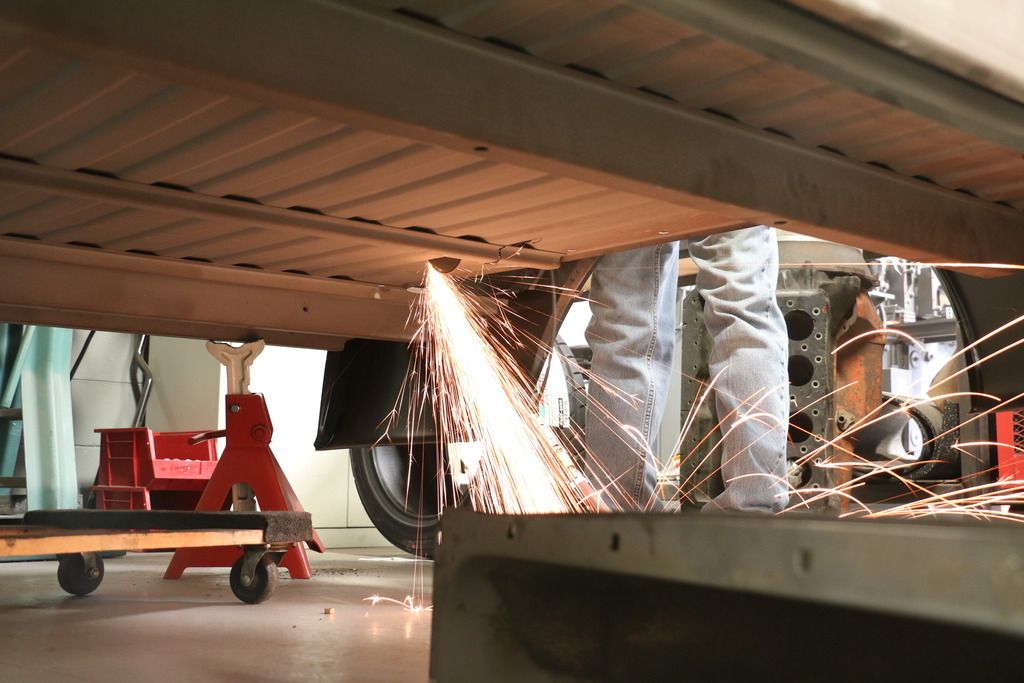

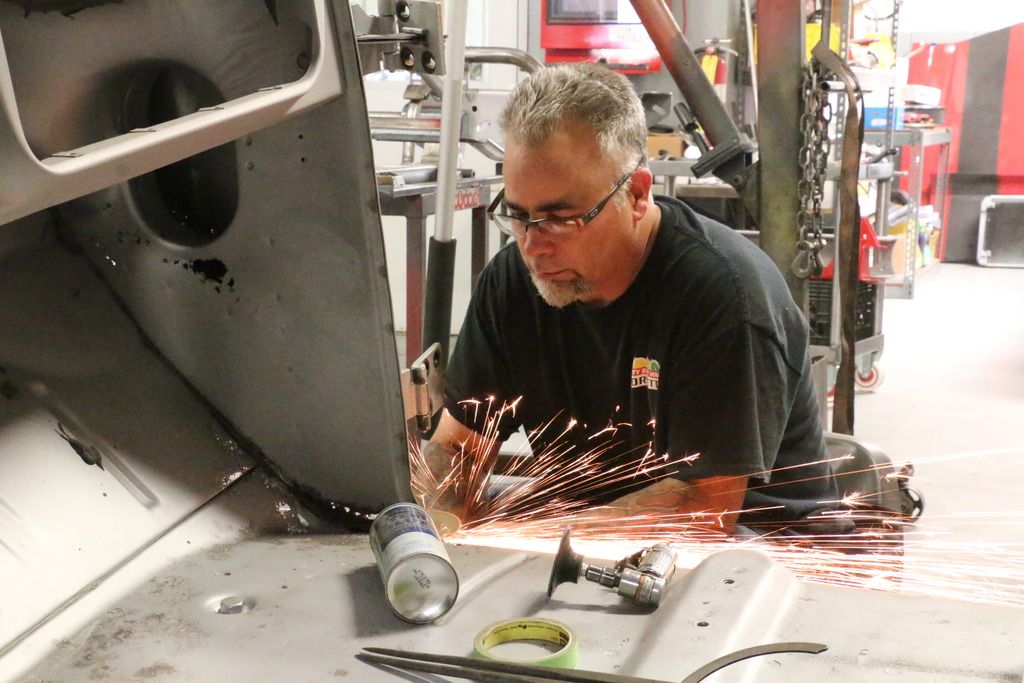

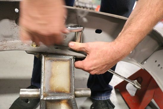

Worked on the rear boxing plates. I removed the standard bolt-on frame plate that comes with the Torque Arm kit and placed it on top of the rail. I don't need to step the rails that far to get the desired ride height but it was a good starting point.

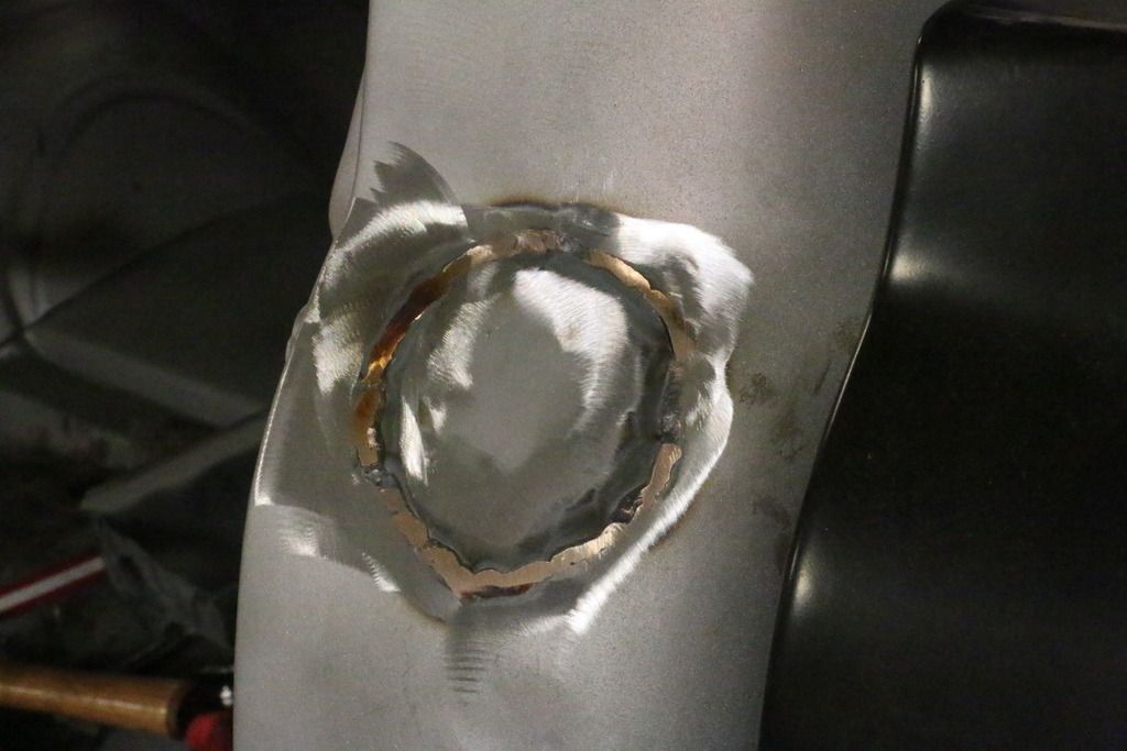

The frame is countoured in this area so I will have to put two bends in the new boxing plate to match the frame. R&D is really busy right now so I might not wait for them to draw these up and cut them on the plasma table. I might just trace and cut them out with the hand held plasma. Sure it's dirty but I am trying to get this thing back to a roller by the Brothers Truck Show.
