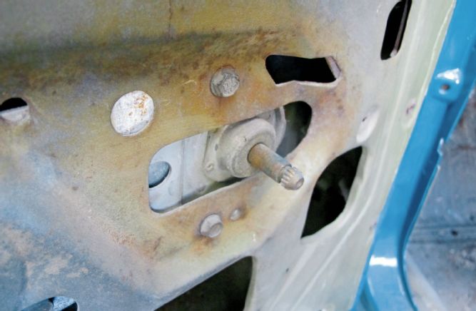

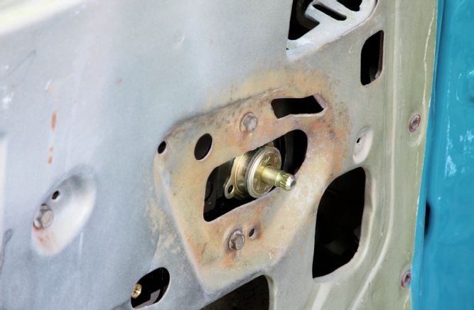

That’s a good point Greg. On 68/69 Camaros, the deluxe regulator crank stub were longer on deluxe cars, short ones for standard interiors. Here are a couple of pictures of the differences.
