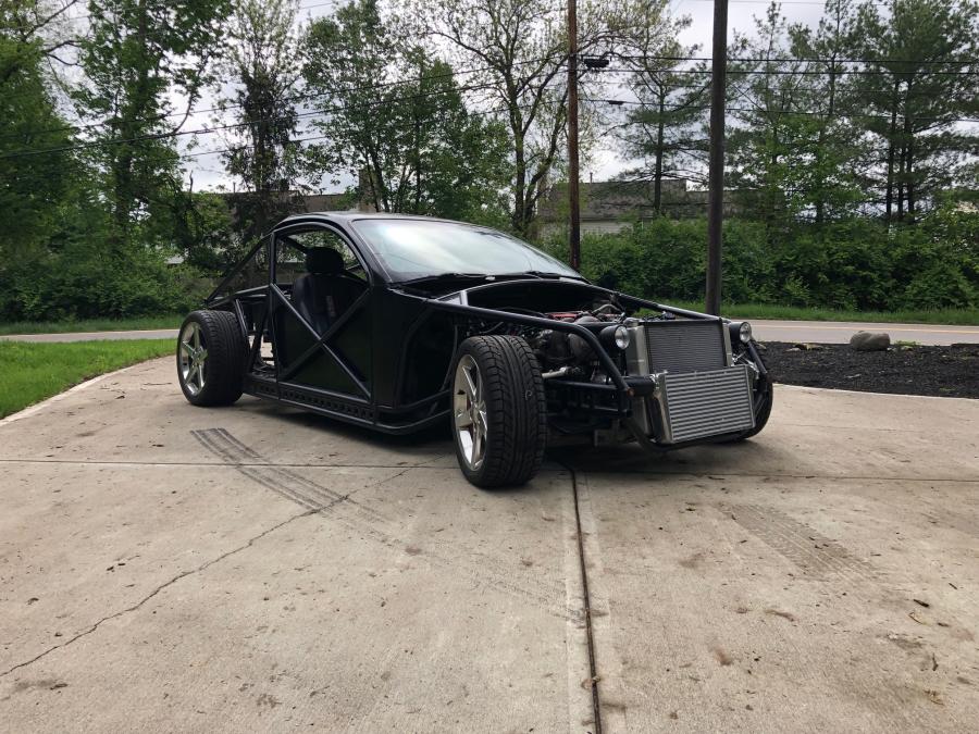

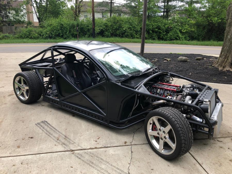

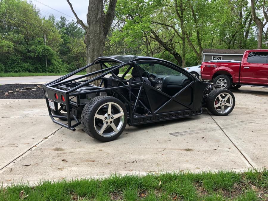

I’ve been building this car for about 3 years. Started life as a 2004 Gto and has now been reduced to the fire wall section of floor pan and section of roof. Car weighs 2500lbs and is making 525hp to the wheels.
All tube frame construction fabricated by me. Fully tig welded and braced.
Turbo LS motor
T56
C5 front suspension components
Gto rear IRS
I’m in the process of collecting metal shaping tooling now to start making some panels for it. Long term I’d like to build a custom body for it.
