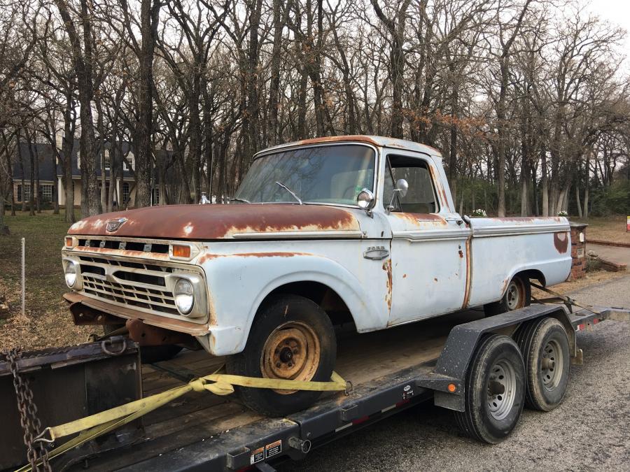

I just purchased a 1966 Ford short bed truck and I’m wanting to set it up to take it to the track. I’m considering purchasing a compete chassis and I’m asking for opinions on which system. I’m not looking for a full blown track vehicle but something that carves corners and would make a great handling truck.
