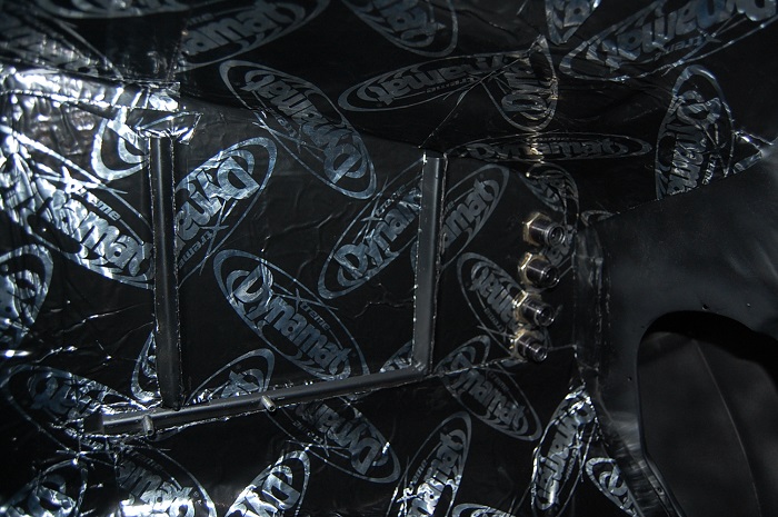

When I smooth firewalls I like to make a reinforcing bars that weld to the back side. It makes a great place to weld studs to for mounting the evap units using the Vintage Air mounting plates.
Thanks for the pics and help Vince. I have the finish coat of paint etc.. Already on the firewall. Did you add those after paint?

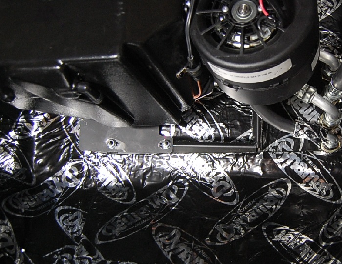

I use the template that is supplied with the sure fit kit, layout the intended holes
The ones that are to be drilled through the firewall, I use 1/4-20 elevator bolts and weld them to the inside of firewall at the location ( I attached a pic)
You are basically reversing the mounting , by making a mounting stud, rather than a through bolt setup
You maybe able to carefully stitch weld one in place prior to final finish??
hope this helps,

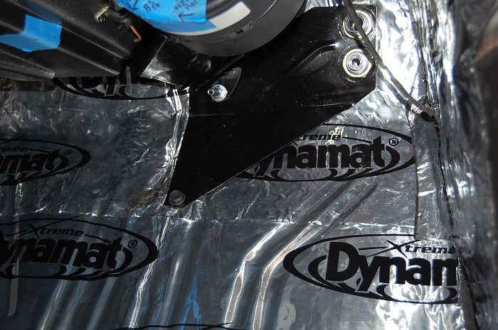

if your already painted find a spot where you can bridge from to create a mount. Theres a spot between the firewall and floor pan where the subframe bushing support that you can weld to. Will not be visible from the engine side.
This car I made a bracket that used the bulkhead mount and a bolt at the frame bushing reinforcment to support the evaporater. The stud was welded to the plate. Turned out to be overkill but kept the firewall clear.
