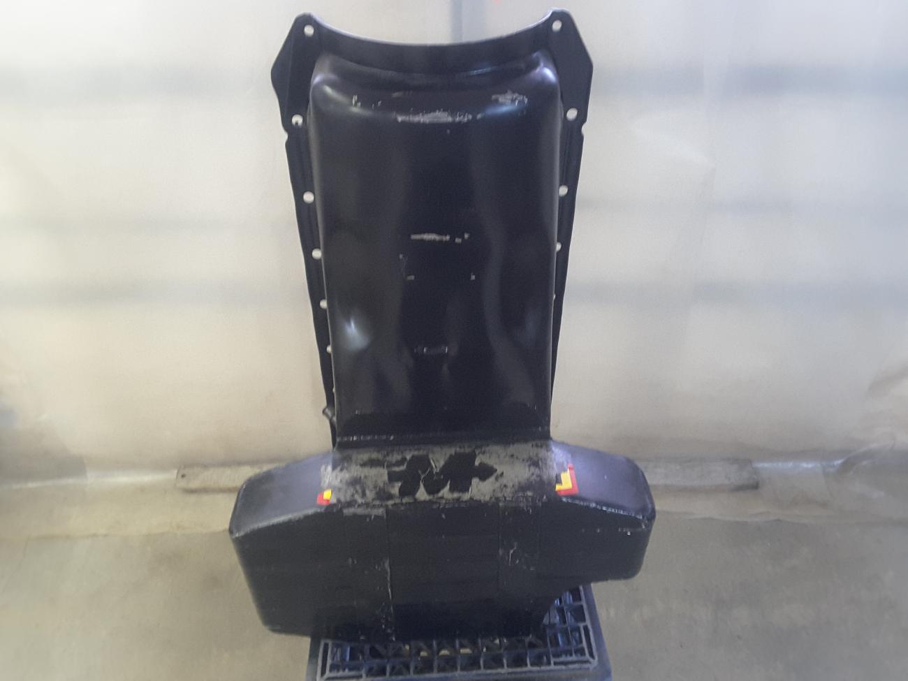

For the guys here running a BB, probably not many! What oil pan are you using? With our suspension modifications can we corner hard enough that a stock pan is not sufficient ? I picked up a decent Milodon Pro Touring/Road Race pan. As usual Murphy's Law is consistent. My drivers side header seriously interferes with the kick out. Only 1 3/4" tube diameter. Was hoping to sell, it but no luck so far.

Milidon 30955 oil pan is what I used on a 572ci BBC in a 68 Camaro.
Fitment with 2” primaries is perfect.
It has kickouts but less aggressive than your pan.
I hammer this car via autocross and spirited driving without a single oil pressure drop.
Another option could be to cut your pan and reweld more clearance.
