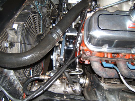

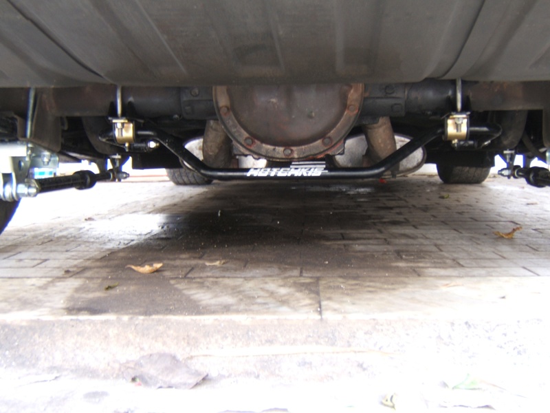

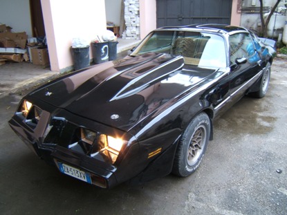

Here's a few pics of the ticket-getter so I can show you how much work still needs to be done!!
Some stuff it now has:
Hotchkis TVS
American grafitti AC delete
March PS pump & pulleys
AGR Steering box 12:1:1
Pro-Form alum valve covers
Not shown but on car now: Boyd Coddington 18" wheels, TKO 600 tranny

Looks good!! I have allways liked 79-81 face of the transam!
How was the manual swap? Was it originally manual car ?
