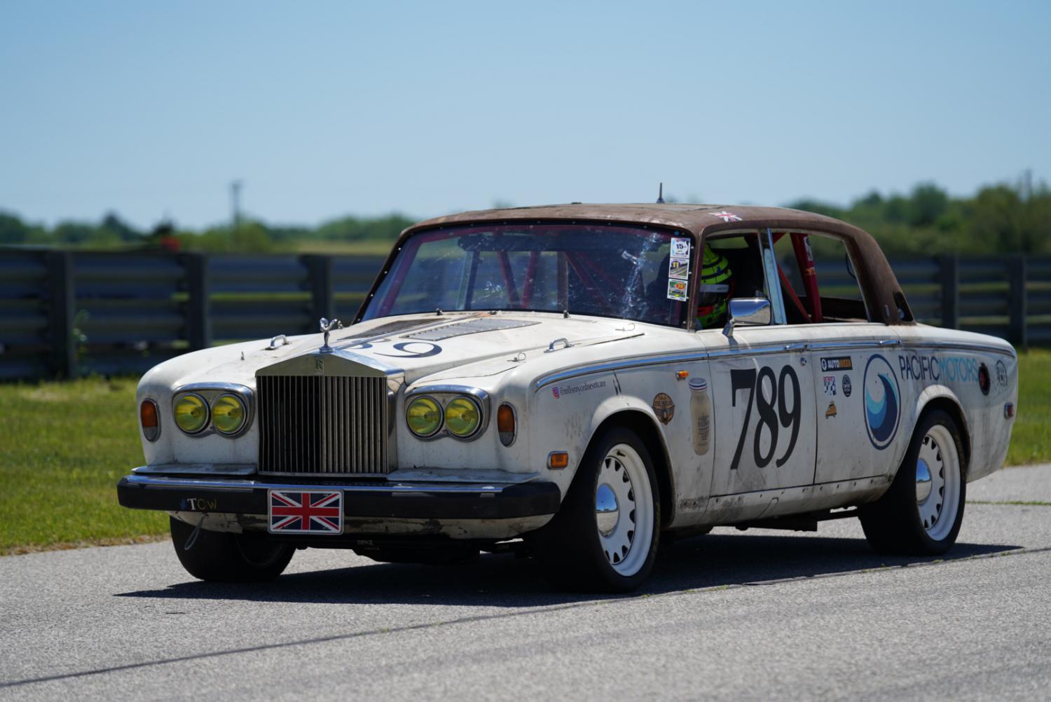

Hey guys!
Got a bit of a weird situation here.
We race a viper powered/BMW DCT 1977 Rolls Royce silver shadow and it has a 2nd gen F-body front subframe in it.
custom coil jack upper coilover mount
upper adjustable control arm
extended upper ball joint
CCP unit bearing hub knuckle with C6 Z06 Hub/Brakes/Rotors
Lower tubular control arms with extended ball joint
heim TRE
I got the opportunity to buy 5 sets of forgeline race wheels for a really good deal,but they are all 18x12's with 6.5" backspace.
I'm trying to run these in the front and hitting the upper ball joint. Would be nice to get them sucked in since the tire is so wide to eliminate the need for flares.
Just checking in to see if anyone has any thoughts/ideas on how to make it all work and not kill suspension geometry.
Anyone know if there is a 2nd gen F-Body drop spindle that uses the Corvette hubs? I know CCP makes one for the first gen, but I didn't see it for the 2nd gen.
Any other knuckle options out there, or any other thoughts?
Thanks!
