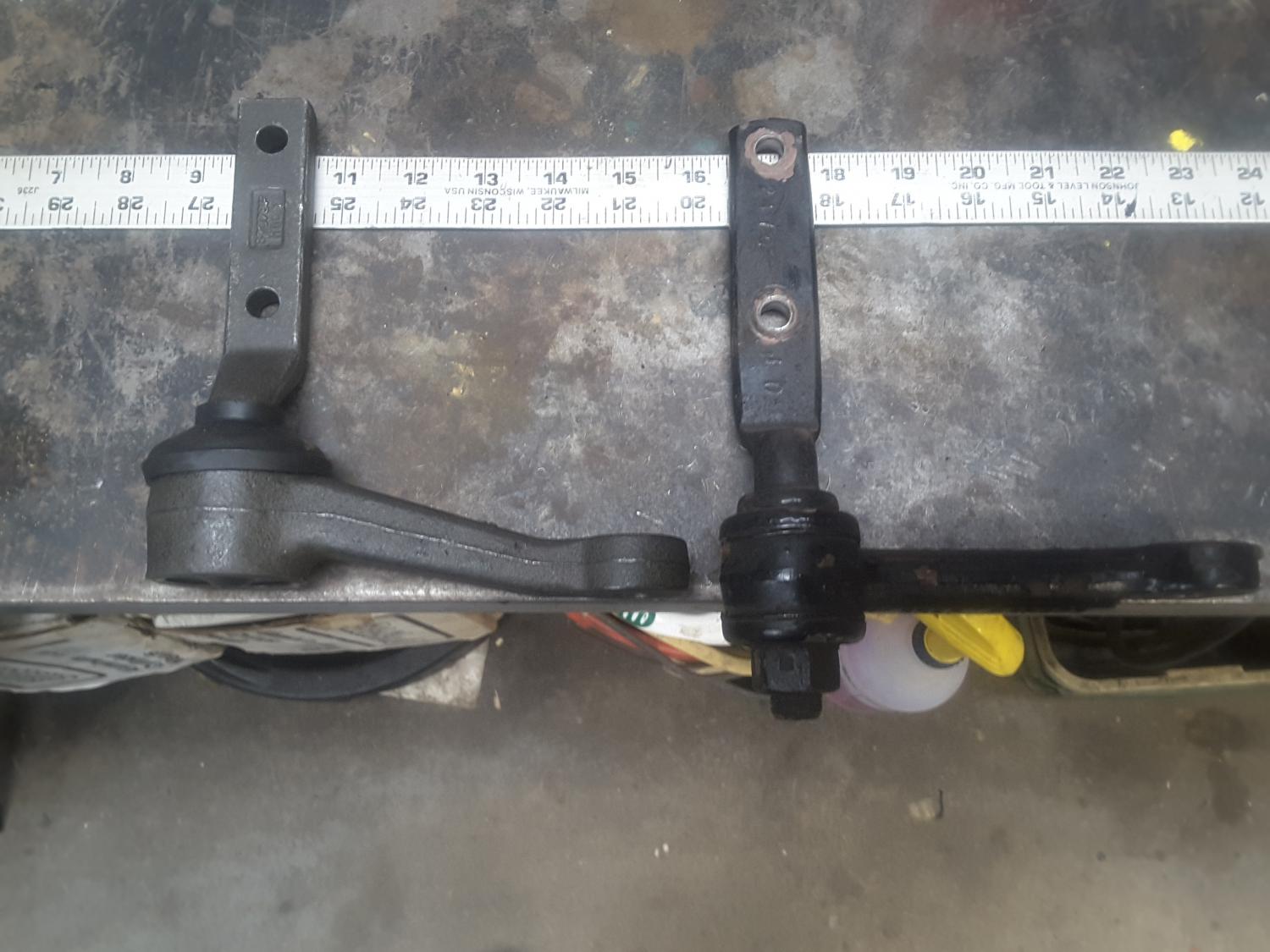

Been very busy, only have had a few hours a week to work on the Chevelle. Steering box, colum, and wheel, belive I have all centered. The Idler arm wasn't greasable and hitting the sway bar. Picked up a Snapa premium, swap it out before setting the toe. Considerable difference here! Anybody have an idea what, if any ramifications, this may cause?
