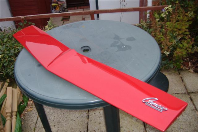

Knowing how you guys like pics of work in progress, here's a few of my '69 Camaro taken a while ago. The body is in pretty good condition really & as parts for it are hard to come by in the UK & the repro stuff doesn't fit too well anyway without a lot of work, I decided to repair all of the original sheet metalwork rather than buy in new. The bottom of the o/s front fender was a bit rusted so I cut it all out & replaced it with new sheet steel, the front of the fender also had a bit of tin worm so that was also replaced. The pics were taken before final metal shaping. As the shell wasn't at the 'shop, I decided to tack weld the fender to the door to align everything up prior to final repairs & it now fits perfectly & is primed ready for paint.

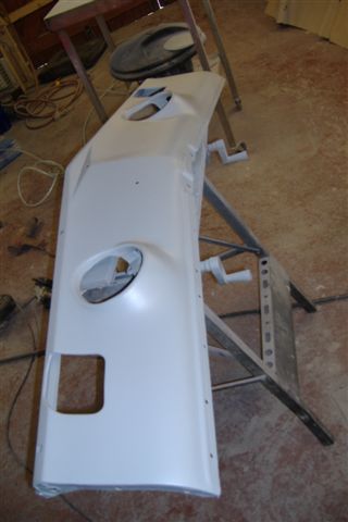

Posts: 469
Primed & ready to fit

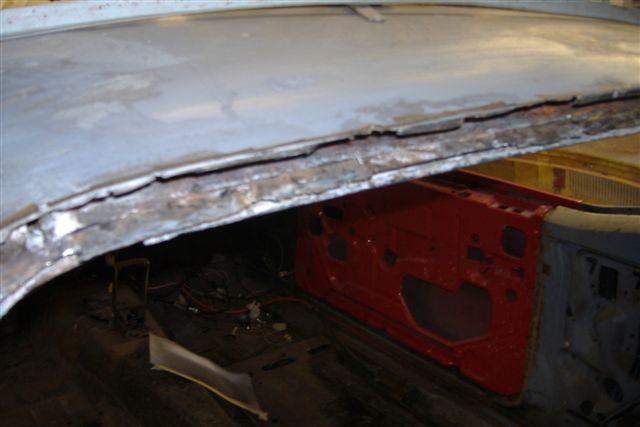

Posts: 469
Here's a close up of the rusty holes around the rear screen aperture. Because it's hard to get body panels here in Britain I decided to cut it all out & weld in new steel.

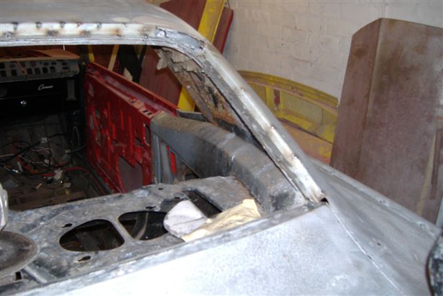

Posts: 469
here's the new formed steel being tacked into place.

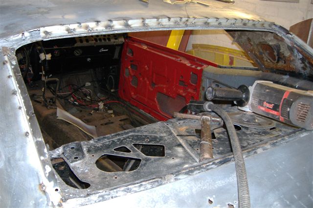

Old 05-09-2007, 10:53 AM
evilzee28 evilzee28 is offline
Posts: 469
All seam welded up ready for the lead loading/body soldering.
