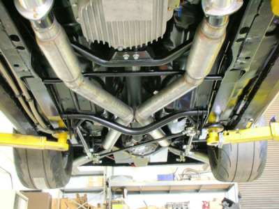

Hey guys I am getting ready to finish up my 69 and need to order an exhaust, but I was concerned with the fit with my setup which is as follows..
69 camaro lowered in the rear with DSE 3" drop springs (mini tubbed)
front 427 BB with hooker super comps lowered with QA1's.
Do you think this system with fit with no issues??? I hate to cut up a nice stainless system if I could get something else that would fit better.
thanks
justin

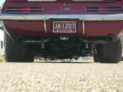

check these pics out of 69 we just finished...car sits pretty low and it has DSE mini's with ladder bar suspension...
hooker super comps, the mufflers are dynamax bullets and 3" all the way back.
I just ordered up some 3" mandrel bends some striaght tubing and went at it...took me two solid 8 hr days.....
