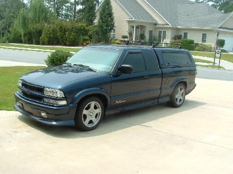

Rhino; Do a search on any S10 forum for hydroboost and you'll have more info than you want. I've built a pro touring type '00 S10 Xtreme with an LS1 motor. I'm using LE1 front discs ('00 up Camaro 12") and calipers. I'm also using a '02 8.8 Ford Explorer rear complete with discs. The Xtreme uses the ZQ8 option suspension, MC, and proportioning valve. It will put your teeth out on the dash real quick. I hope that helps....Jim PS this pic was last year before the Hydroboost was installed. I'm going out this weekend to buy another camera and with post the swap then.
