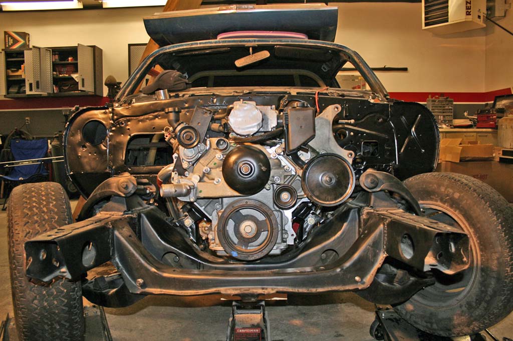

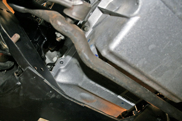

F body pan pits 1rst gen or sec gen camaro/nova without cutting oil pan or firewall. 1rst pic is full lock right second pic is full lock left. any body else have a set up were they use stock f body pan
