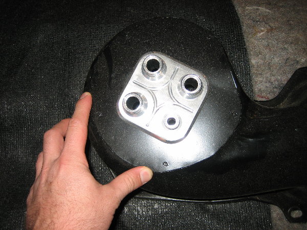

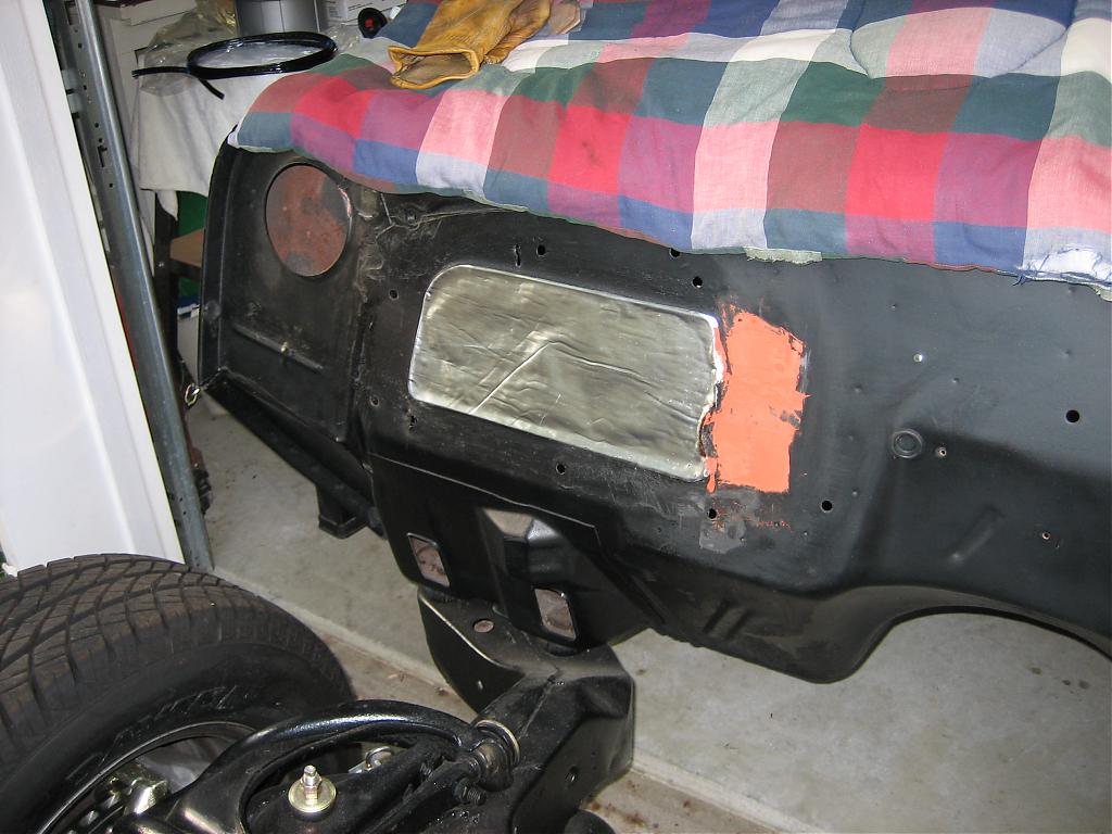

I did something similar with my '65, although I welded up the holes for the heater lines and ran all 4 lines under the passenger fender. I don't see why you couldn't run the heater hoses through the original holes and the AC lines under the fender. One of those 2-line bulkheads might help with cleanliness there.
On mine, I bought the square 4-line bulkhead and fabbed a plate to mount where the original blower motor went. I then cut a hole in the kickpanel to pass the lines through. It's not all hooked up just yet, but it allowed me to use the original heater box, which was part of my goal.

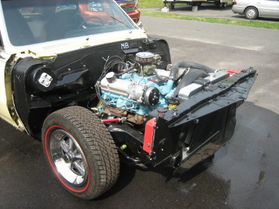

I'm using a Gen II supercooler kit with a 14x24 condenser. These pics are about 2yrs old, but right now they're all I've got. First pic shows the factory heater hose holes welded up and getting prepped with bondo. Pic 2 is looking through the blower motor hole to see the hole I cut in the kickpanel area. Pic 3 is the bulkead and plate that I fabbed. Last pic is kinda hard to see, but you get the idea how it turned out and how the lines will run under the fender.
