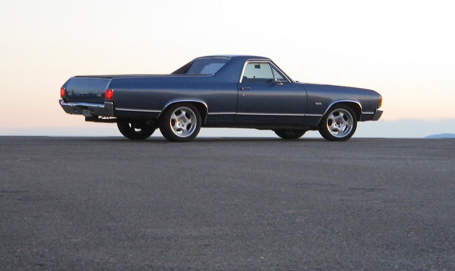

I have "Rondell"-wheels ,17" x 8-1/2 on My El Camino.
BMW M5 ,replicas.
Work just fine for a daily driver.

nice Elky you got there so like GBody said, did you have to drill out the holes anymore also? or did they fit just fine with the hubcentric rings?

There were no hubcentric rings with the wheels ,when I bought the car.
Just conical lug nuts.
Worked well.No vibrations.
IMO ,hubcentric rings should be used,for safety.
Now I have changed the wheels to Olds SST 4-3/4 boltpattern.
Looks good too, on the Elky!
