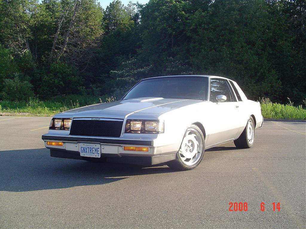

Hi guys ,finally got some pictures up. Sorry about the quality but i'm not great with the computer....Anyway
this is my 84 limited that was originally green with vinyl roof. I started building it last october, and with the help of
my friend Tony, built a fun car for not a whole lot of money. the 305 3 spd auto was pulled, and convetered to a
91 L98 corvette motor . I installed a flat tappet circle track cam, and a victor jr with 650 race demon. It breathes through
long tubes and a X pipe from a fox body mustang (easy to fit!) and single chamber mufflers. Sound horny! Its backed
by a third gen fbody T5 5spd ,I also used the pedal assembly and hydraulics from the fcar. The rear is the little 7.5
with 3:73 gears from a blazer and an auburn posi unit.The wheels I traded my GTA trans am wheels for, they are off
a 93 vette. Kennedy Auto Collision painted the car in chrysler PS2 silver (the paint code off my minivan),after we
welded up all the holes from the vinly top and chrome limited trim.....(lots of holes!!)The suspension rides on KYB
shocks and A monte carlo ss front sway bar with urathane bushings ,with a factory rear sway bar. The coils are the
worn out originals hacked several times with a cut off wheel..he he Budget remember. Of course there are a million
other things the car needs, and hopefully I'll be able to do them in the future. As i'm sure you guys know...I'm probably
not the only guy on here with a budget and family that comes first. Not everyone can afford those 18x12 Fikse wheels!!It can be tough cutting corners to meet your goal, but if you built it yourself and enjoy it ,BE PROUD OF IT!!!!!

Thats awesome, love me soem budget builds and on top of that its a g-body. What kind of spacers are you using to fit those wheels?
2 5/16 " all the way around.
