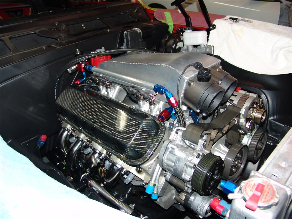

I was wondering if anyone had a source for fuel injector booties, or what the correct name for them is so that I can look for some. Here is a picture of what I am refering to... Red Witch

what part of the pic are you referring to? The injector connectors for the wiring?

I am looking for the rubber boot that covers the pigtail and some of the wires. It may just be some heat shrink, but I was wondering if there was a pre-made one.
I thought that was heat shrink. I've never seen them before.

deuce_454's Avatar
Join Date: May 2006
Location: Copenhagen, Denmark
Posts: 1,612
the boots come with the connector if you buy them from bosch... atleast they do around here....

Default Injector Boot
Those are the Bosch-style long boots. The good news is that they are available at your local Napa, or any Echlin dealer. They are made for the Bosch connector with the hooked lip, but good for us is that 80% of top-feed injectors are setup that way. Even without the lip, the boots still hang on to most injectors. Here's a link to them @ Napa:
http://www.napaonline.com/NOLPPSE/(S...414_0000999999

That's a cool little item to know about. I was just going to chime in to say that early tuned port cars had something similar on the harness to cover the injector connector. My IROC had them on the factory harness (87) when I pulled the 305.
