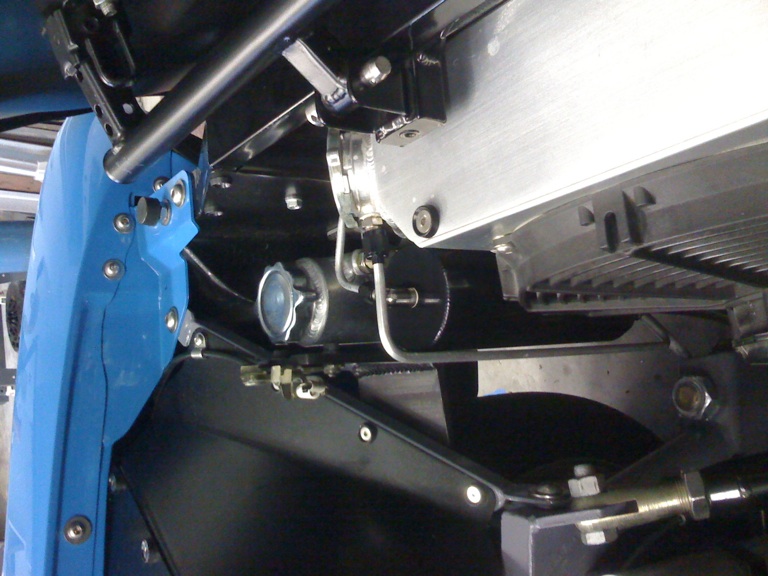

Got a picture of that?

I'll post one up. I did the modifications myself to the Turn One pump to convert from the plastic reservoir to an AN10 o-ring setup.
It was just some drill and tap stuff. Easier than it sounds.

Here's a picture of the Woodward reservoir:

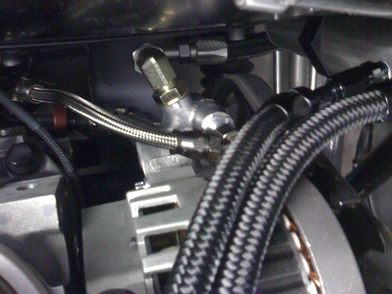

Posts: 659
Here's a pic of the pump and fitting:
