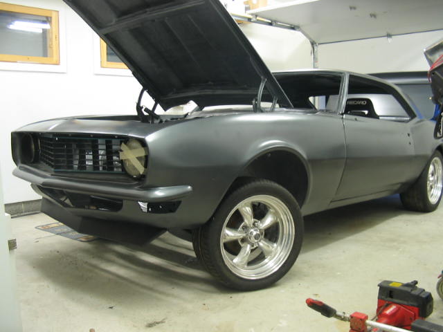

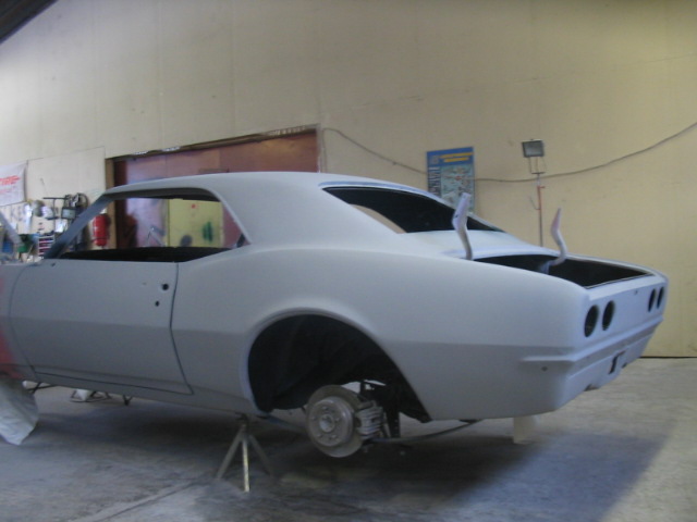

this is my 68 project.

that looks really good any more info on it?

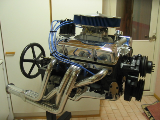

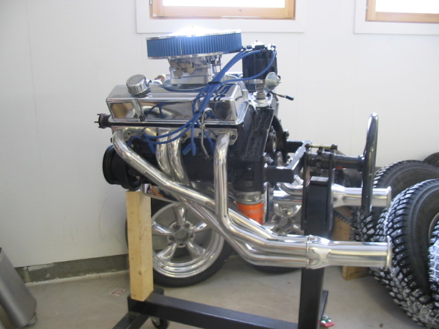

engin is 350,4bolt main, 0.30 oversize, iron heads,ceramic coated hedman husler hedders 1 3/4" primaries,about 420hp??

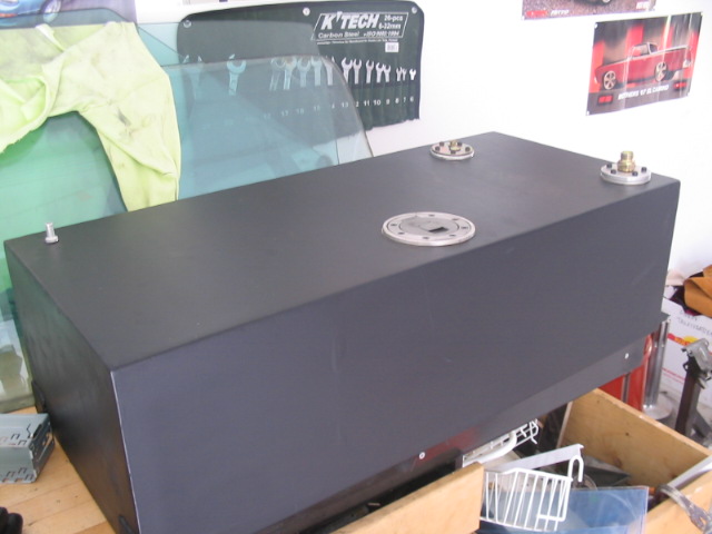

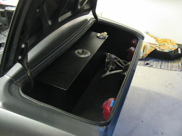

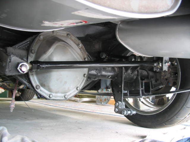

transmission is th-350 rebuild with tci pro super kit. rear axle 12bolt+lock.fuel cell is home made aluminium 25gal.

The 69 grille is really cool. I have always wondered how much work it would be to do that?
Good work !

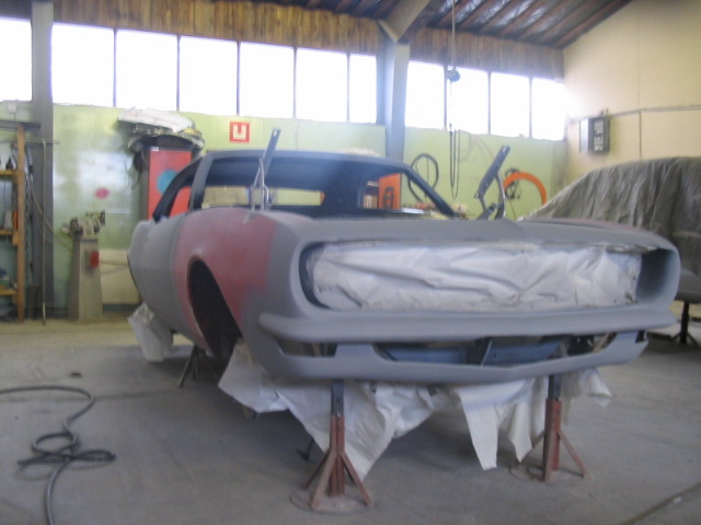

The front of that 68 is interesting do you have any more pics of it.
Looks like a 69 grill and a 70-73 front lower valance.

it is 69 grill and my home made front lower valance.

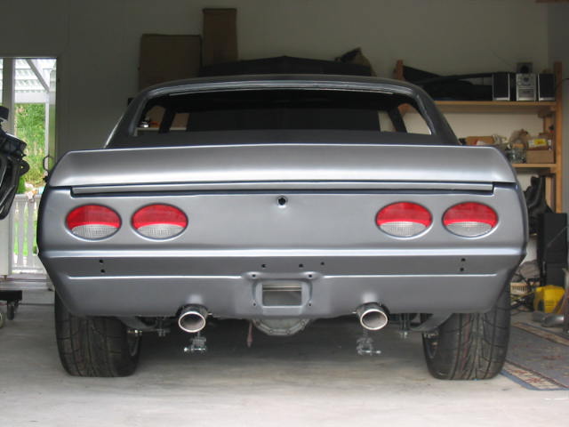

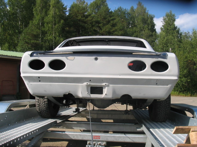

Vey nice. I love the tail lights. Thats why I went with a 73 camaro was for the circle lights in the back. Keep us posted.
