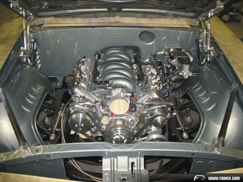

ok, with out making this to complicated. I need some help running my fuel lines. I have a standard 1998 LS1 Set up. I will be using a single line fuel filter like the one below. Do I need a regulator some where or is that the thing that is on my factory fuel rail?

The filter you are using has an internal regulator.

Thanks Mike, so all I have to do is run my single fuel line to the motor correct?

Can I get the line allready made or do I make them myself? Where is the best place to get everything?

I bought my fuel line from http://www.tubetechweb.com/67-69camarofuellines.html I bought the dual one for my LT1 setup, but this gives you another option. They do alot of work for Street and Performance, their customer service was very good. Very nice product and it fit like a glove.

Check with an expert but I believe Fuel injected cars use a return fuel line also. Just a heads up

they do, but the late model LS cars usually bypass at the rear off the fuel filter and only have one line going forward to the engine. That's how his car is set up.
