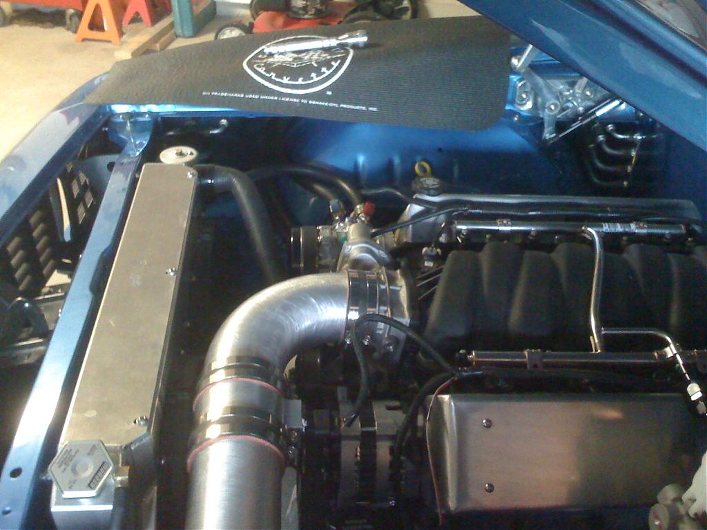

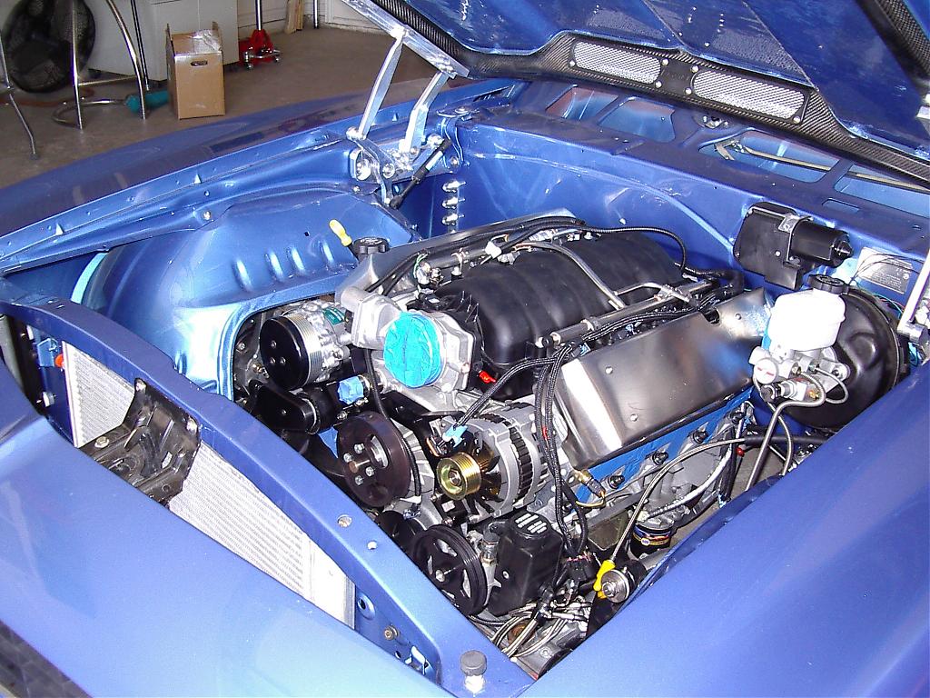

VA Front runner set up. Made condenser brackets out of flat aluminum stock. Aluminum stocl bolts to core support and condensor bolts to aluminum stock. Just made an angle bracket for drier under pass quarter.
Only have a few pics. Sorry that they suck and don't show much.
