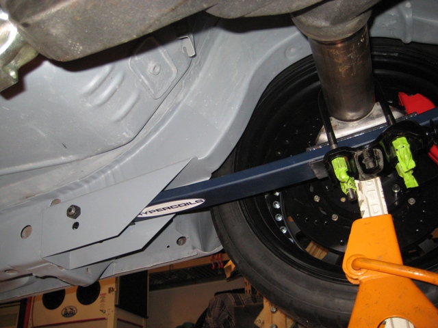

Okay folks, the mock up has raised another question... I'm feeling "needy" right now
Background: 70 Dodge Charger, Moser 60, Tubbed, "planned" to use Hypercoil leafs.

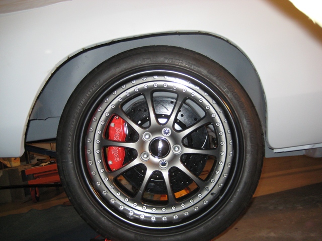

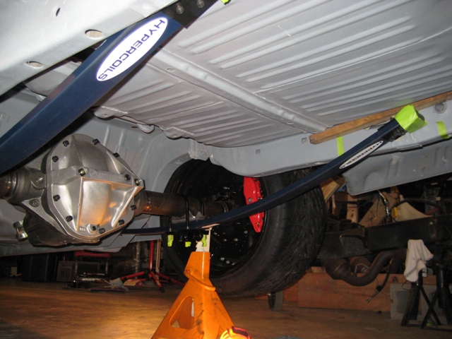

My problem is I can not get the ride height correct. I need to lower it another 2.5 to 3" in the rear and I don't think I am going to get the leafs to work out. I went as far as to attach the front of the leaf to the lowest ride height whole and rest the back side on the trunk floor - even loaded ~300lbs in the trunk. No dice. See the first pic - the wheel well lip needs to come down to the top of the Forgeline Wheel lip. Obviously 3" lower blocks ain't gonna work. My clever daughter said "Dad why don't you just flip the leafs upside down so they bow up and not down?"
I am looking for suggestions on what to do next. I have *zero* issue modifying the suspension/floors/etc. I think I need to go to a 3 or 4 link system with coilovers.
Let me hear your suggestions as well as vendors that offer something to address this need for a 70 Mopar B-body. I'll make everything if I have to...

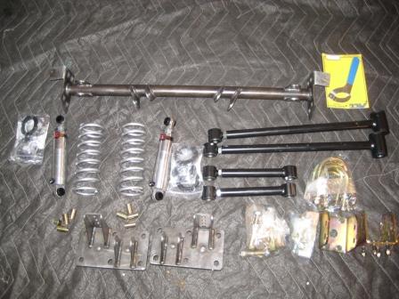

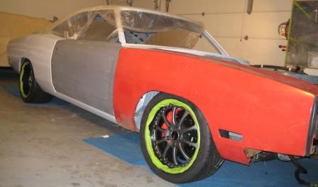

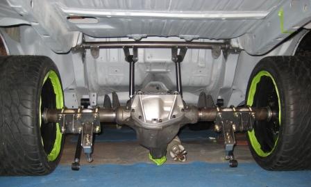

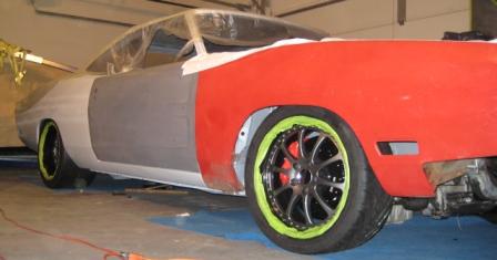

Thumbs up Update - 70 Charger rear suspension

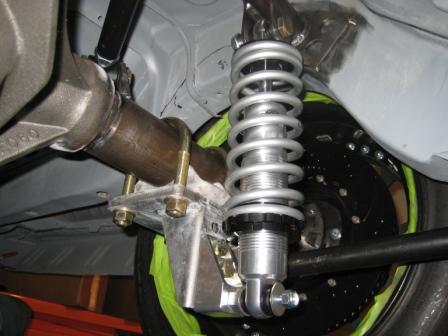

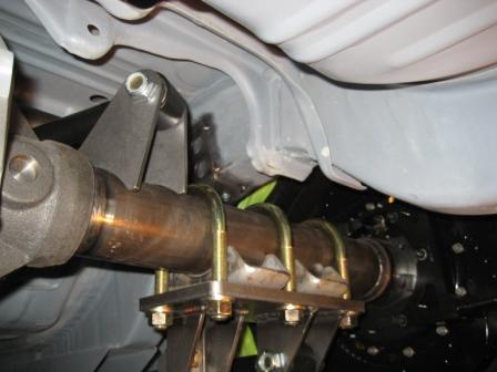

Thought I'd give everyone an update on the direction I took for the rear suspension. I spoke with Bill Reilly at RMS and went ahead and stepped up to his Street-Lynx triangulated four link system. I figured I have poured so much $ in this project thus far - why cheap out on the rear suspension?
Bill's kit was extremely easy to install, excellent fit and engineering, and very beefy. His customer service and willingness to answer questions is outstanding. Now I have the luxury of additional adjustability in the rear
As it sits now in the pics, I can lower it another 2" and still have 4" of suspension travel. I do need to modify the floor a bit to clear the Moser 60 pinion snubber, if I want to drop it that much (2" plus 4" max squat). Should be no problem. I'll also need to notch the rear frame rails a bit for clearance when I install the rebound bumpers. By a stroke of luck - or perhaps clever forethought, I had already boxed in my frame rails when I replaced the floors.
