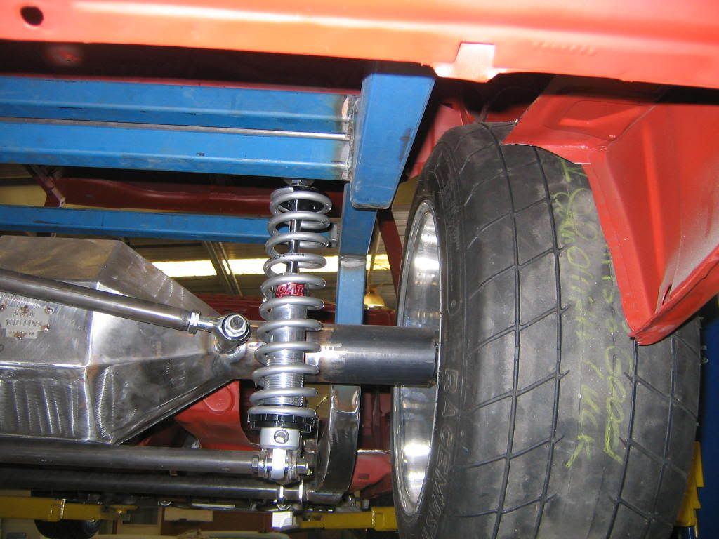

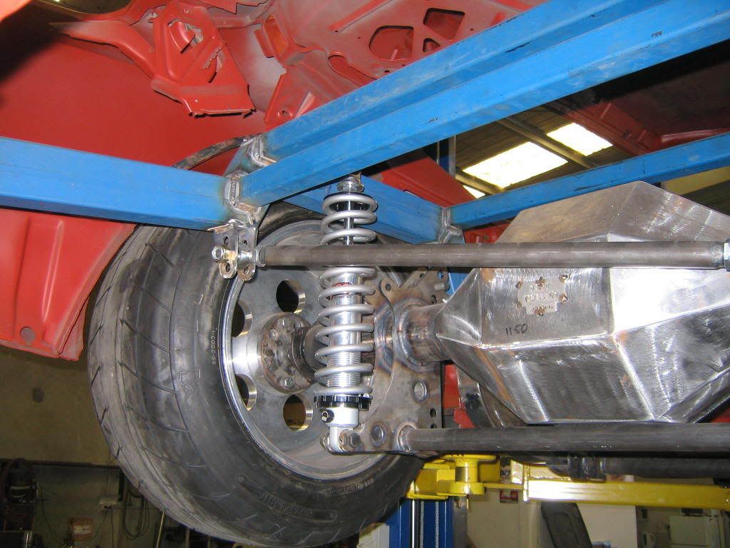

I don't have a lot of great shots of mine, but here they are anyway
4 Link with panhard. It could be a a longer panhard although that means moving the shock, either way sideways movement will happen but it should be OK.
