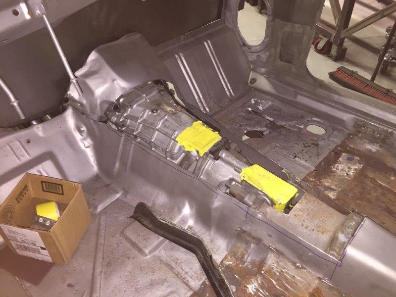

The car looked clean on the outside but as many of you know once we looked at the car it was another story. The trunk was all rusted but I couldn't tell because someone had welded a new trunk over the rusted one. I really thought I had looked it all over

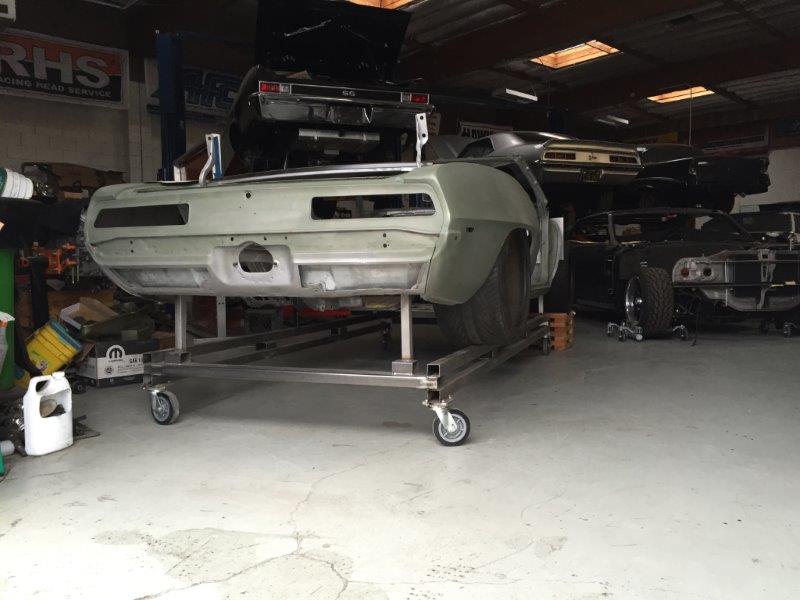

So needless to say we needed a new trunk. But we also found issues in several other places once we media blasted it. As a normal car lover and not someone in the business its crazy to how a car can look pretty decent with paint and body filler. But when you media blast it you see the floor, doors, trunk, area where the top goes down are just awful. So here are a few pics of some of the work.

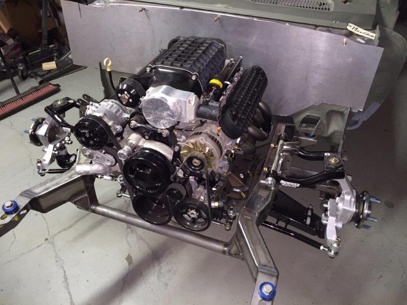

So we need to do a full floor on the car but while its opened up we can work on tucking tires and fitting engine, and brakes on my new speedtech extreme sub-frame.
