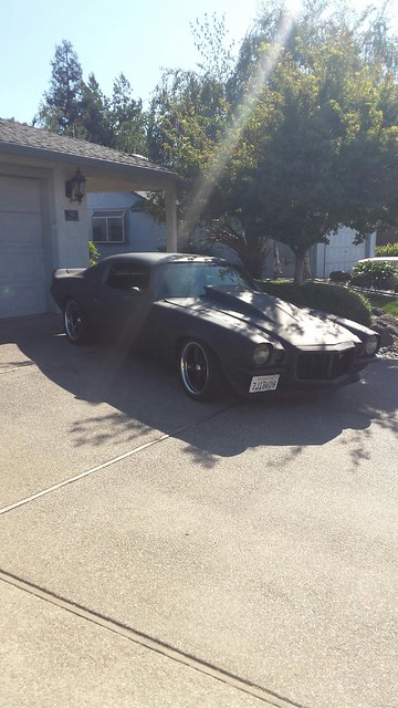

Welcome to my 73 Camaro build. I have been a member of the site for 10 years now (!), and finally have some progress worth putting into words. I have loved the idea of pro-touring cars since I first heard about them, and have always loved 2nd gen Camaros, and now I have the opportunity to start building my own "dream" car.
There are a lot of beautiful cars on this site, and this isn't one of them. I really just want a car that I can get in and drive to work in the morning, or take to the store, or drive back to my parent's house in CA without worrying about reliability, mileage, comfort, etc...
It took 3 years, but I just completed my first 400 mile weekend road trip so I know I'm on my way to my goal. The car rode rough, was clunky and rattled, and pretty hot, but all of that can be addressed down the road.
So starting from the start, I found the car on Craigslist, sent my dad and brother to look at it, they thought it looked good enough and bought it.

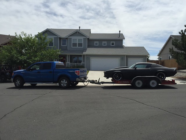

I drove down the hill and loaded the car up and brought it up to its new home in Reno.

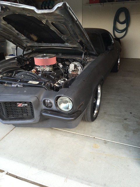

The car is rough, the quarters need to be replaced, none of the panels are perfectly straight, the wiring was a mess, it's way too low, etc... But it ran and drove ok, so I started patching up some of the issues and doing some basic things to it over the first winter that I had it while driving it around town occasionally.

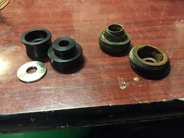

DSE subframe connectors, DSE subframe bushings, put some RX8 seats in it that are actually bolted to the floor, fixed some wiring, and did some maintenance type stuff like control arm bushings, brakes, new steering box and rebuilt column. Then just drove it occasionally. It ran pretty rich in the altitude here and I never felt like smelling like gas all day at work so the driving was limited. Even then, reliability was iffy including a water pump that sprung a leak 20 miles from home.

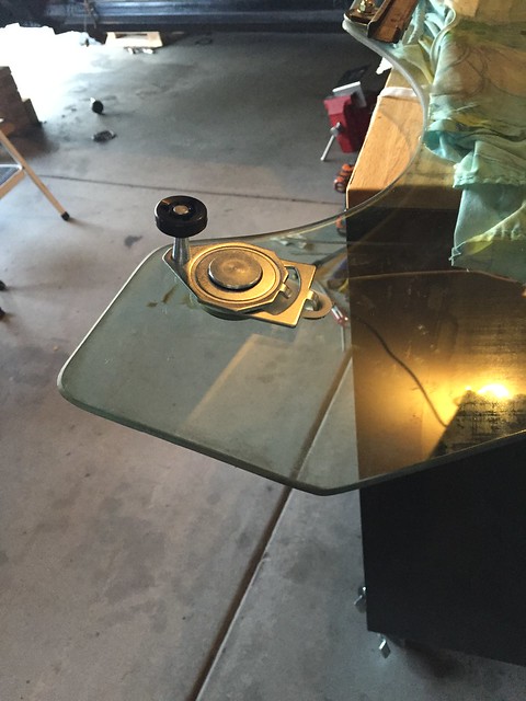

Pulled the doors apart for new hinges and window parts. Cleaned up all the tracks and put new rollers on the glass. Still not happy with the window adjustments and weatherstrip fitment.

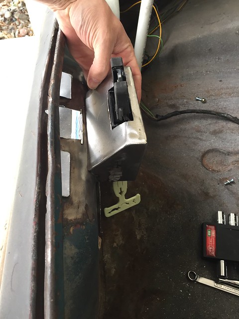

Somehow the trunk latch had been broken, and there was no key for it. So I put an electric trunk latch in its place.

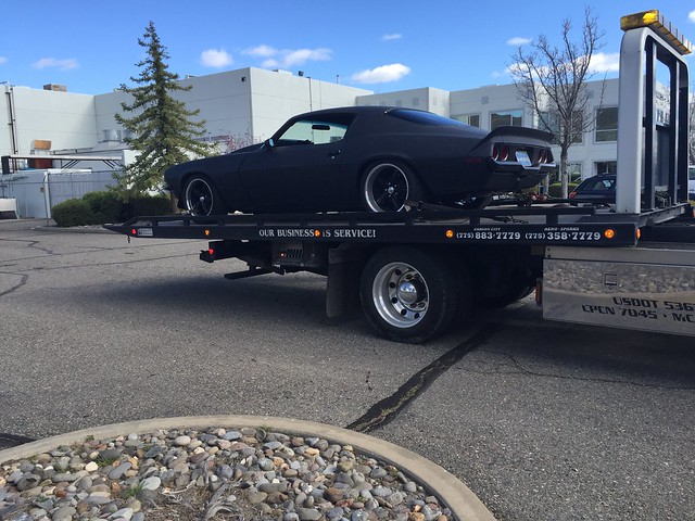

And the free ride home courtesy of AAA

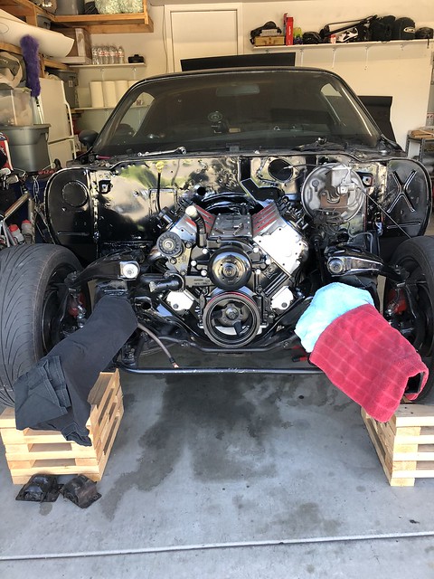

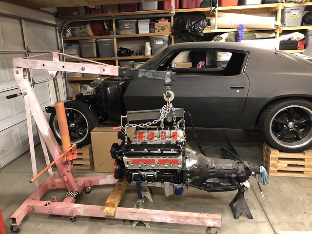

Family, house, savings, etc... all come first, and being the single source of income for the family I kept spending on the car to a minimum. With nothing pressing to spend my bonus from 2017 on I was able to put some of it towards the car. I have wanted to put an LS in a 2nd gen forever and now I had the chance.

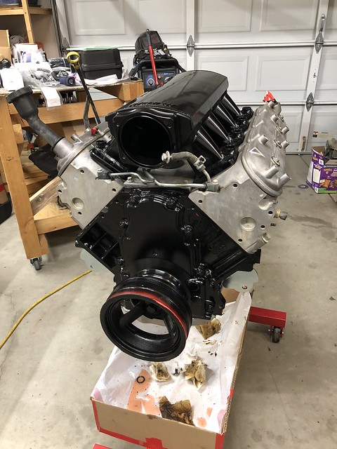

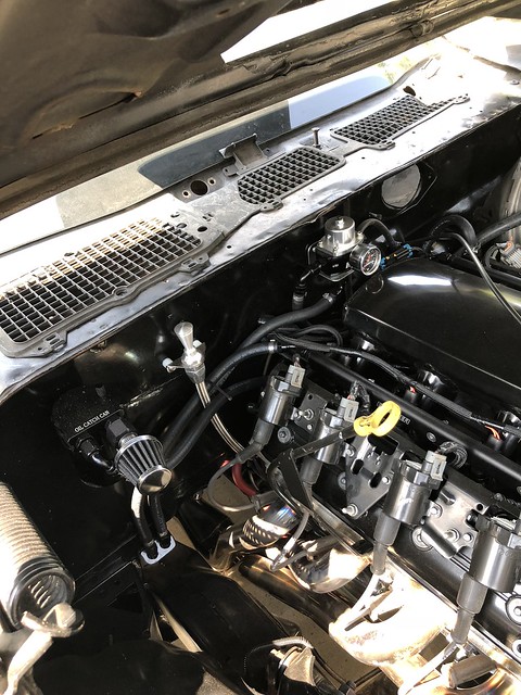

I picked up a 5.3L pullout, FiTech Ultimate LS system, Tanks Inc fuel injection tank, and got to work. This is very basic swap by now so I will spare the details, but please feel free to ask about anything if you want more info.
IMG_2448 by Mike F, on Flickr
Stripped down and cleaned up. Holley oil pan and FiTech intake.

I kept the TH350 for now, T56 is the next big project.
IMG_2557 by Mike F, on Flickr

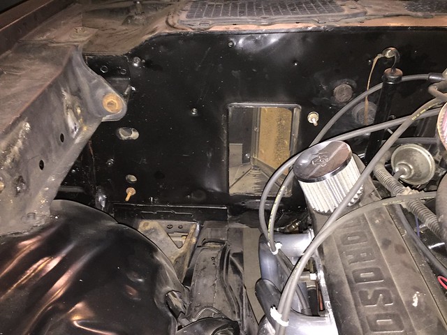

Cleaned up the firewall a bit, mostly just welded all the holes shut.

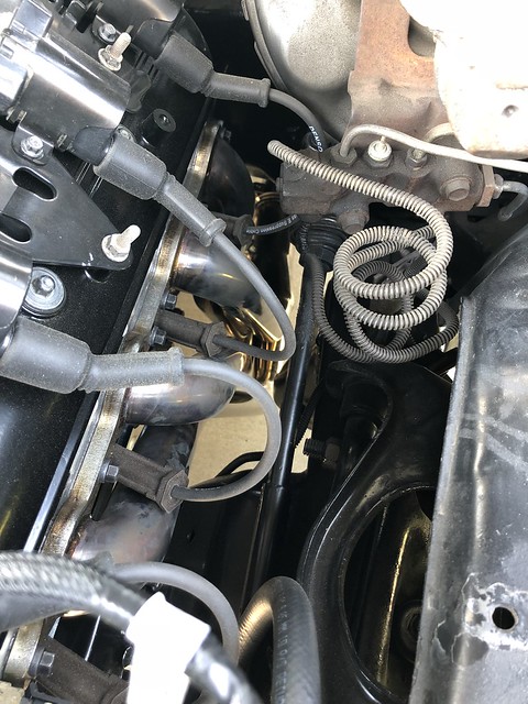

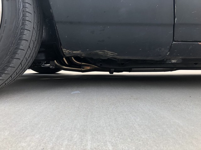

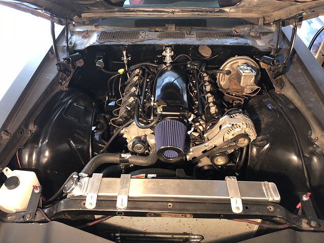

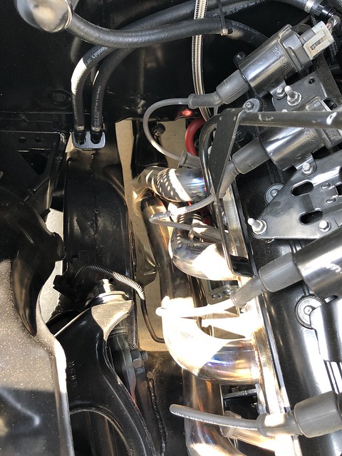

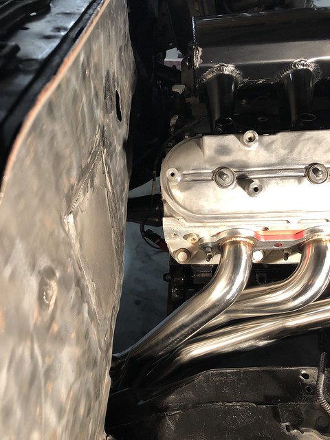

And then it was in. I bought Speed Engineering headers for $190 that fit pretty good between the frame rails. The passenger side O2 bung won't work as it would hit the floor, but the driver side fits good. They hang a little low but for the price I can deal with them.

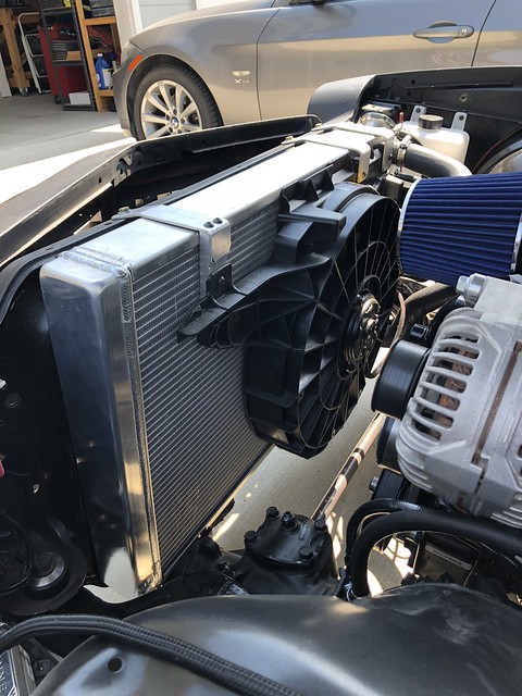

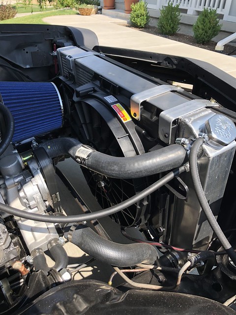

Griffin dual pass radiator and C6 fan. I'll build a shroud for this later, and I'd like to get it PWM somehow. This has kept the car cool in the 105* heat without a problem. Runs right at 197* when moving, fan kicks on at 205* and it never goes any higher.

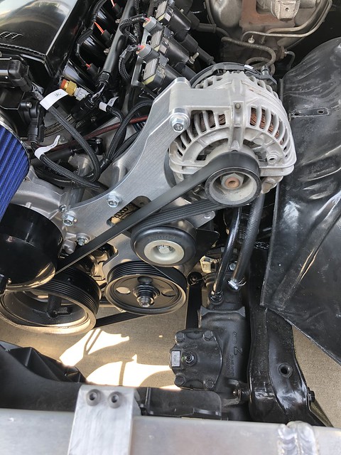

Speed Engineering bracket for PS and Alt, I bought this hoping to use all of the truck accessories, then needed to switch to a LS1 water pump due to intake clearance.

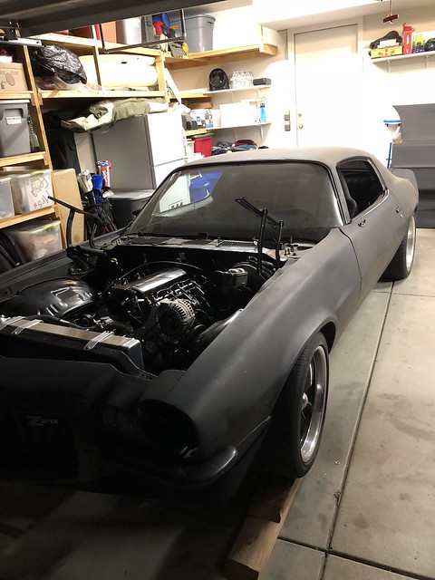

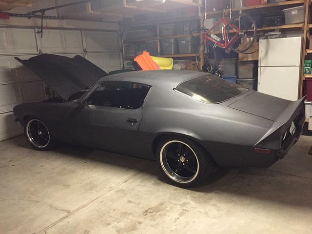

After working through some tuning issues and putting a couple hundred miles on it, I drove it back to my hometown for a local car show. Car ran great and, even with the th350, I calculated 18mpg round trip.
So the car will be like this for a couple years likely while I save for a T56.
