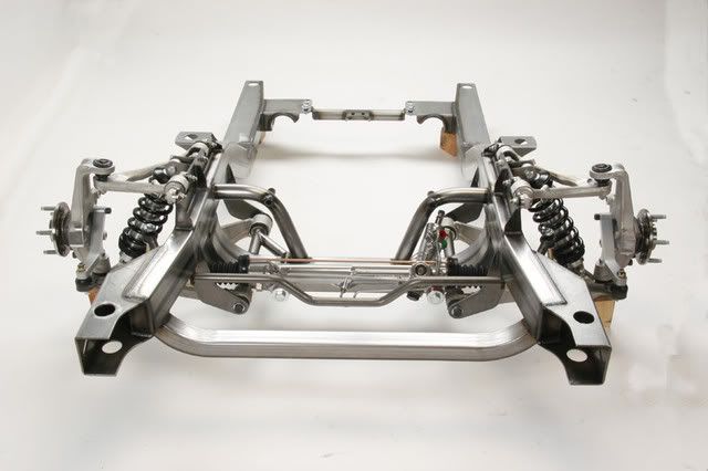

suspension- front- art morrison front clip
rear - chris alston g-link with fab 9 housing and moser internals

and the front clip that will soon be here woo hoo
