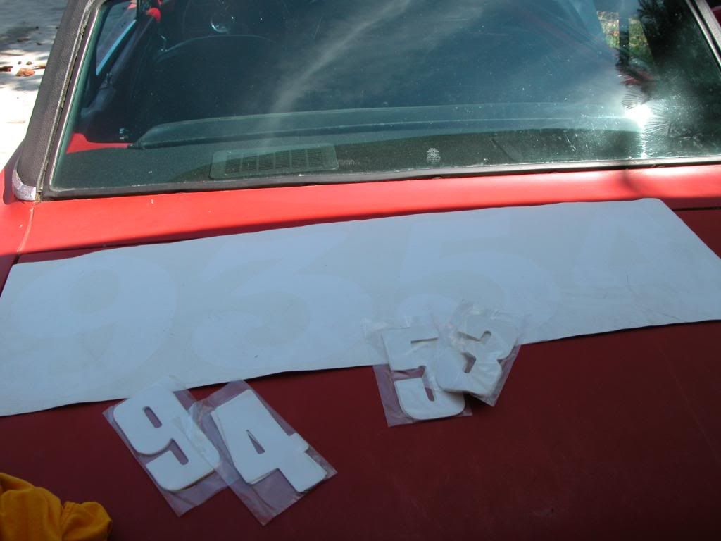

Here's a sticker I'm about to install. The stickers are sandwiched between 2 sheets of special paper. The small numbers are regular stickers for the front and rear windows at this particular event. Different organizations have different requirements and if you don't follow them they'll put the shoe polish wherever they require the numbers to be for their event.

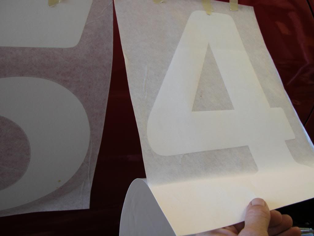

Use some automotive masking tape to get the sticker in the position you want as shown in the pic below. Stand back a ways from the car and look at it to see if you like the positioning. Move as necessary and then use several pieces of tape over each number to hold the top of the sticker. Then cut the sticker between the numbers. It's harder to try and apply all of the numbers at the same time so why try if you don't need to? The tape you put above each number will keep them all in line.

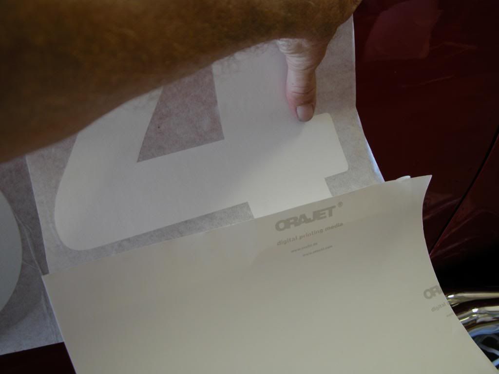

Then remove the top of the backing from one of the numbers. Do not take it all the way off because it adds rigidity to the bottom of the sticker as you smooth the number on to the car with your thumb by going back and forth to prevent bubbles.
Once all of the numbers are on the car peel one corner of the paper then slowly and gently peel it off till you get to the number. Keep a very tight angle when you peel off the area where the number is almost folding it back on itself. If you pull it straight out from the car it might peel corners on the numbers and stretch the vinyl.
