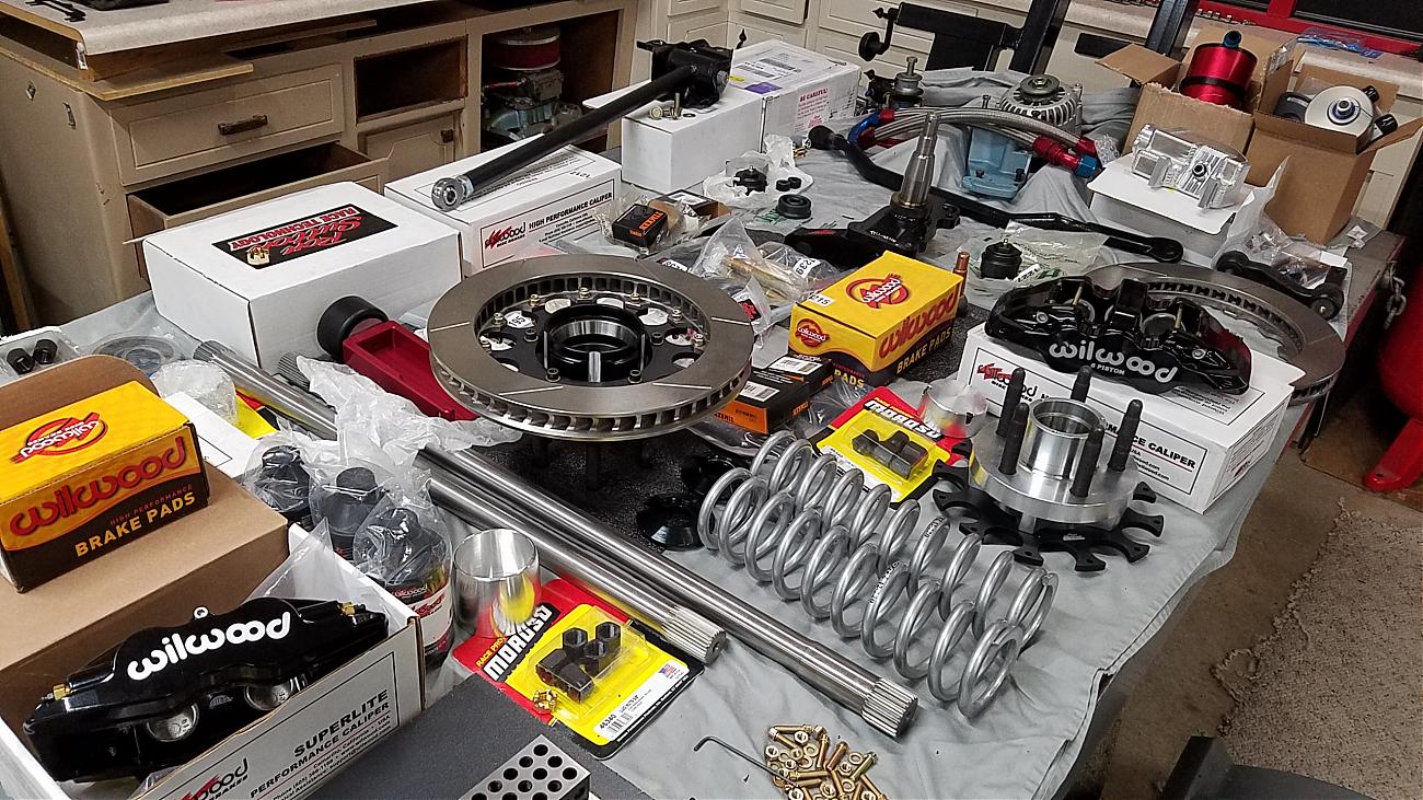

I bought a used DSE super tank that will allow me to actually turn the car without starving the engine. This will also allow me to remove my return line and regulator which will simplify things nicely.
I purchased a Speedway Engineering Grand National floater and have that mocked up already I also came upon a Schroeder rear sway bar that is going to work great after I attach a mounting tube to the four link cradle and install the tabs on the axle housing. Of course because I went with the 13 inch rotors on the rear, I had to upgrade the fronts too!
The front is going to have 14 inch rotors with 6 piston aero calipers, Ron's fabricated spindles with adjustable steering arms and custom hubs. Gone is the 1 1/8 front sway bar in it's place will be a splined 3 piece bar with diameter TBD.

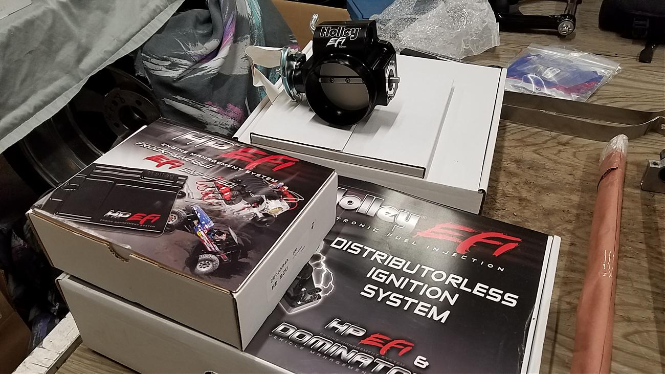

During my "down time" I also acquired a Holley HP computer complete with DIS and a new throttle body to upgrade my commander 950. See, not being in the shop can get expensive, so I need to get back out there.

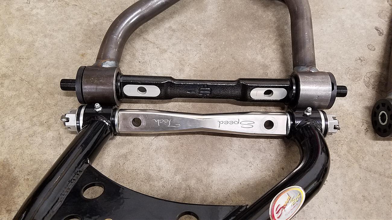

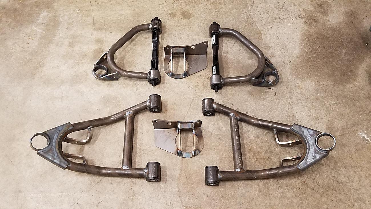

After this year's workshop at Ridetech, Ron says "come look at this". Oh crap, this is going to cost me. So today I received my Ron Sutton track control arms. these are designed with big time caster while centering the wheel, screw in ball joints, beefy cross shaft with slugs, improved motion ratio and true eye to eye coilover mounts. These are definitely not bolt in, as they come uncoated and no sway bar tabs. the frame also needs to be clearanced and a top shock bracket needs to be mounted on top of the frame but this is exactly what I needed(ok what I wanted).
