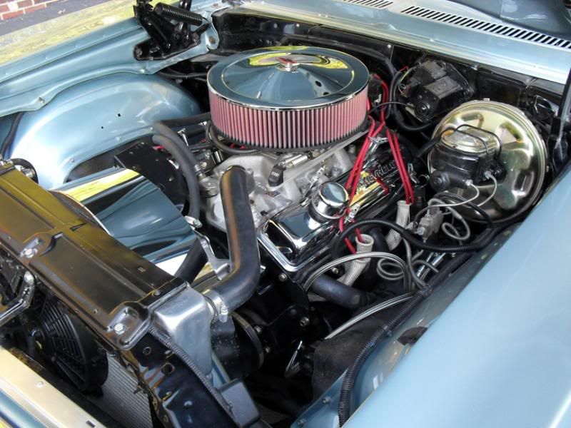

Hey everyone, my name is brandon and i come from pro-touring.com. Just doing some looking around, and getting some info for my build.
Long and short, bought a fully restored 72 nova, has a new 350 crate motor and t350 trans, all OE sheetmetal car, just a real good solid car top start with.
So Far i have installed the DSE Coilover conversion on the front end, DSE front sway bar. Tubular upper and lowers. DSE 3" Drop leafs out back, upgraded delrin bushings and Koni Rear Shocks.
Competition Engin' Frame connectors
Hotchkis rear sway bar
Waiting for my 6 piston Wilwood dynalites, and 4 piston Rears, drilled and slotted, billet master from prodigy customs.
Dynomatted interior
Magnaflow 3" exhaust off long tubes.
Ordering Bonspeed malibu's once brakes are on so i cna measure for fitment.
Pretty much just wanted to get the brakes and chassis where I want them for this year. After that, this summer Im going to pick up a ls2 and t56 and swap that out next winter with a Head and cam package.
Ill update the build as i go!
Onto the pics

did you do them all in one go.. or little by little.. and what yielded the biggest difference?
cool car btw
Jake: Hit it.
Old 12-29-2009, 09:06 AM
bgray bgray is offline
Join Date: Oct 2009
Posts: 9
I have done it all at once. So i cant really say how much of a difference it made. Only thing i did and drove on was the DSE front setup, at factory ride height. It was definetly VERY tight, but rode better then the urethane and new coil springs the previous owner had in.
