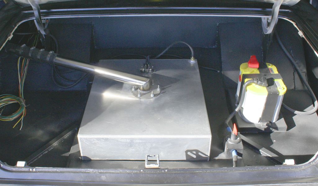

My car is a nova but hey, cars are cars right Anyway, I am still in the stages of making my pump(s) panel that will hold the valves also. That is going in between the wheel wells in the trunk. The tank (5gal) will go on the left side of the trunk. I have a battery on the right side. And a subwoofer will go on the vertical panel just behind the pumps. The amps will go on the passengers side of that vertical panel. I dont have any rear seats, the 4-link ate them so I figure I might as well use it for stereo components. JR
Here is a pic of the trunk pre-air ride. I will have more to follow. I have been wiring up the pumps and valve block lately, looking pretty good. I didnt like the rats nest of wiring that comes off the valve block. So I removed the wires from the connectors with a tool and cleaned the look up some.

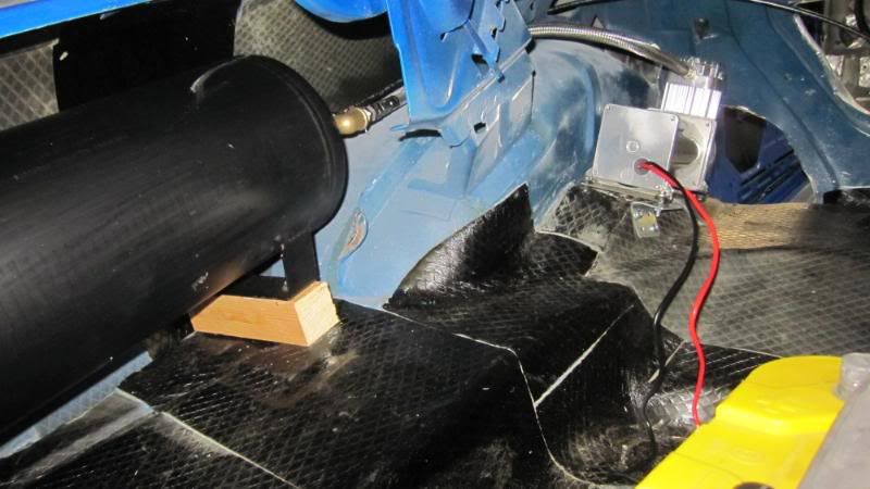

Here is what I did.
