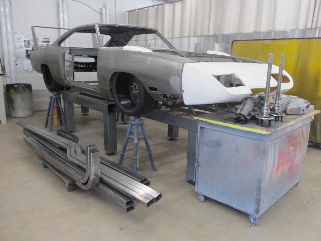

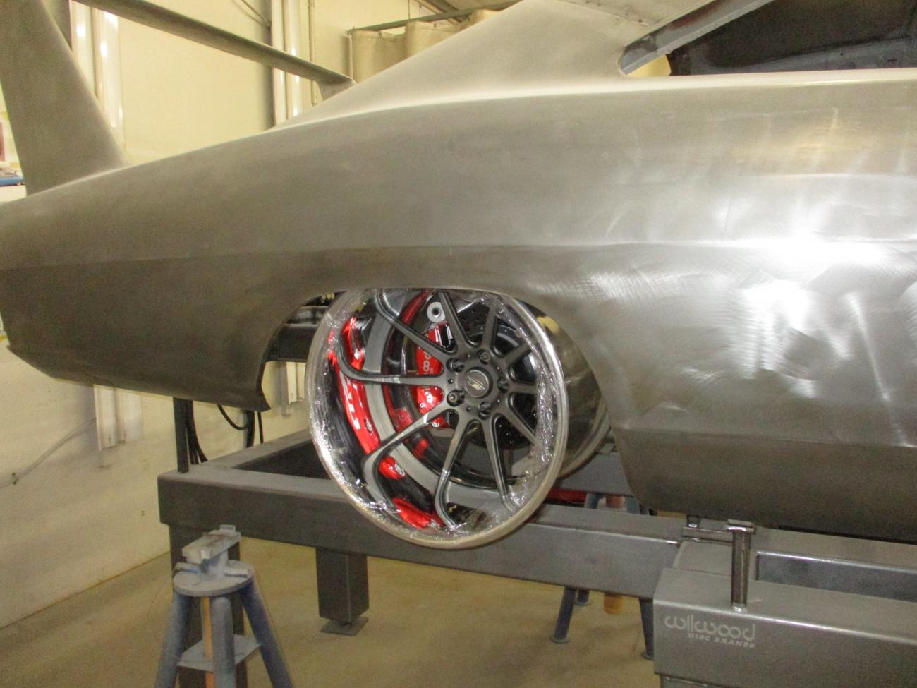

Its Been a While i Have an Earlier build post of my Car while it was being built at Holohans hot rod Shop. Since June we Parted ways and the Car is Now Being built by Bob Thrash and Mike Dumas at Platinum Custom cars in Manteeno Illinois. I will say im very Excited more has been done in 5 months then in 4 years at the other shop. it is expected to be sitting on the ground in Metal at the Chicago world of Wheels and Then Goodguy's Nashville and Columbus this year Here is Project Envious. Be sure to like Platinum's Facebook page for updates they work amazingly fast. https://www.facebook.com/14521170553...37510706307399

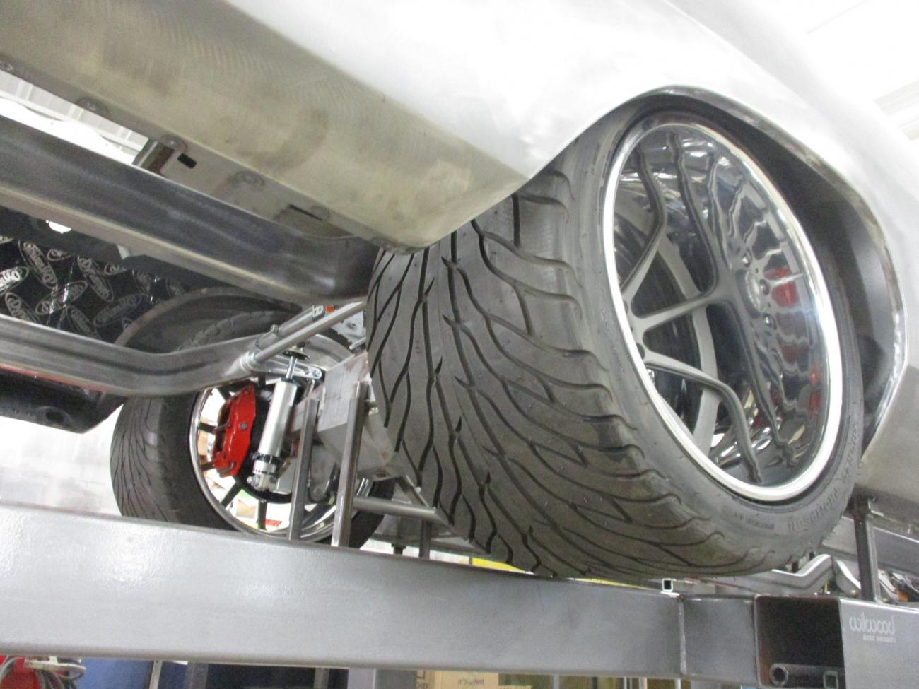

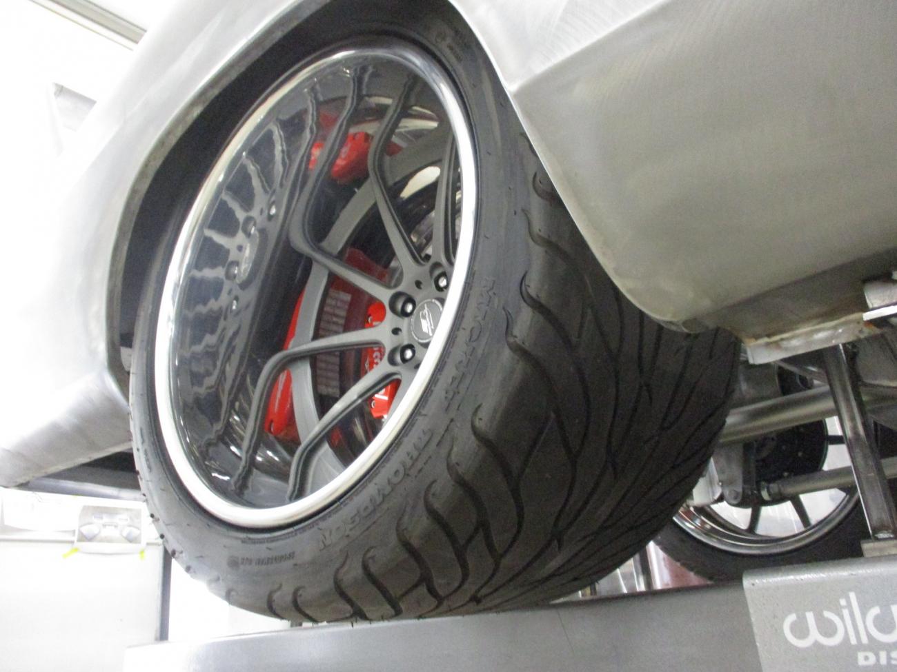

How wide are those wheels?!

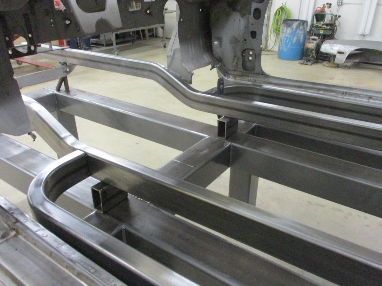

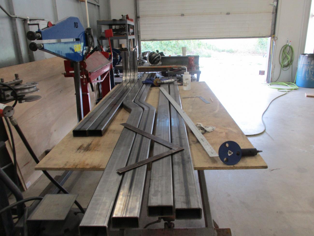

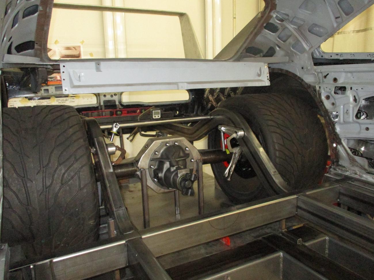

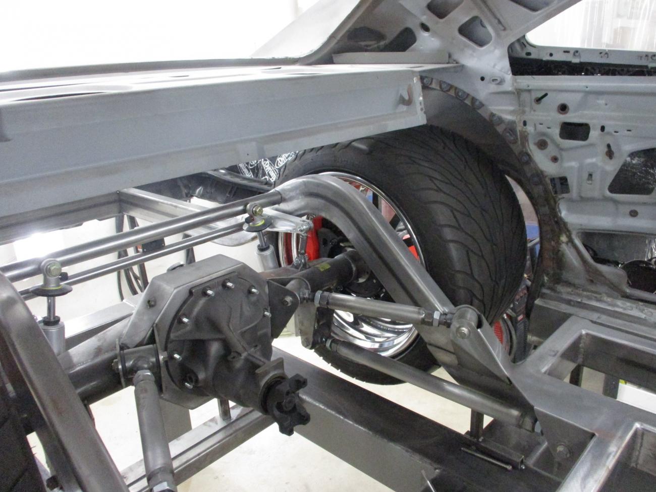

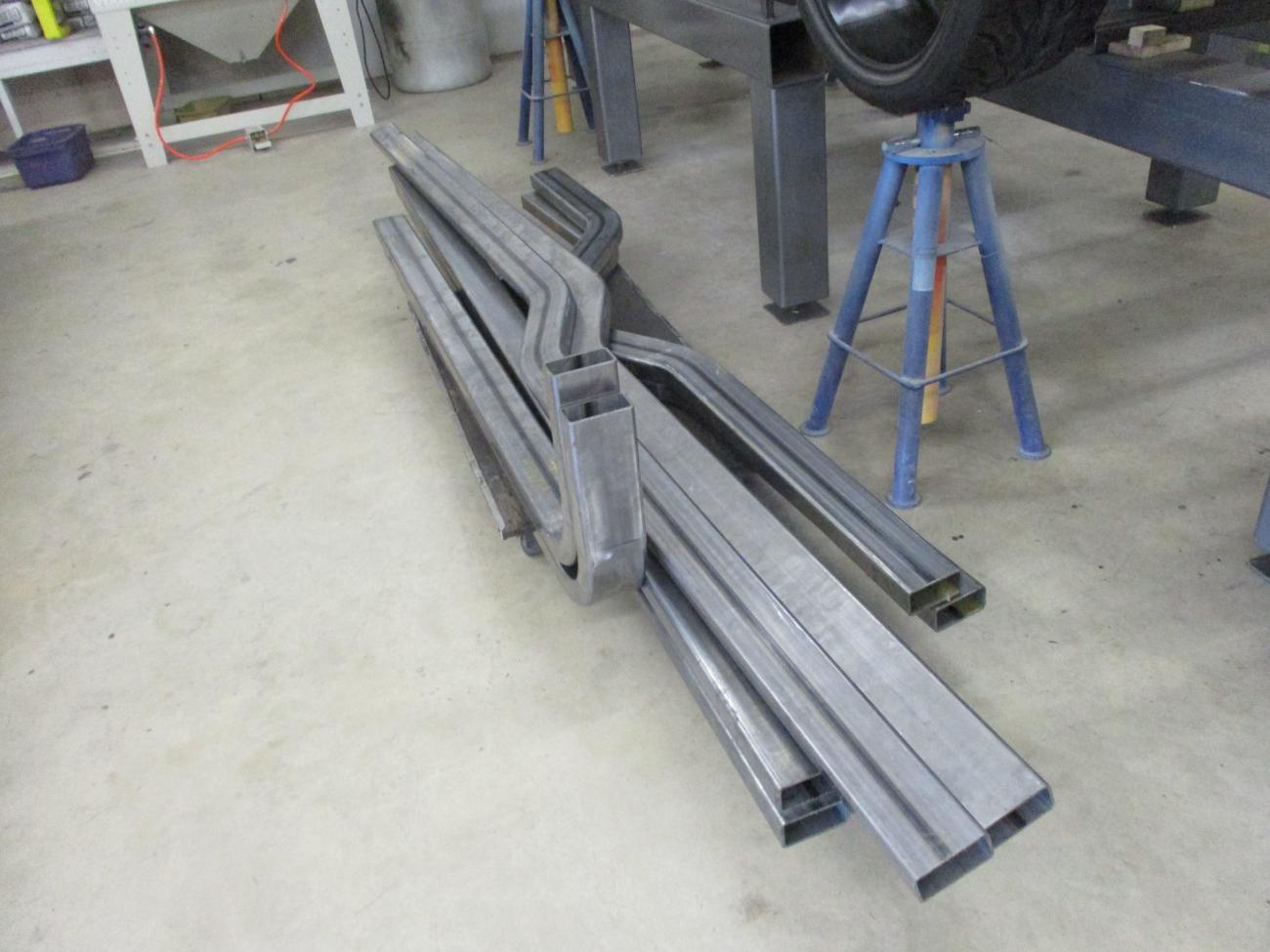

This is a super awesome project! Did they get the rails bent from Art Morrison and then buy the front suspension as a kit from somewhere else?

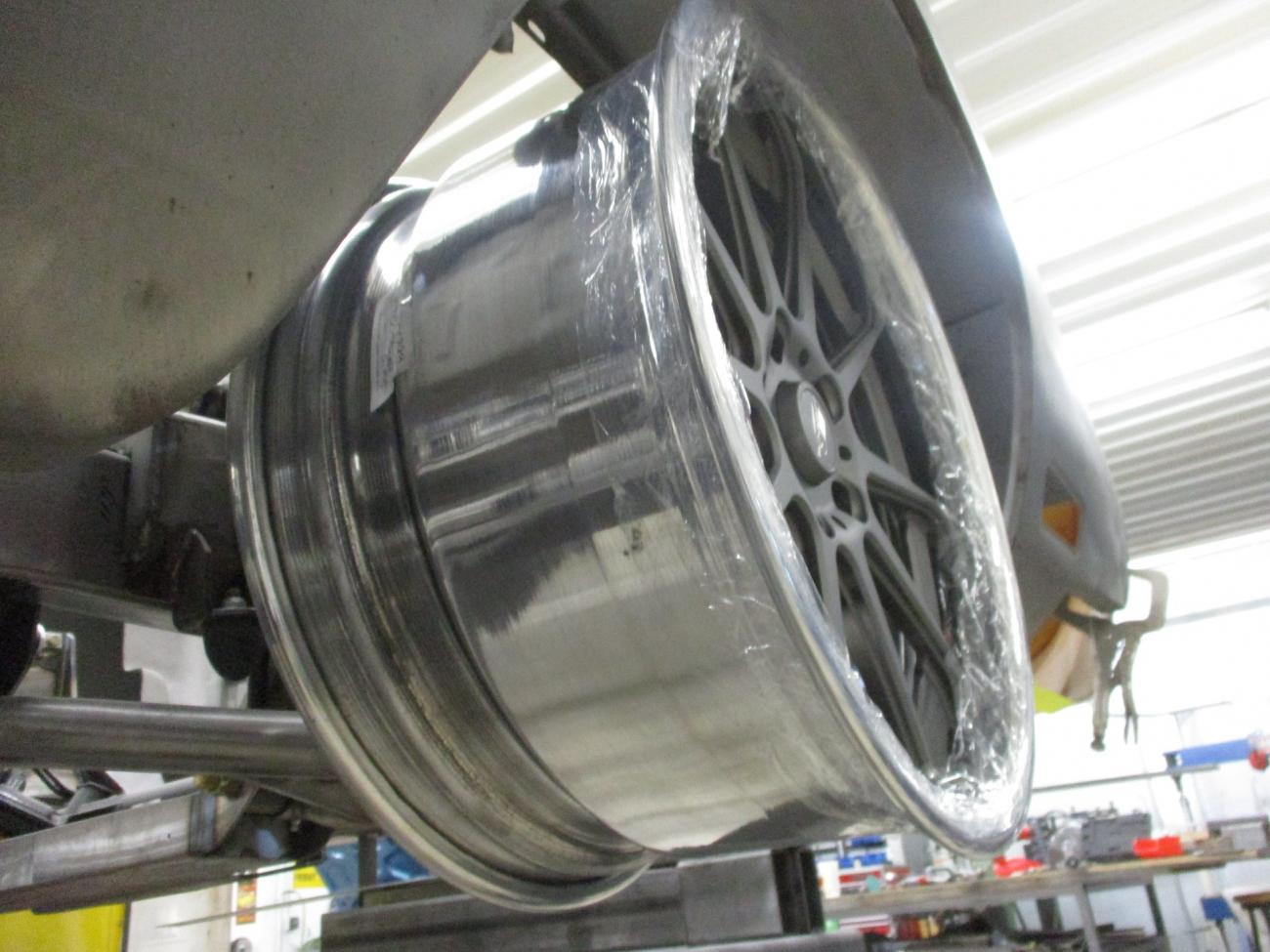

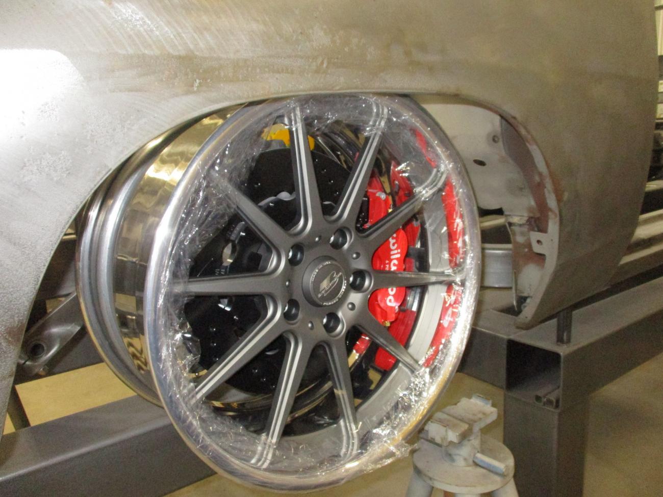

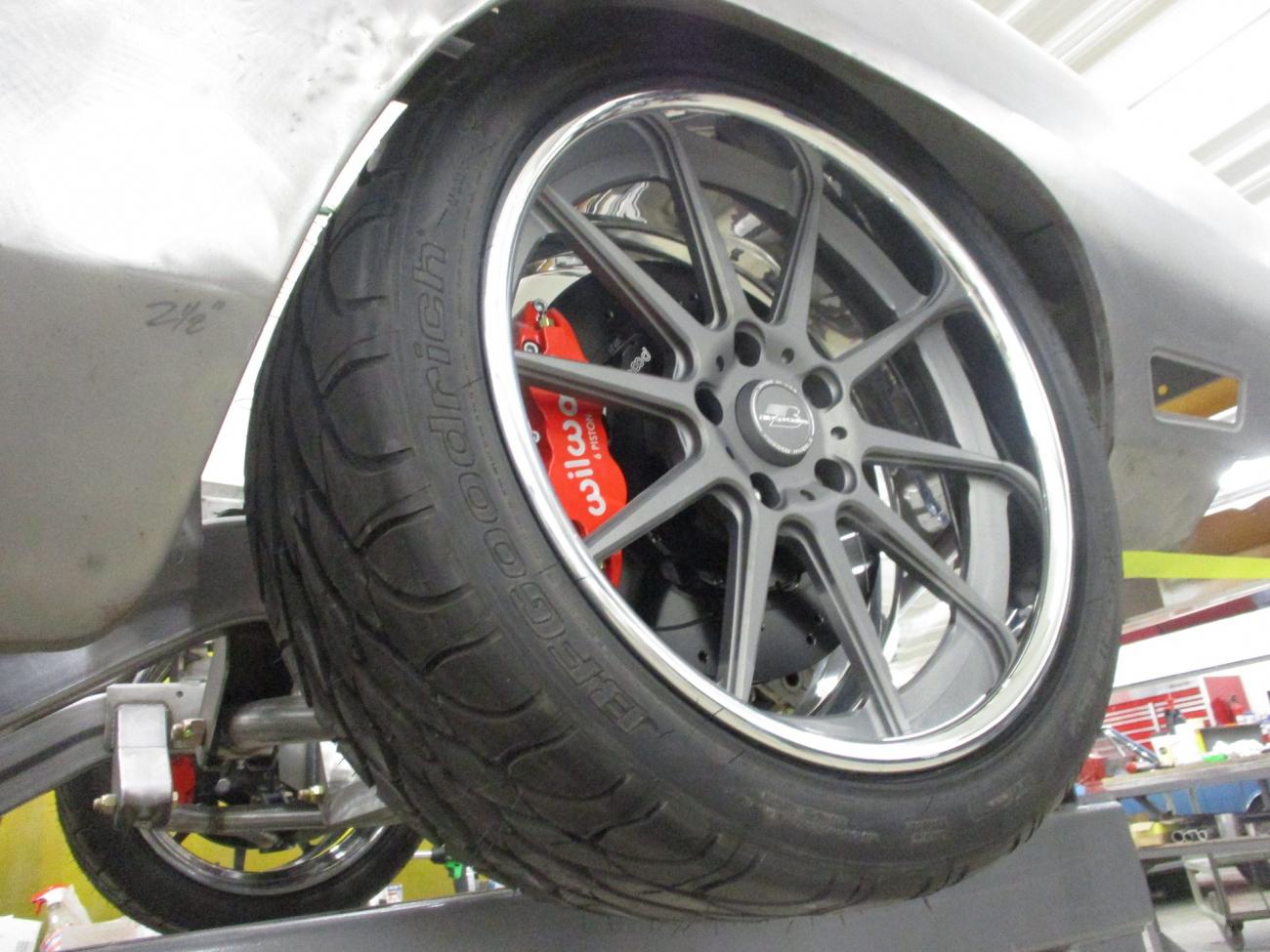

Yes Bob Measured the Rails and drew out exact diagrams of the bends then had art Morrison Make the Rails I had already purchased the IFs from the roadster shop when they were available he did a Fantastic Job it looks amazing. The wheels are 15" wide. Dan Holohan is a Great guy but we all know how Builds go if i said he Over sold and under delivered he would say he overworked and was underpaid we will leave it at that. i will tell you im Extremely impressed and overjoyed with the work being performed at Platinum custom cars they continue to impress like cpd004 stated on time and exactly what they sold you

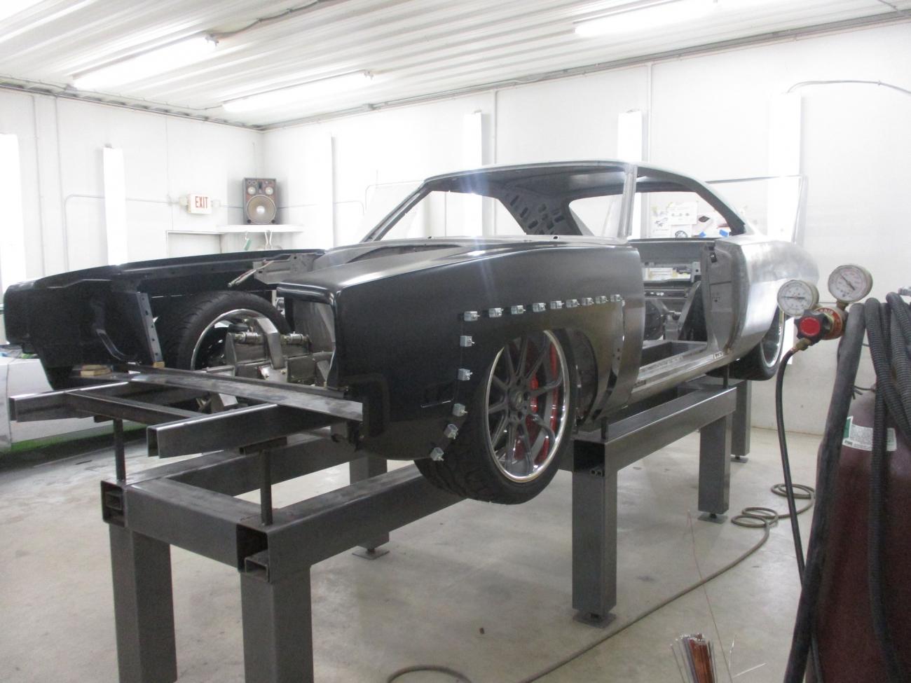

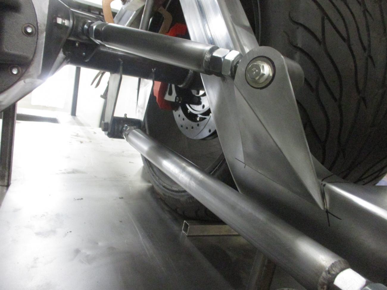

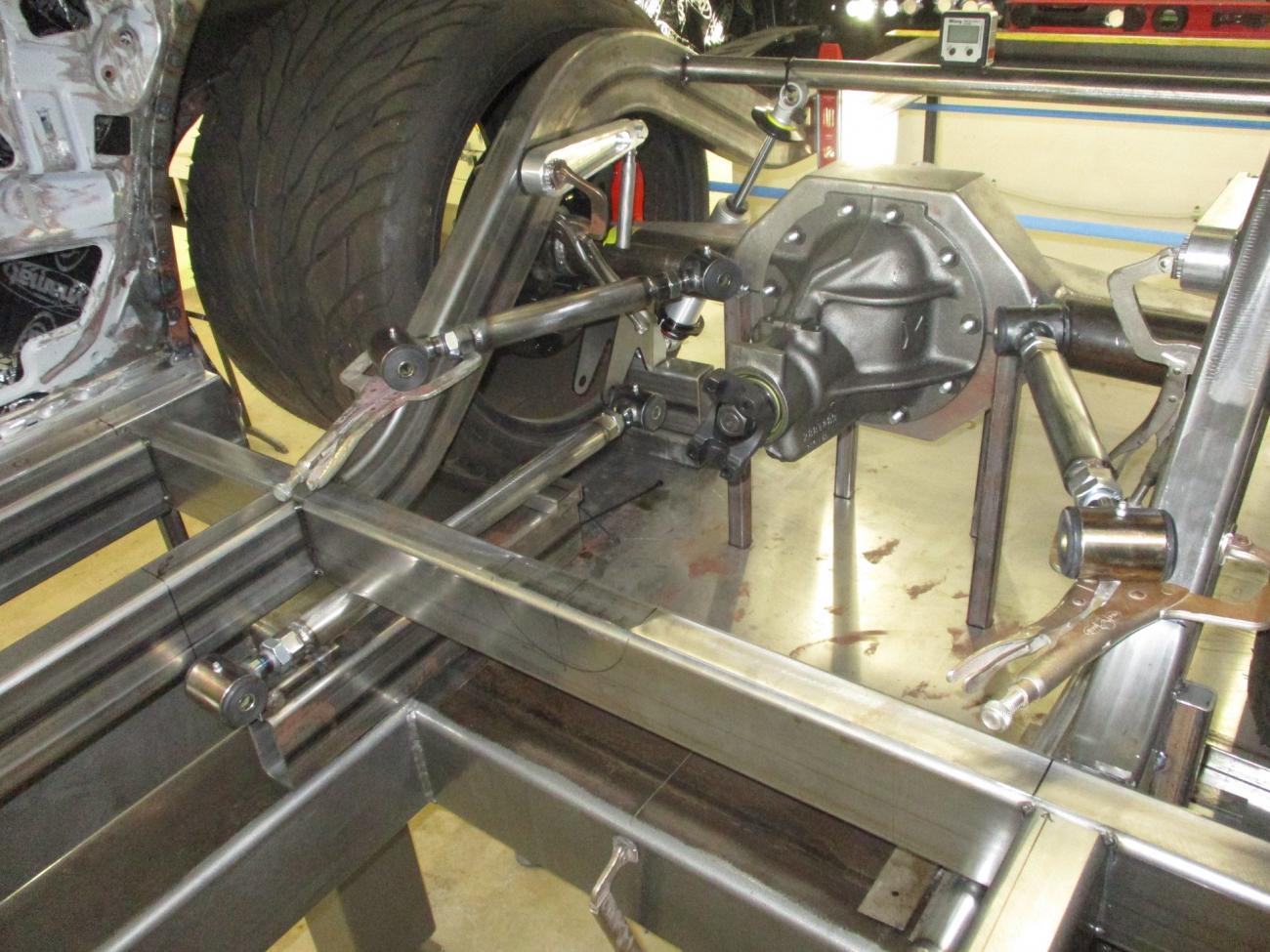

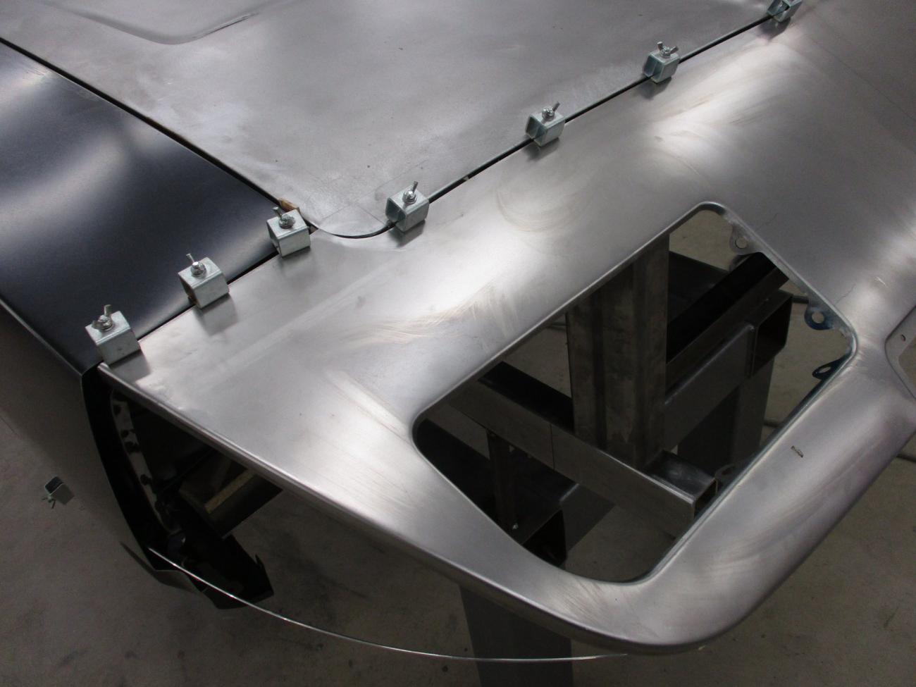

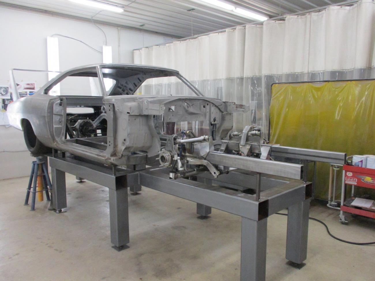

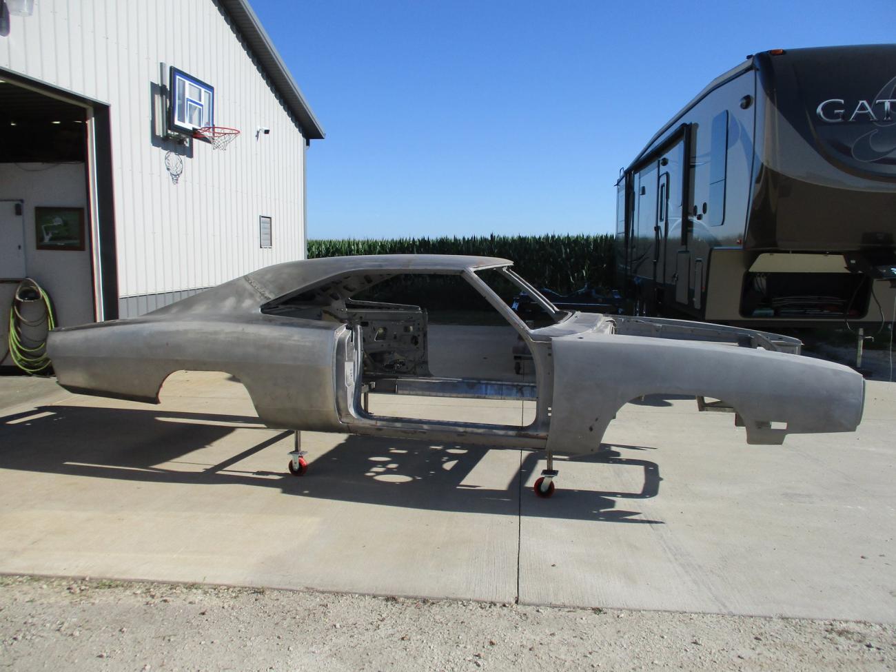

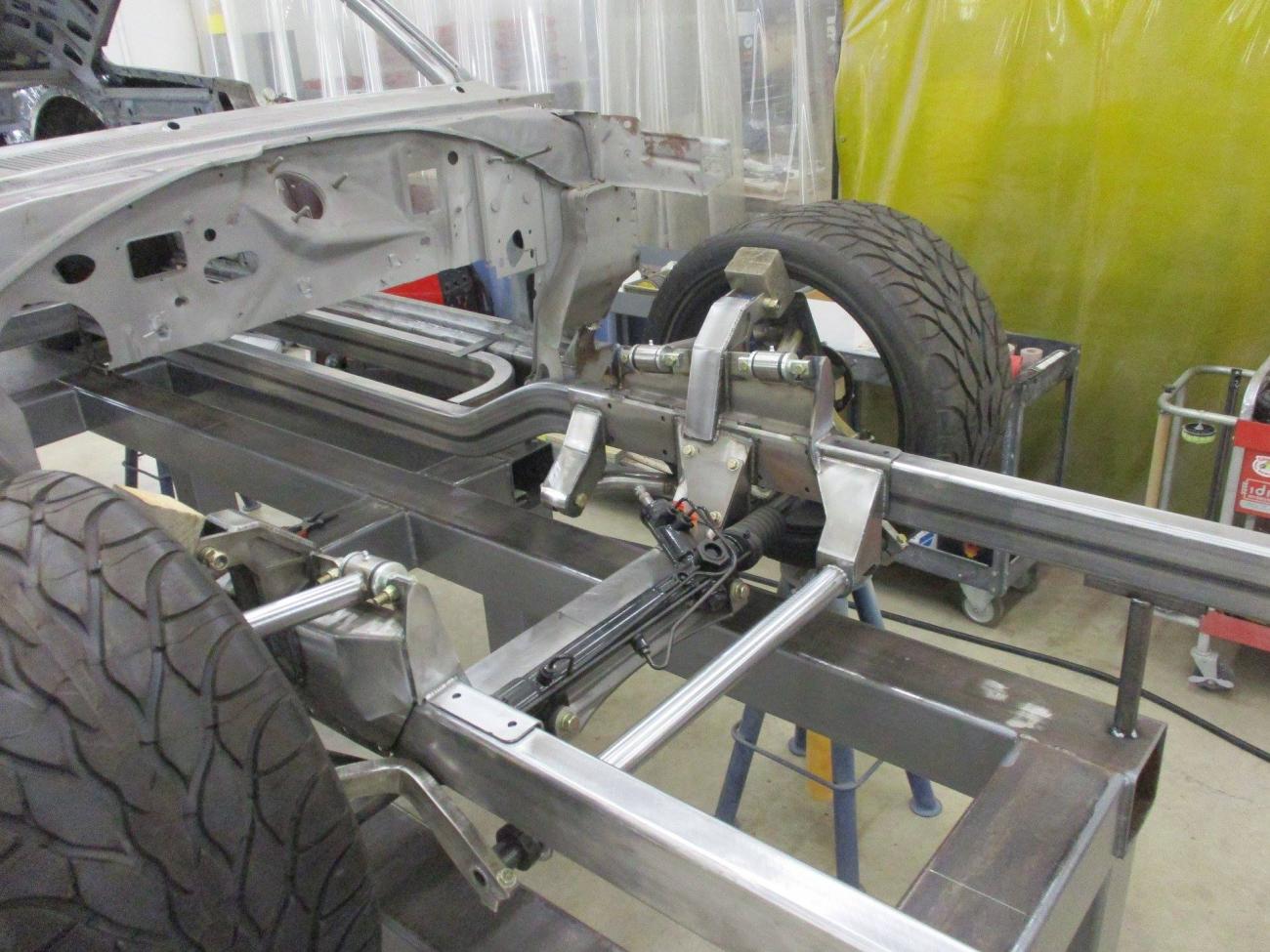

some more build pics

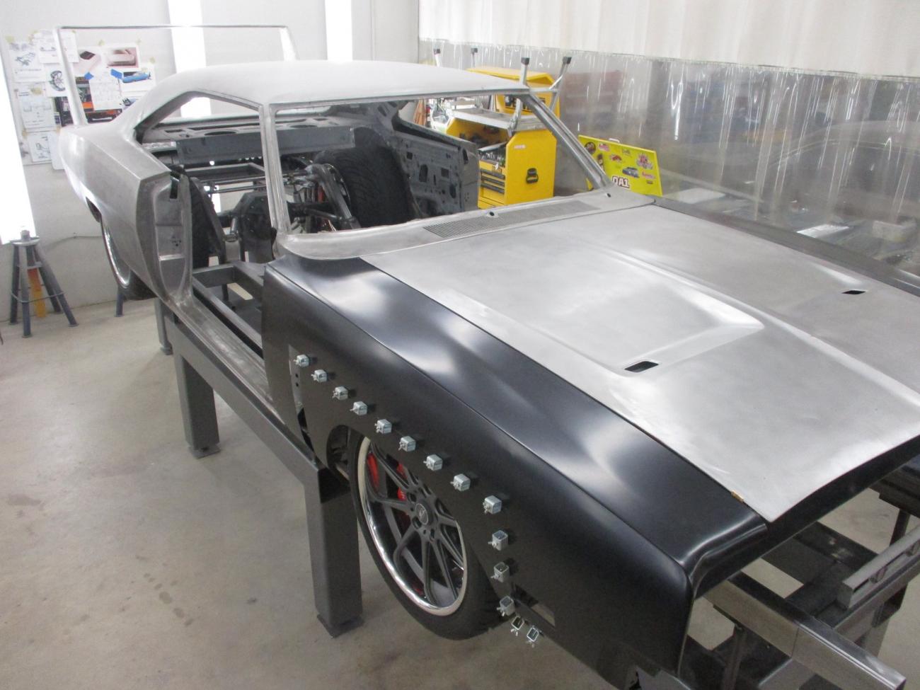

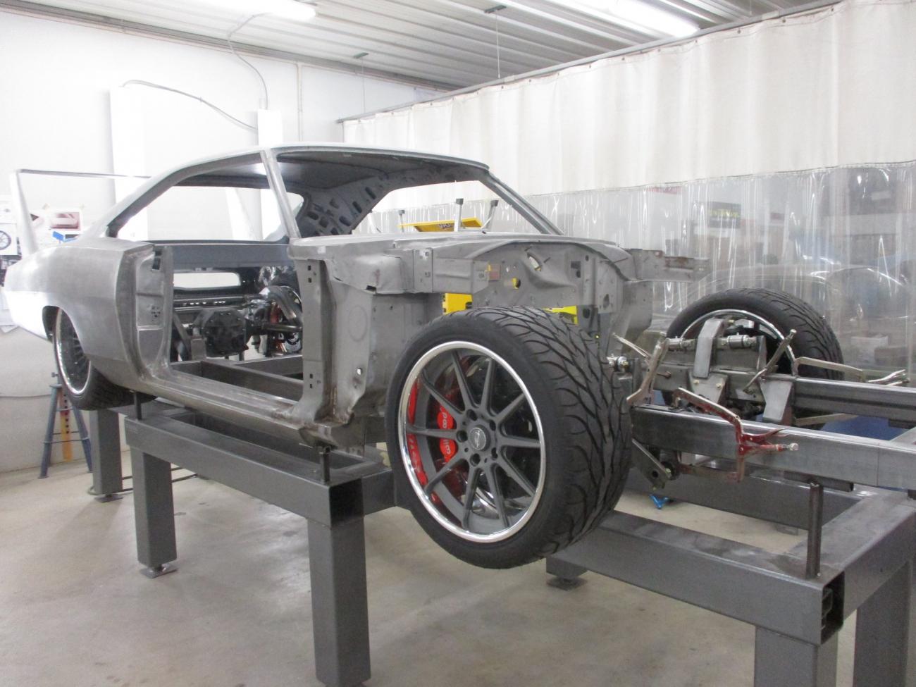

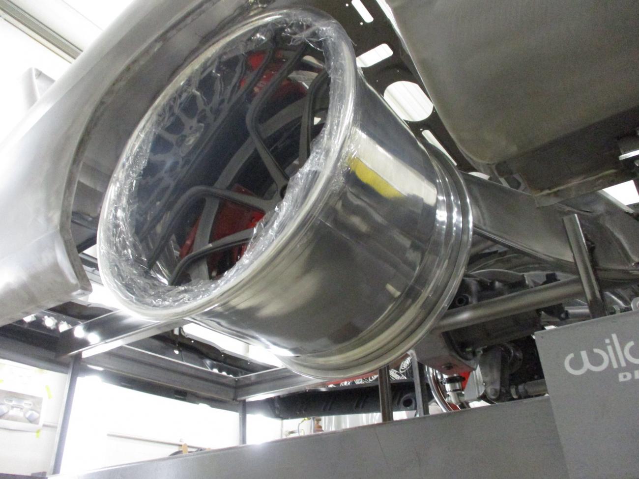

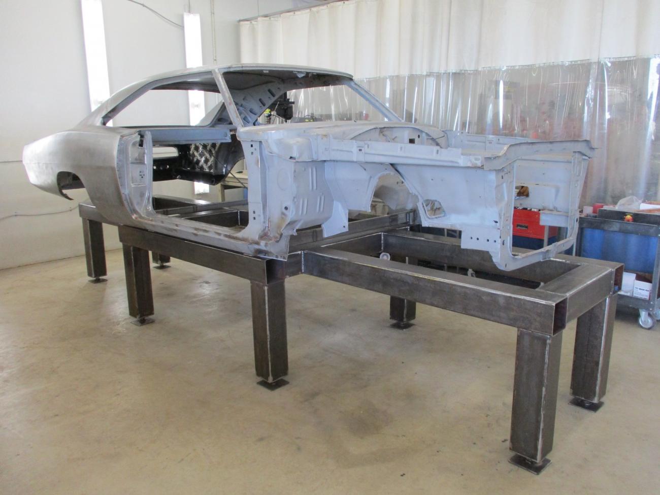

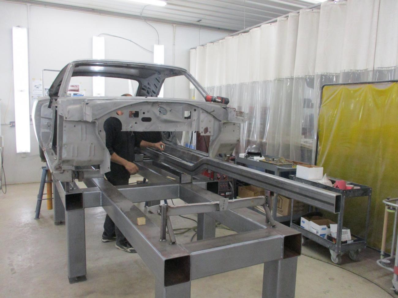

Some More build pics

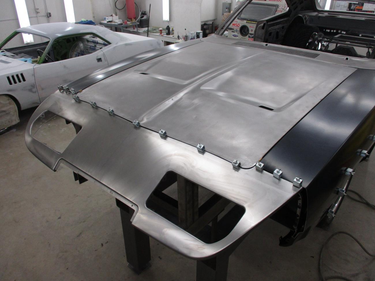

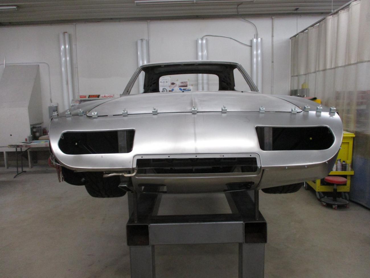

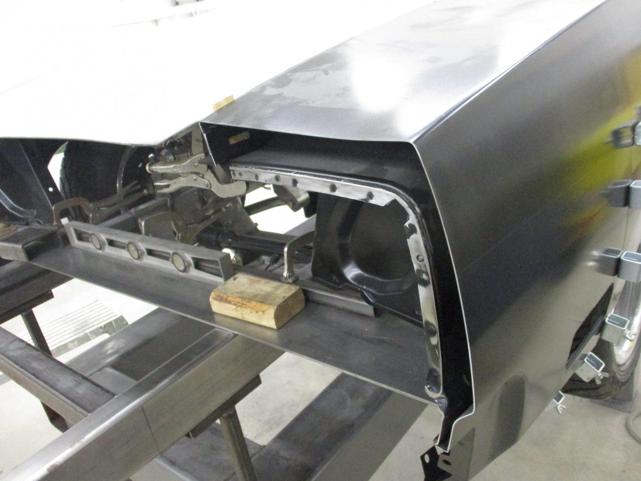

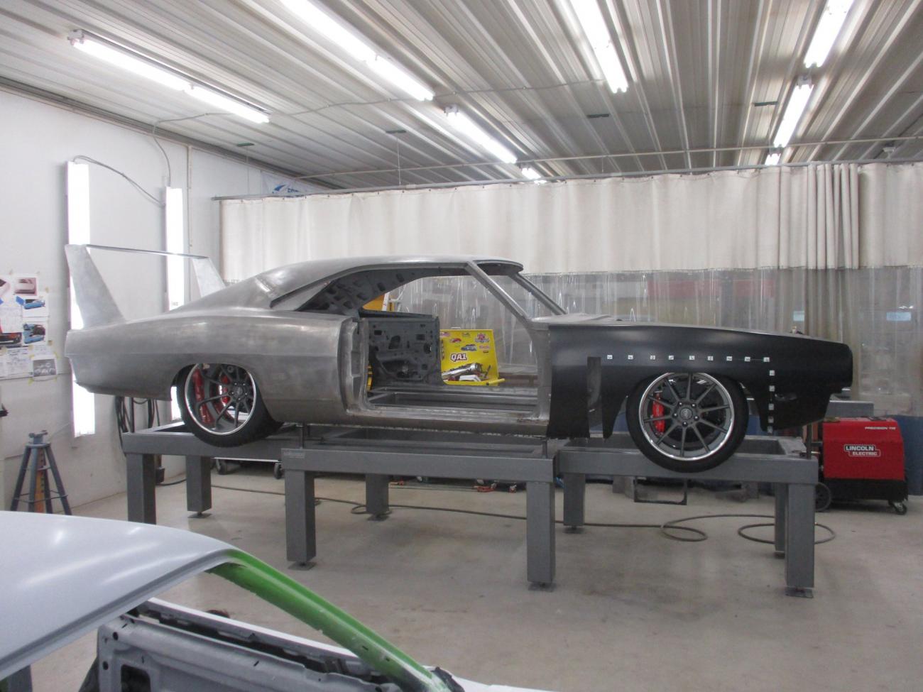

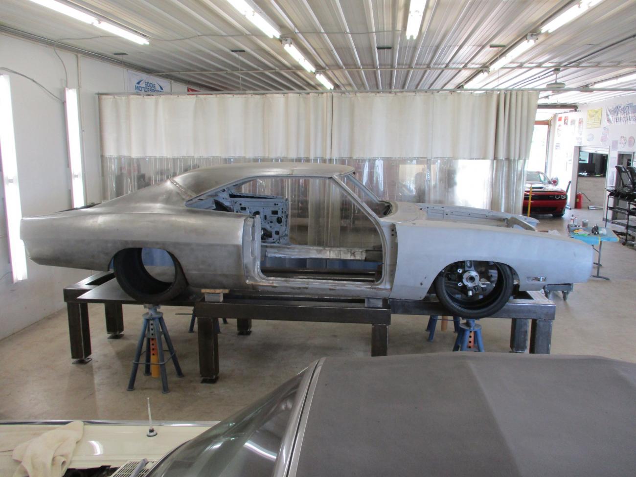

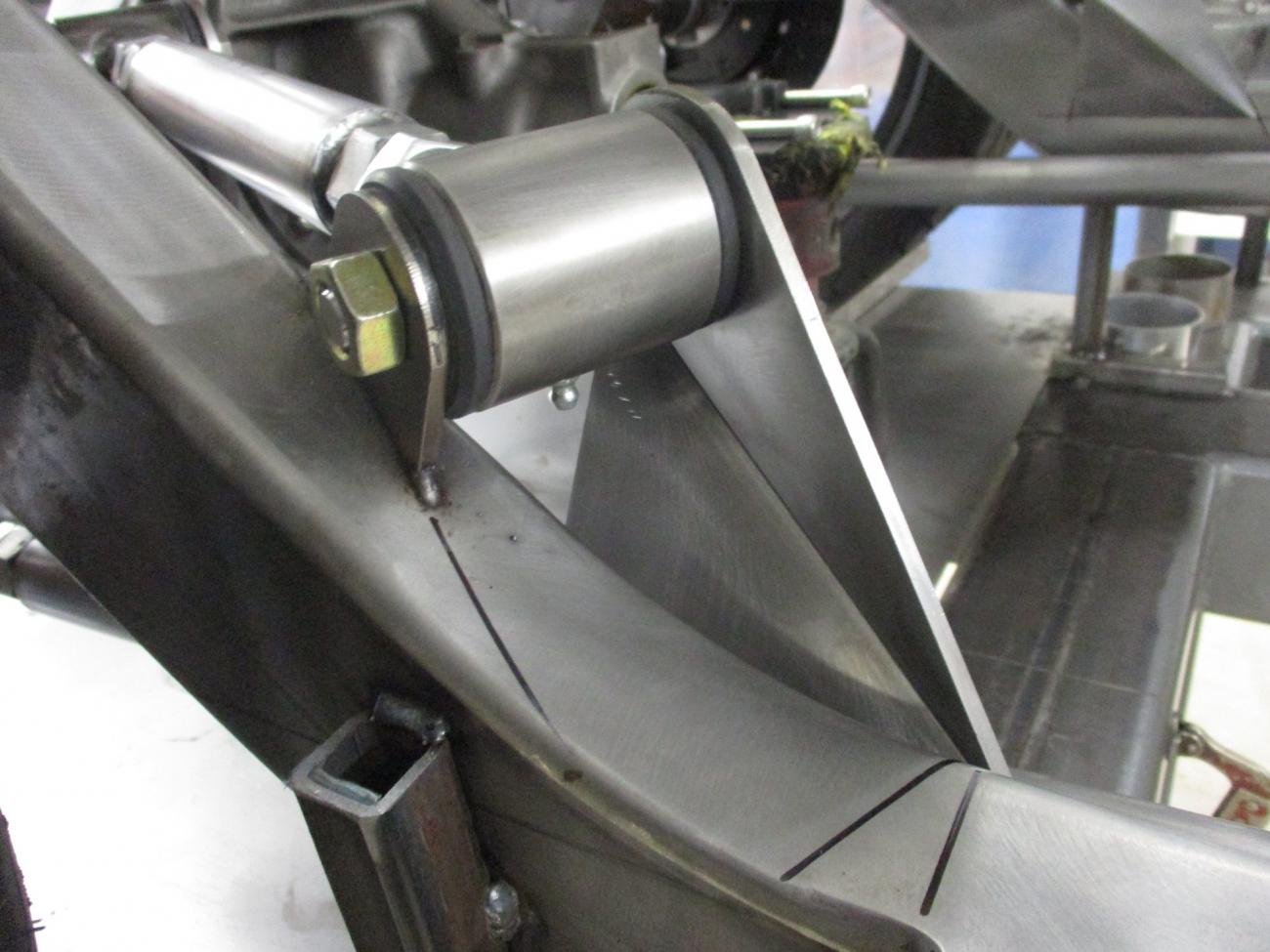

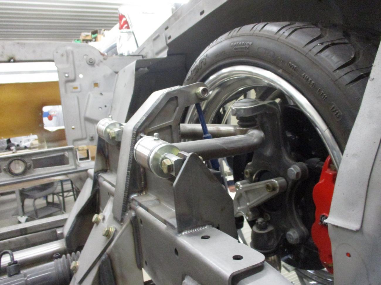

Default Protouring Daytona

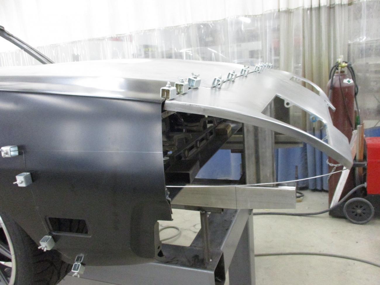

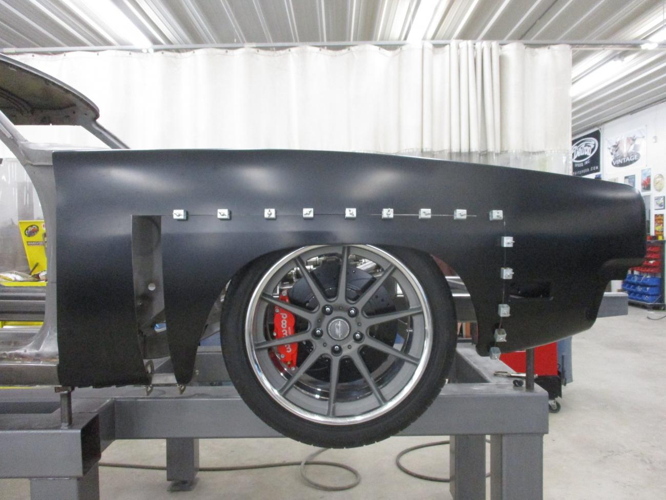

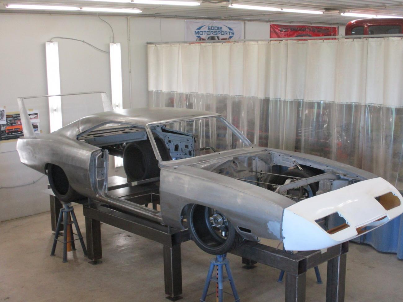

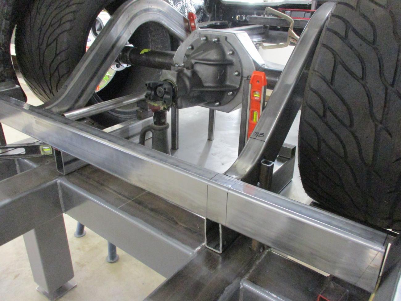

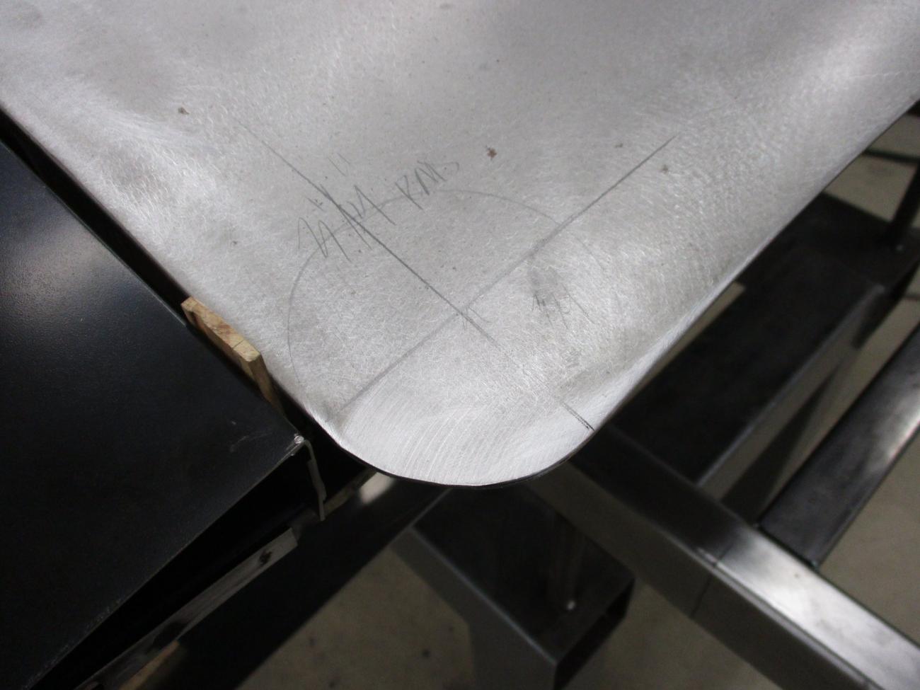

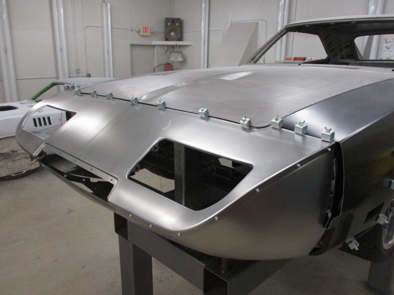

In these pics We decided that the wheel base was to short for the length of the overhang So Bob extended the wheel base from 117 to 120" and in these pics he sectioned the front fenders for the move forward then brought back the new steel nose cone a tad to even out the proportions.
